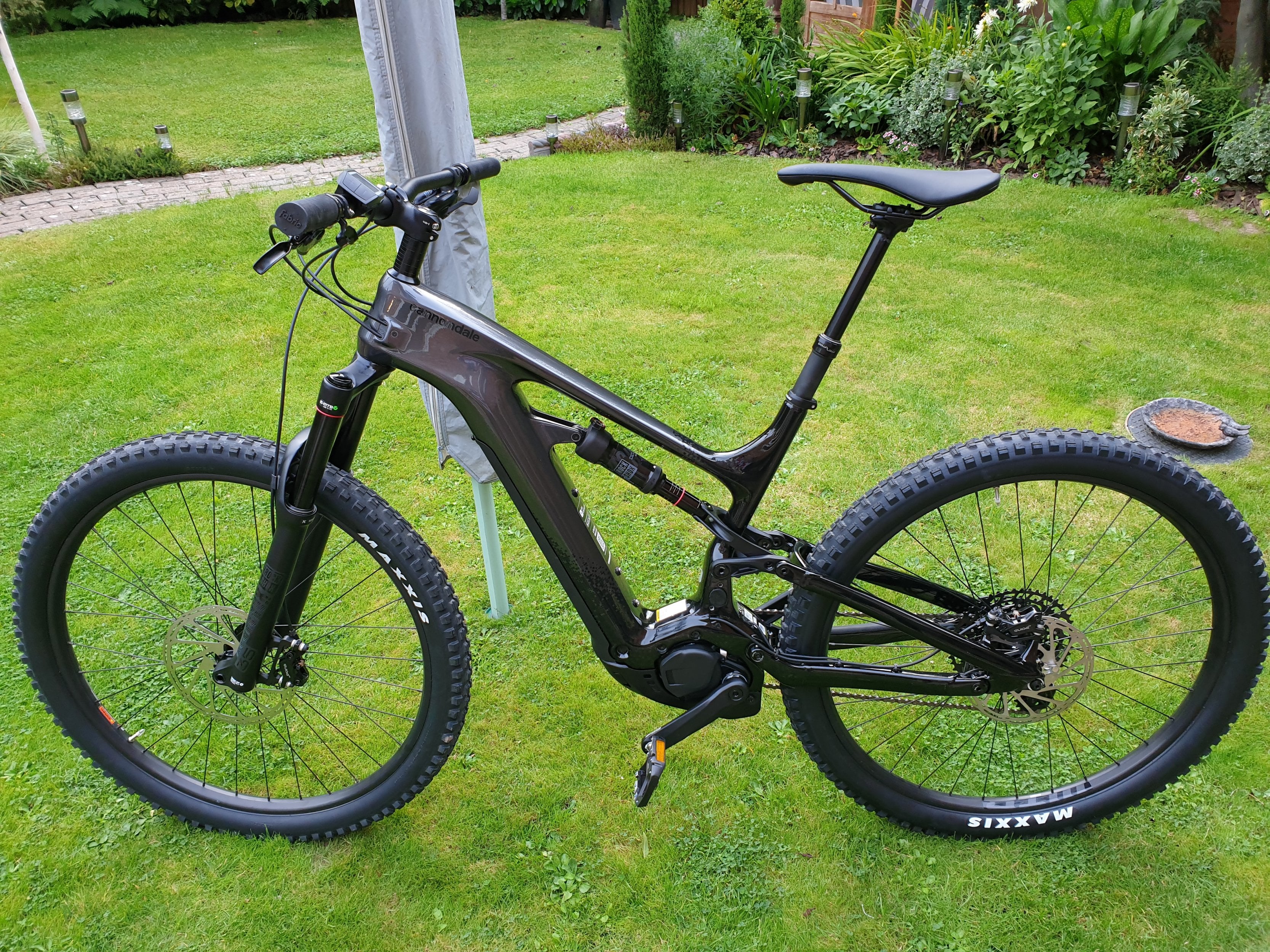

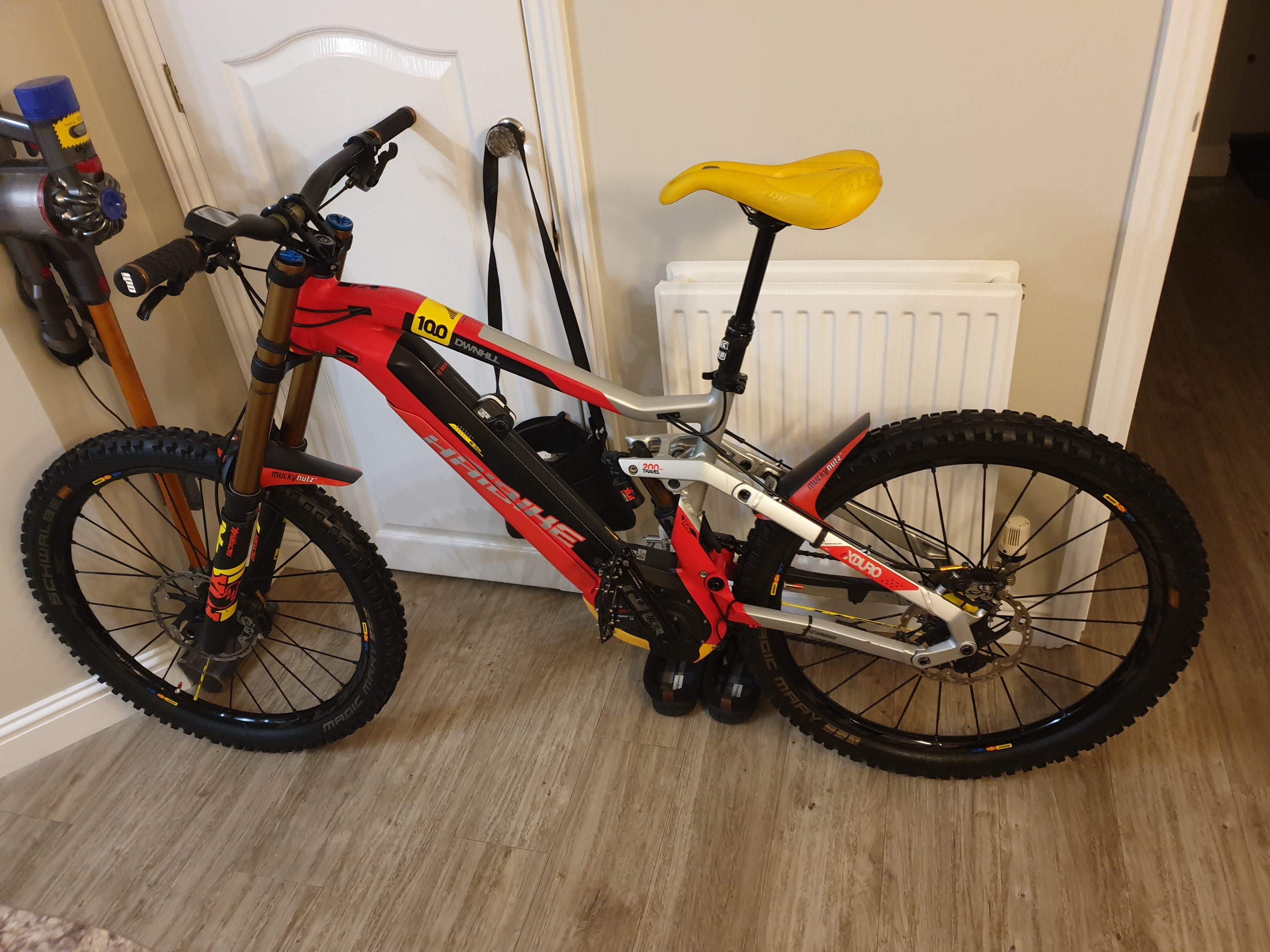

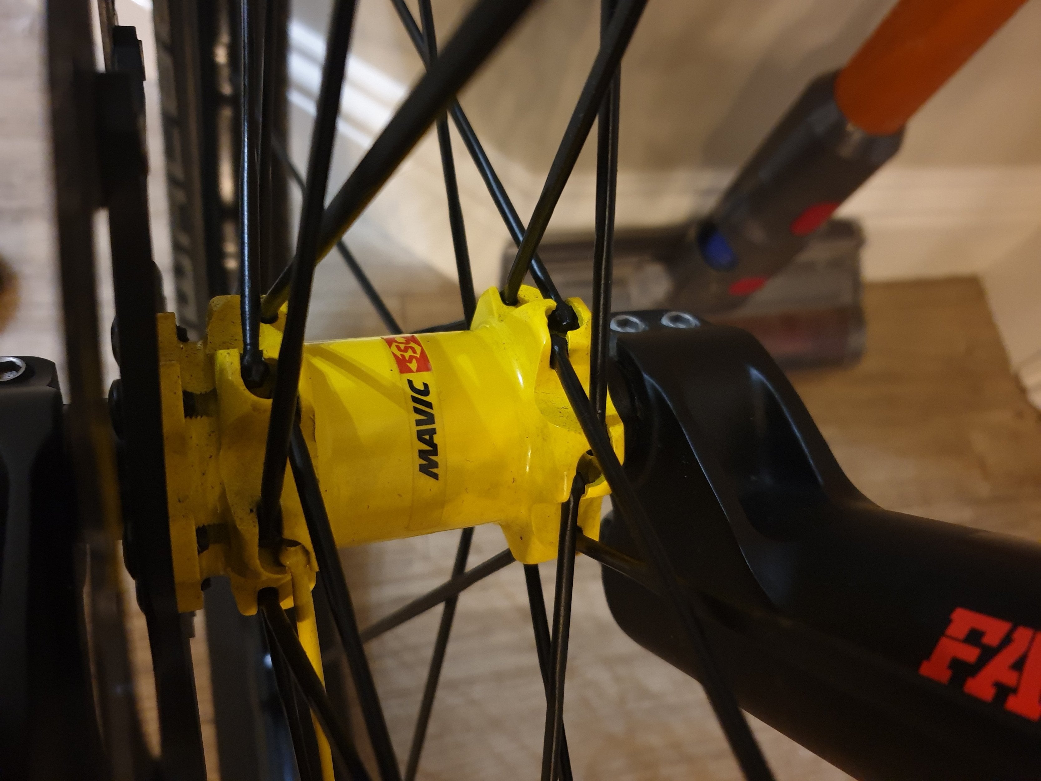

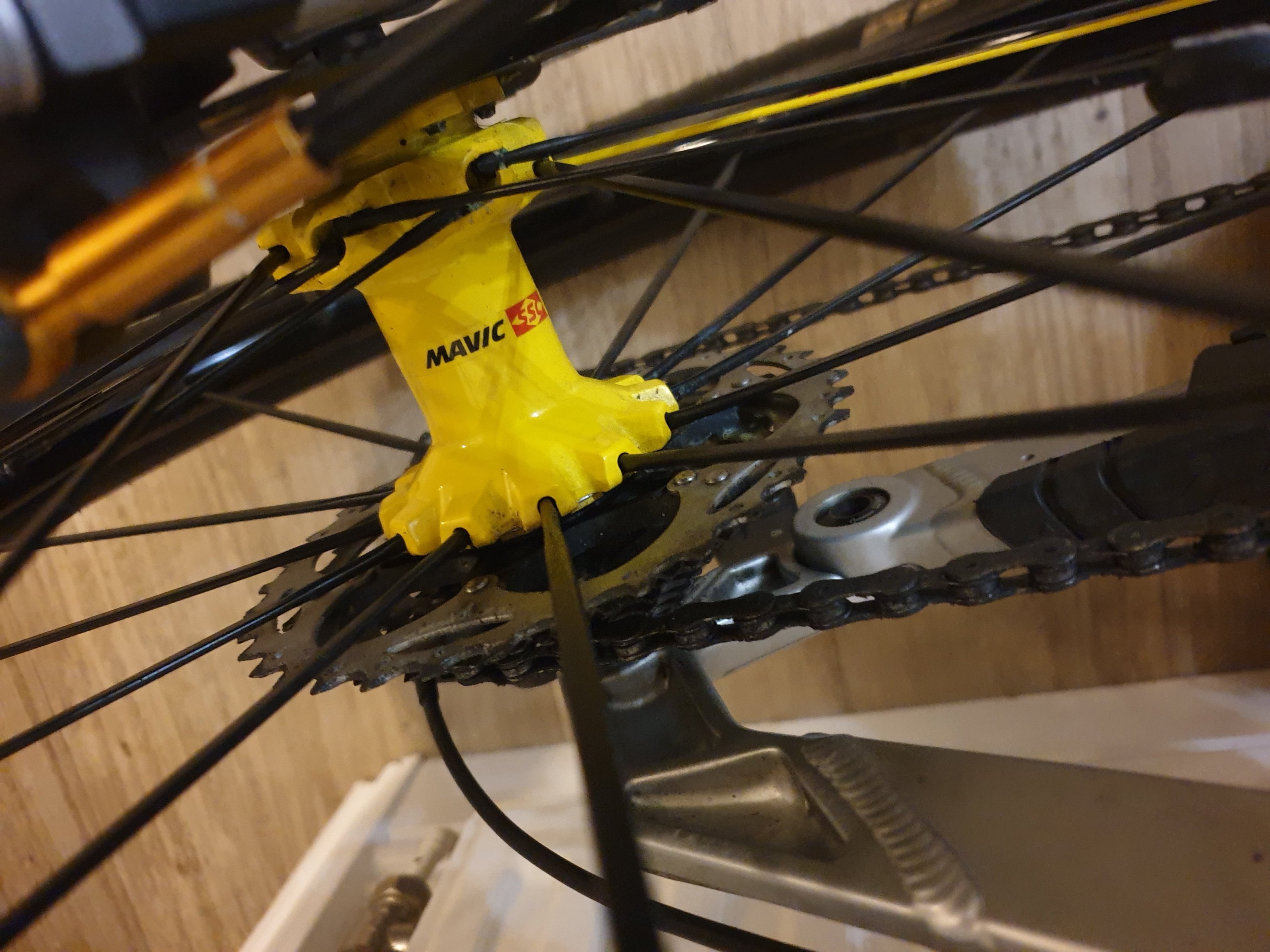

I have Mavic carbon rims on my Hiabike Xduro 10 downhill bike, they were fitted with tubless, but I struck a rock on a knarly decent and it caused a leak through the carbon which I couldnt fix so had to fit a tube. On the aluminim rims on my other bike they just take a bit of a dent but the wheels keep going so I would put to you. If your doing a lot of uphill fell typoe riding and want to save weight, and day long trails then its probably worth it, however if you ride for around 11/2 to 2 hours like I do on knarly trails with lots of lose rocks and do some downhill then stick with aluminum due to the durability. I would swap my wheels around between my bikes but the Cannondale is 29" on both and the Hiabike is 27.5 on both.
20220115_230552.jpg 20220115_230830.jpg 20220115_230841.jpg Cannondale Moterra III.jpg
