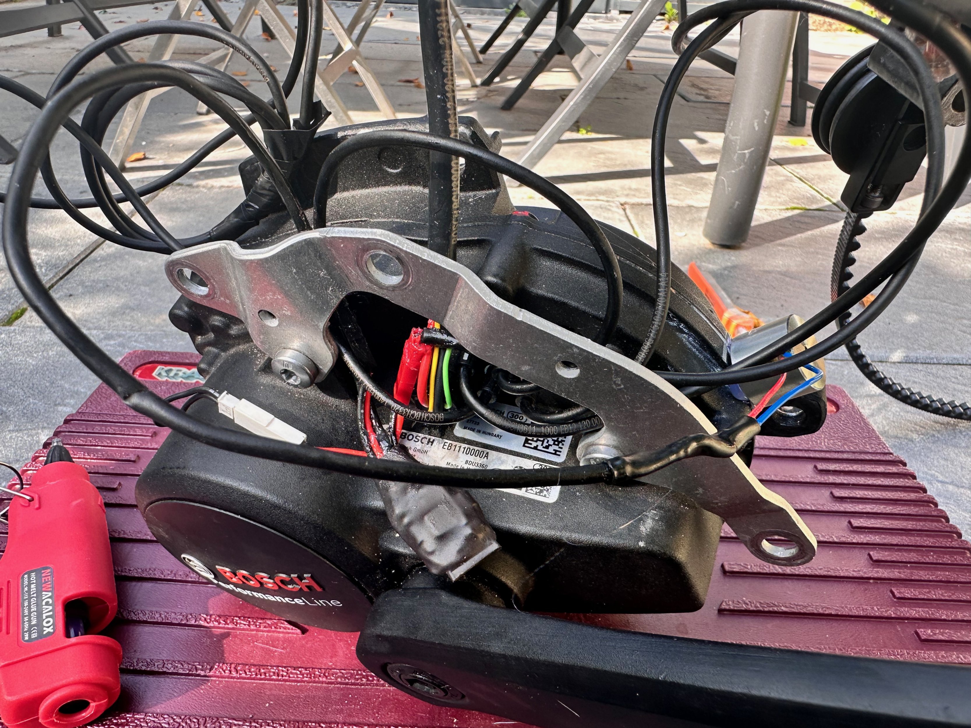

Update:
I have changed the electromagnet and positioned it back on the motor. Positioning is a lot easier with a smaller diameter coil. Again, I was able to determine the detection range of the hall sensor, positioned the electromagnet nicely in the middle. I got a perfectly stable speed for a kilometers while in setup mode. Thereafter, I went out of set-up mode, spin my wheel and also got a good speed read.
Mounted the motor back on my bike, cycled a few hundred meters with my phone off before I got the sensor error again :(. I have tried cycling at a low speed (<25k/h - so below the legal limit) and at a faster speed (>28km/h - above the legal limit). Both result in the error within a few hundred meters. I have no clue anymore why the system is not working as intended.

Update:

Update:

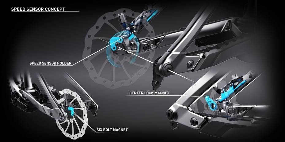

Im from the netherlands, you think i can use it on my bike? The magnet is on the breakdisk CUBE STEREO HYBRID 140 HPC TM 750 FLAS/OLI 2023 S - CUBE Stores Nederland
@Patcho, yes it should work. You have a regular speed sensor (no rim sensor).
See first post from megabobra:

According to megabobra, you should position the elektromagnet against the speed sensor. So you have to:
- Move the current speedsensor somewhere close to the motor or lengthen the cable of the elektromagnet so you can please the speedsensor wherever you want.
- Place the sensor of the Megabobra on the place of the original speedsensor (so it can register the revolutions of your wheel).
- Place the elektromagnet against the original speed sensor.
