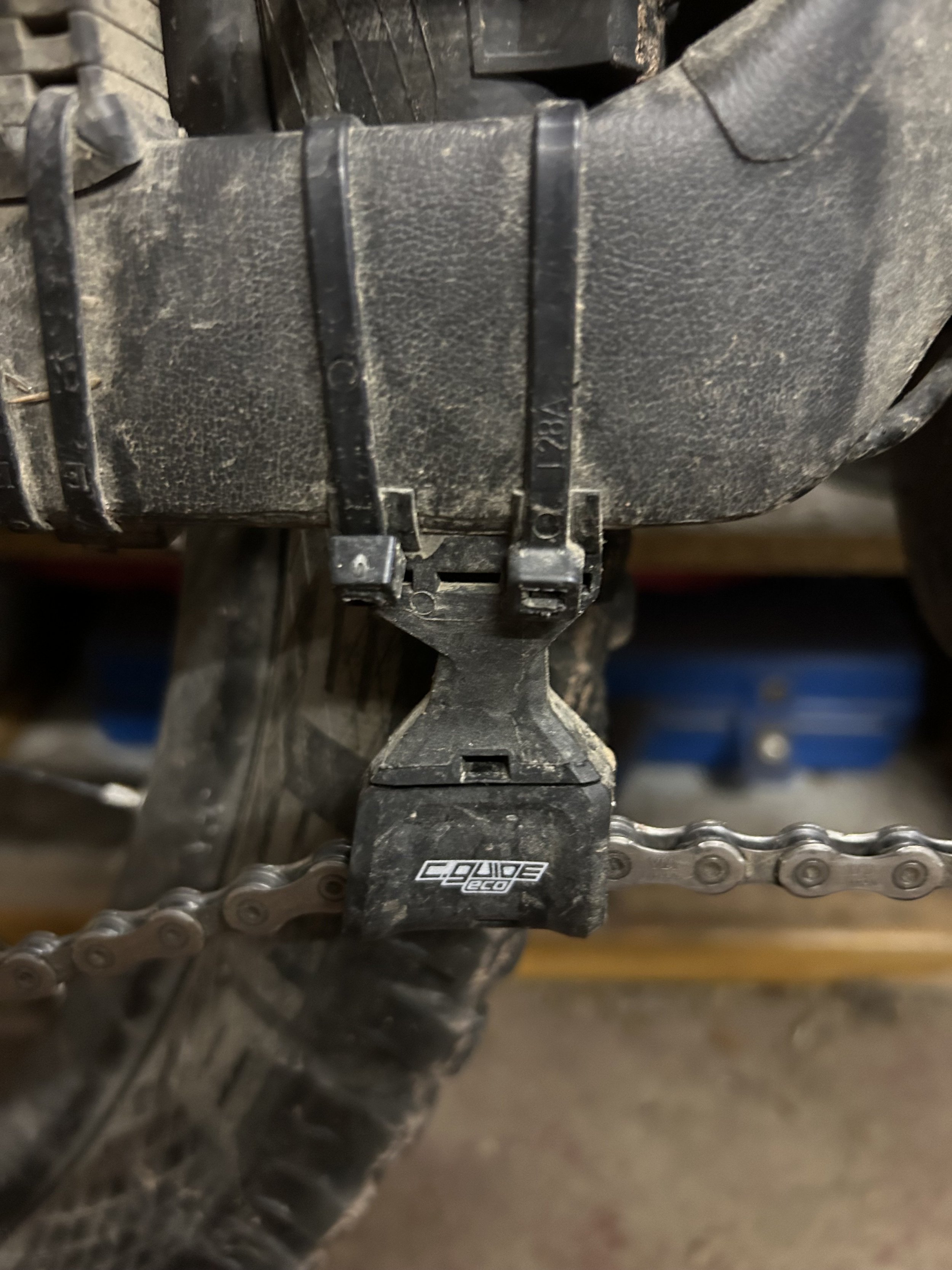

I observed the same with my M510 on the E10. I think it’s the sprague bearing (one way clutch) that has some play. Running downhill, the chain slap working against the sprague bearing is causing that rattling noise. I use this simple chain tensioner device, significantly improving the noise level.

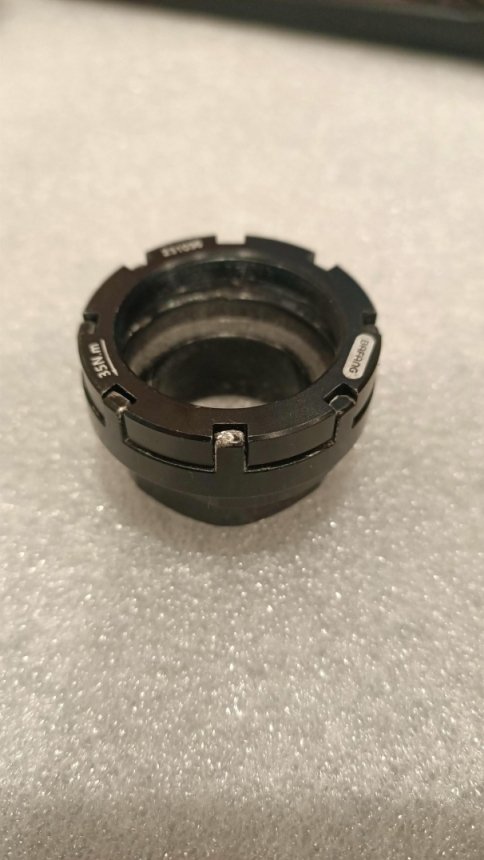

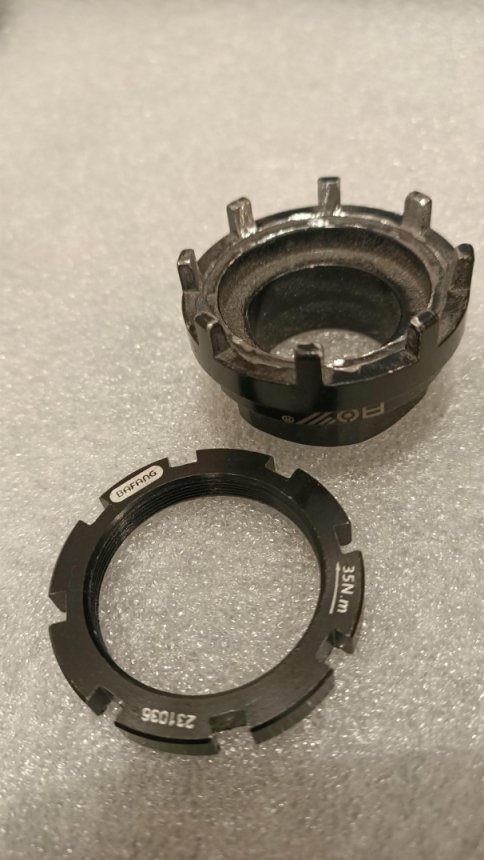

I also spent half a day filing down a chainring lockring tool I got from AliEx. The teeth spacing and width was spot on, but the diameter was out of spec. too small. I had to file the inside of each tooth to allow it to fit over the lockring.

I had exactly the same issue with Unior ISIS BB tool. Is it possible, that bafang lock ring has different nominal dimension than standard ISIS?
I decided to file down the lock ring, because it is made from aluminum, and my tool is from carbon steel. It is significantly harder. Even filing down the lock ring took longer than I anticipated. Hope I didn't weaken it too much.

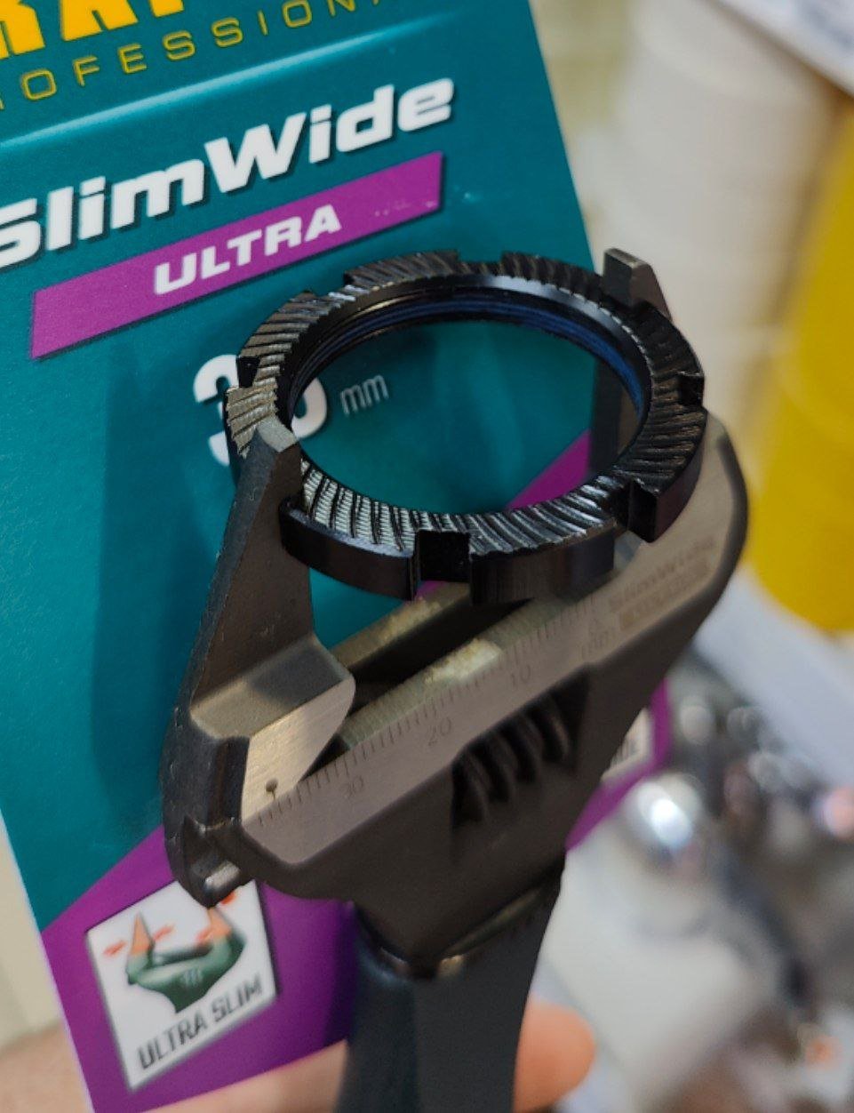

Hi! im waiting for the same one from AliExpress) but for the first time I used pliers with thin sponges )
