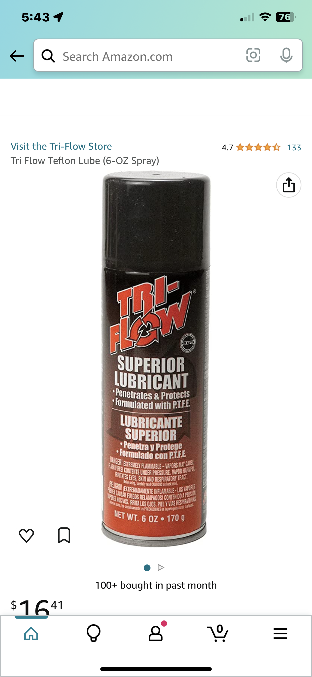

Sorry for all your grief,. Sounds like a lemon to me. Tip for the pivot creak. My first Trek dealer replaced the upper and lower bearings when the bike was only 6 months old with maybe 500 miles on it. Within a month creaking came back but faintly. I took it to an actual Trek company store and they re-torqued the bolts and sprayed the joints with Triflow. This Teflon based lubricant has been around a long time. No more creaks! Available on Amazon…. I prefer the spray rather than the bottle as it penetrates deeper.
Funny you mention this stuff. When I got my first creak on the new bike, I hit every single joint with a Torque Wrench and this tri-flow, but I used the squeeze bottle instead of the spray. Sad to say it did not solve my issue.
