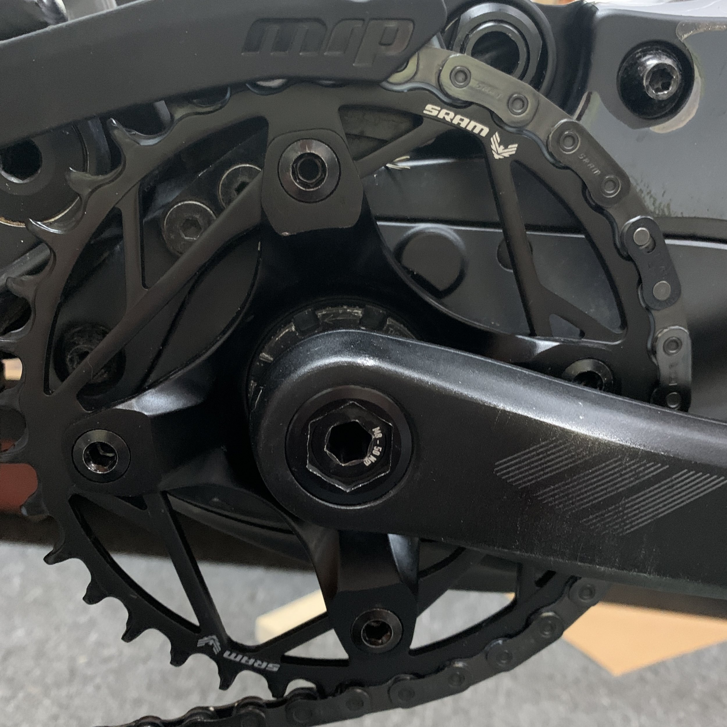

Would you mind posting pictures of your Reign E+ with the new Transmission ?
Sure. Here you go

lol I thought the same, and while you can remove the Praxis chainring without removing the chainring nut, you cannot replace it with the SRAM AXS chainring. The reason is that there is more material toward that centre of the SRAM ring and as such there's not enough room to loop the ring around the back of the spider (like you can with the original Praixs chainring). I tried everything to get it to loop round the back, it was close, but just couldn't make it fit. In the end I removed the spider and sorted it that way.
Here's an image to show what I mean (first image Praxis, second is the SRAM)
You can get the crank arms that are used on the Bosch. They are ISIS compatible and I spoke to SRAM directly about that. However, the cranks for the e-bike version are not that special looking and so I just stuck with the Praxis (for now) and saved about £160 (UK) as a result.
View attachment 110699 View attachment 110700
Thanks that explains it and as far as the cranks that was my thinking stock should do just fine for me.
