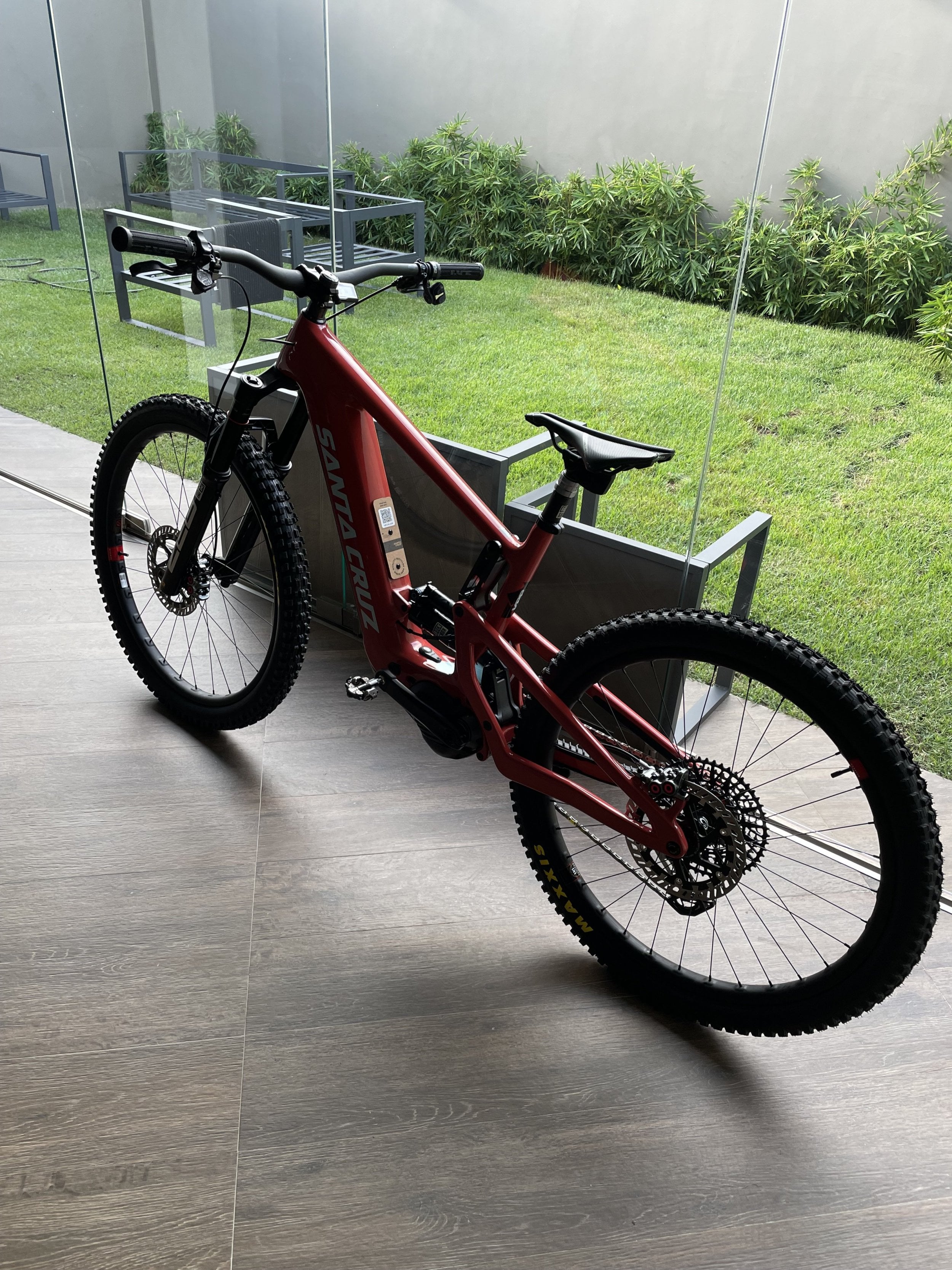

Whoa! I like the sideyard, bae.

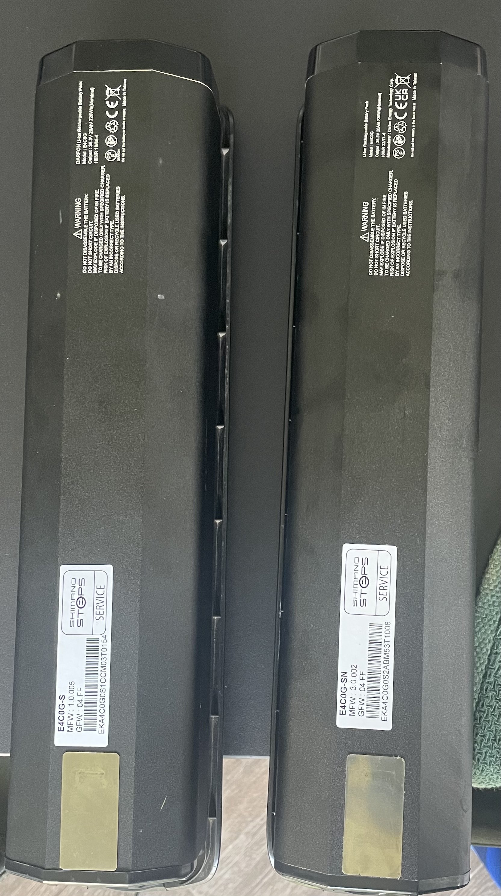

I think BikeRider is spot on with it sound like an issue with the Shimano motor and the Darfon battery.
In theory the EP801 will only work with "gen2" battery system batteries (with some exceptions - the Orbea Rise's seem to be working for example with third party batteries).
I think the original Darfon 726wh battery was the E4C0G (3.8kg/397.6mm). The newer one is the E4C0M (4.1kg 410mm).
No idea which one they're using in this bike. Could be the older one on some and newer on others ?
Presumably as this isn't happening to everyone, maybe it was working and there was an EP801 firmware update which now means it's not working ? ... or well, a million other things !
Hello, yes, that's correct. The previous model's Darfon battery fits perfectly in my SC, but it doesn't power it on because they have different firmware. In the picture, you can see that the battery on the left is for the EP8 motor and the right is for the EP801.
