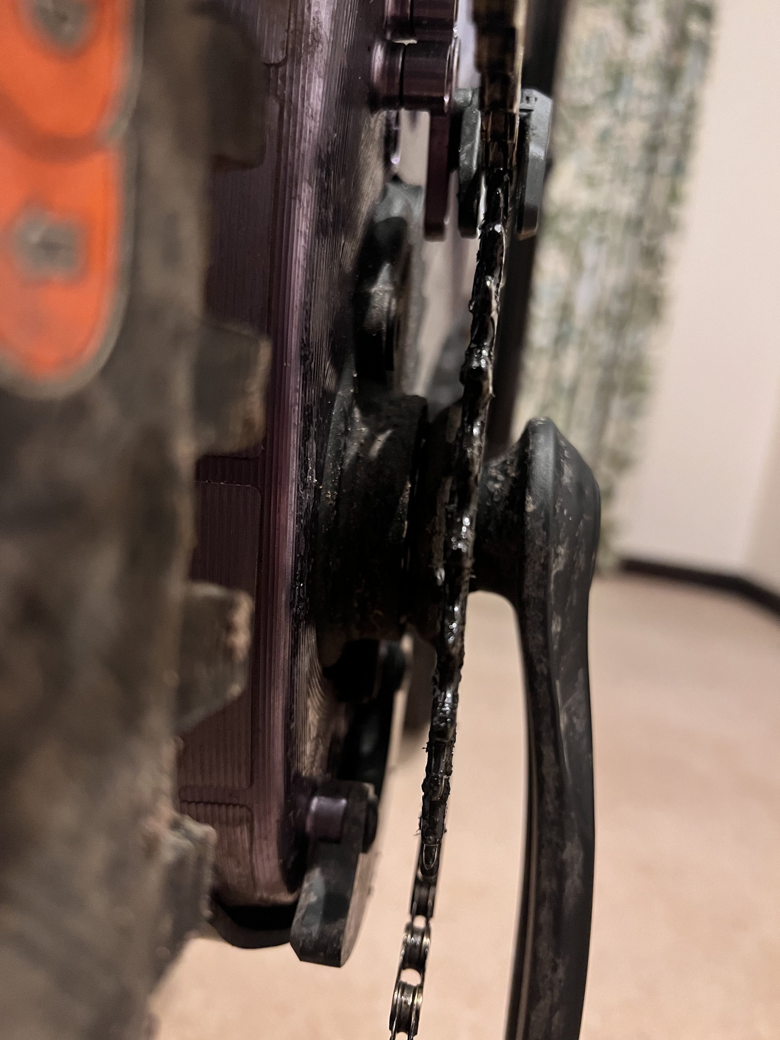

Hey folks, next n00b Voima building question - I've just fitted a chainring to the Voima, and it really doesn't look right. Chainline looks way out, when compared to the chain guide. Am I supposed to space this out, or have I bought the wrong chainring? I can't find a figure for the Voima chainline.
The lockring supplied with the chainring doesn't fit, either, so I used the Bosch one supplied with the frame.

Here’s a pic of mine
It's this one - Rotor ROUND DM BOSCH® e-MTB RING R32T BLACK
52 is the correct offset, double check everything is put on in the correct order. Can’t remember what it is right now 🤷‍♂️
@Onetime and @Durrti - thanks for the replies, that's enabled me to get the cranks and chainring fitted correctly now.
Useful to know the chainline, I couldn't see it on the Pole website. Order for everything was correct, spacers for chain device were undiscovered. Lesson learned, look in the box :sleep:
You should have some spacers in with the box to sort it? They go behind the plastic parts and ali adjuster?

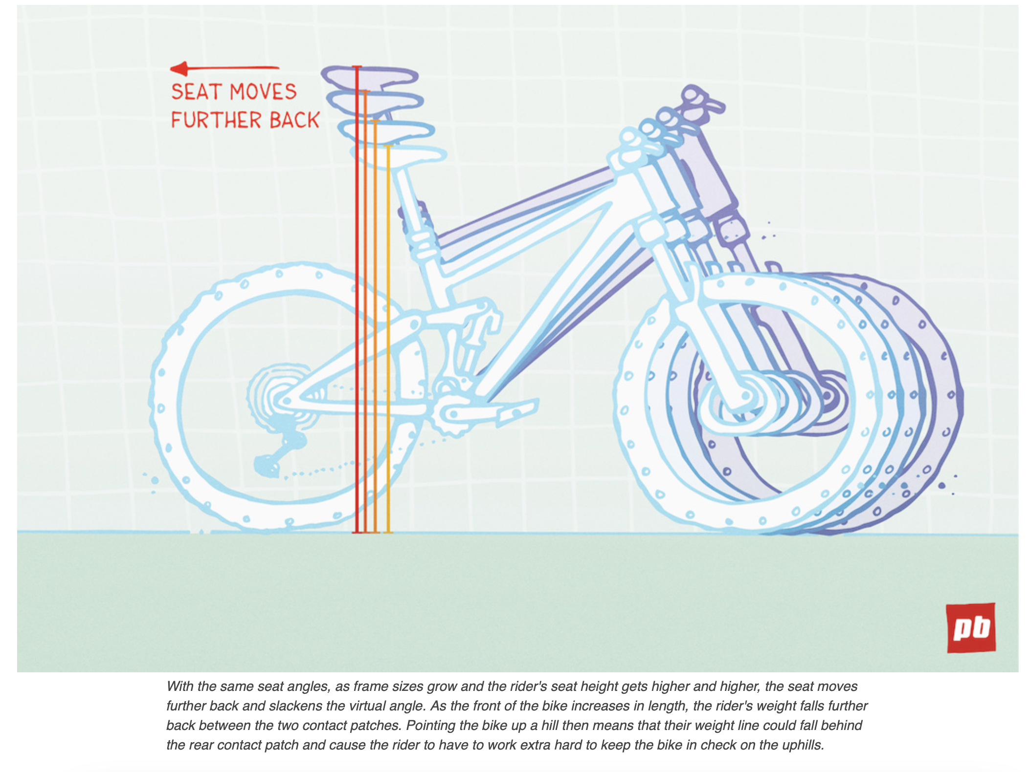

Rob you are quite a tall guy, a steep seat stay angle such as the Voima in an XLarge frame will equate to a slacker angle in say Medium frames due to the relationship of length of the stay and seatpost combined together with the longer than usual chainstay (a long chainstay length will slacken the effective seat stay angle allowing better climbing ).
Hi Wayne
This doesn't really make sense (or maybe I'm not understanding your post). You mention seat stay angle? Assume you mean seat tube angle?
The seat tube angle is not effected by chainstay length. The seat angle is the angle of the seat tube relative to the horizontal.
A long chainstay doesn't slacken the effective seat angle, they are independent of one another. What a longer chainstay does is change the rider weight distribution from rear to front centre.
Apologies if I've misunderstood you, but for anyone wanting to learn more there's a decent Pinkbike article here.
Have Pole over done the steep seat angle or are they simply compensating correctly for the larger lengths of an XL frame ?
They've made a seat angle that makes it easier to climb on, irrespective of frame size. Technically, a larger length dropper post will allow a taller saddle height, and that in turn will slacken effective seat tube angle if run at maximum height, depending on where the angle is measured from (relative to saddle height).
Ooops, yes
Yes this is what I'm interested in. Bear in mind that distribution will change as the bike climbs on steeper and steeper terrain.

One thing that Rob did not include in his response above is the effect of shock SAG and progression on the dynamic angle of the seat tube.
