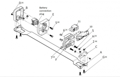

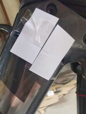

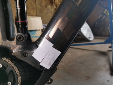

I don't like this rattling noise either. Moreover, I feel that the battery moves inside on a big rock and jumps. I know that feeling because I had a loose battery fitting on my old Merida (which is way quieter than the rail).
There is a difference in battery level when I put the bike upside down:
This new alignment system doesn't allow tune distance between the top and bottom brackets and seems like there is a 1.5mm too long.

Both brackets are attached to the alignment plate, you can't move them without bending the plate.
