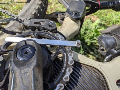

So I whipped up a few narrow access 6mm allen wrenches. A few to give out to friends and some spares to the internet. If anyone wants one drop me a PM. Pics attached. You'll be asked for shipping cost and a few bucks for material but nothing major. I'm not getting rich off this. I would like to see a company that can stamp these out of stainless steel, or do some sort of mixed material solution take a shot at a tool for this purpose. I tried a Wiha 1/4 thru bit style ratchet, which is pretty narrow, but it still didn't give me access to the bolts behind the chainring.
They're made out of 7050 aluminum plate (similar to 7075) and I figure they should be good for about 12-15nm of torque but they are a rescue tool, not meant for regular shop usage, so if you use it once in the middle of the woods and it saves you from walking home that's job done, if you use it 5 times and it breaks, well that meets my expectations, it's not a steel tool. Use a proper 6mm allen instead of this tool unless it's the only thing that fits and not doing it is going to ruin a ride.
I've made them the appropriate length to fit into the slots of a Project 76 Little Piggy holder lengthwise. That's what I use to carry a spare tool/spare parts and it seems to work quite well.
