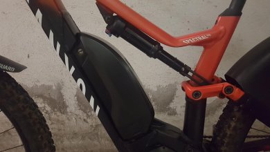

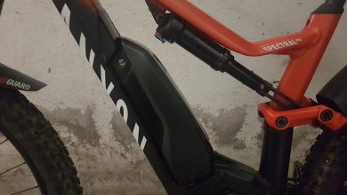

Hope these pictures help: the first one with the 504 Wh battery, the second one with the 630 Wh battery:

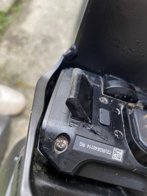

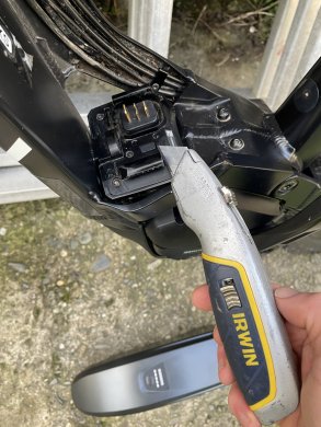

So my battery has finally turned up - is it really a simple case of Stanley knifing off the last lug?

Got it back home now and will attempt the mount surgery later. Weighed one of my 504wh batteries and the new one. 630wh is about 600g heavier, which tally up with what @norrit measured his at.

So five minute job to hack saw, tidy up with a Stanley, and a bit of light sanding, mine is not the neatest attempt though! - fits super tight which is good.
