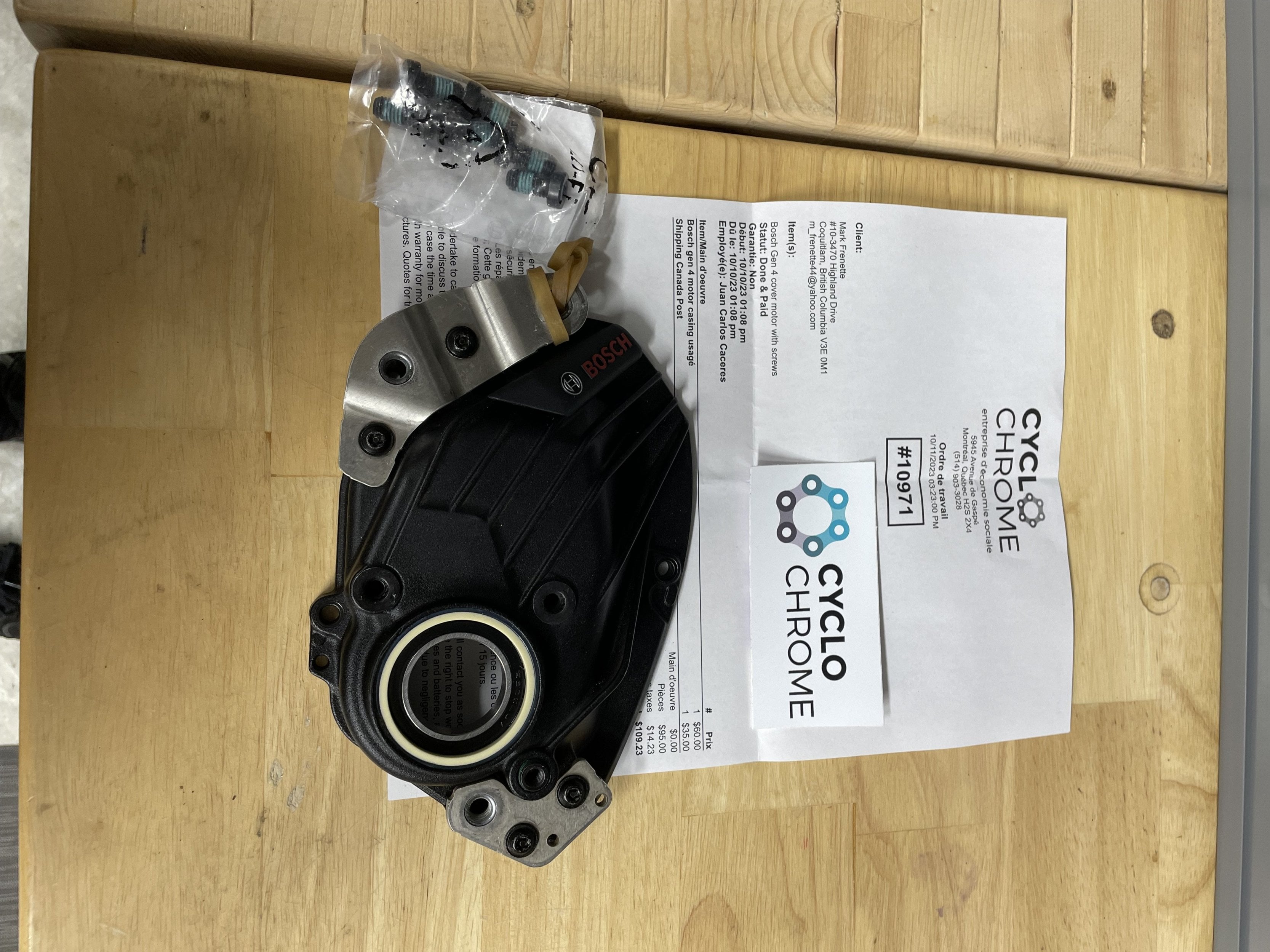

Update; As mentioned my neighbor had sheared two of the bracket screws and likely ovaled the screw holes in the bracket. I didn’t have any luck removing the broken screws (2) from the magnesium casing.
The @Bearing Man (I think??) suggested a casing replacement on the drive side. This included the casing and two bearings. They shipped the casing, two brackets and new mounting screws and bolts to a repair location in Hull/Gaspe Quebec (Canada). These guys were very helpful and quickly shipped the parts to me.
Juan at Cyclo Chrome INC. in Gaspe, Montreal, QC. was very helpful and shipped the parts to me. I was pleasantly surprised at the final price ($100 CDN).

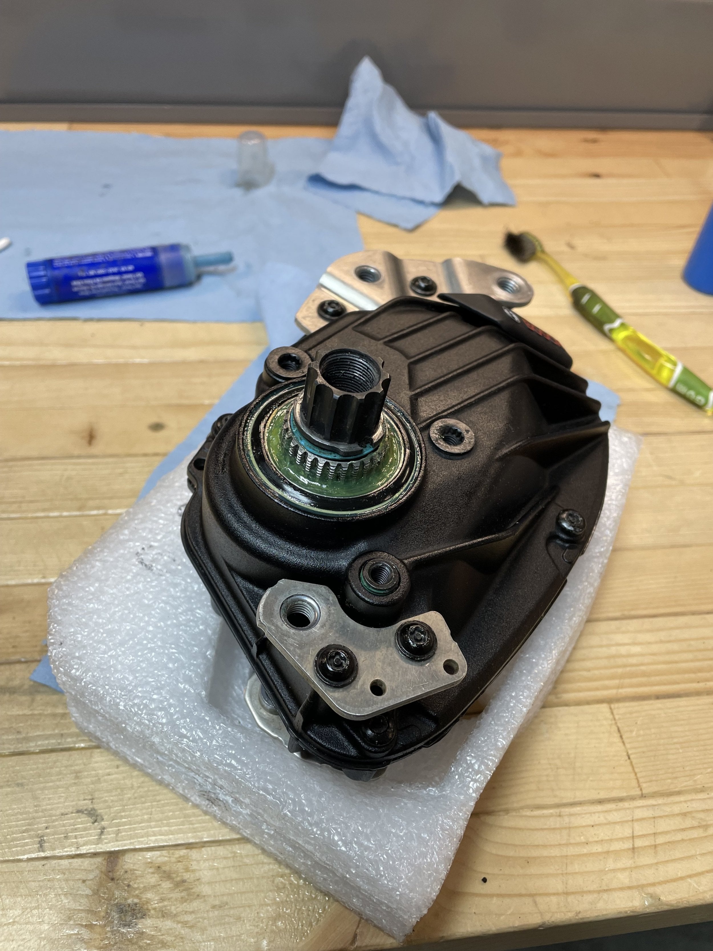

I assembled the new parts to the motor ,which has now become a spare, and sits on my shelf.
Two things though;
- I would suggest installing a bearing seal kit at this time, which includes the Bosch grease.
-Check the torques of all motor and bracket screws. I could not find any specs for these torques so I reversed torqued these screws and found that they are between 6-7 nm. I may be wrong.
-A special tool or technique to remove the retaining cir-clip which holds the bearing seal in place. I may have to make one that fits properly rather then using my traditional cir-clip tool. I must say that removing this particular cir-clip was the most difficult task.
I will open this up again because a small rubber cover may have slightly moved and caused reassembly somewhat difficult. I just want to make sure.

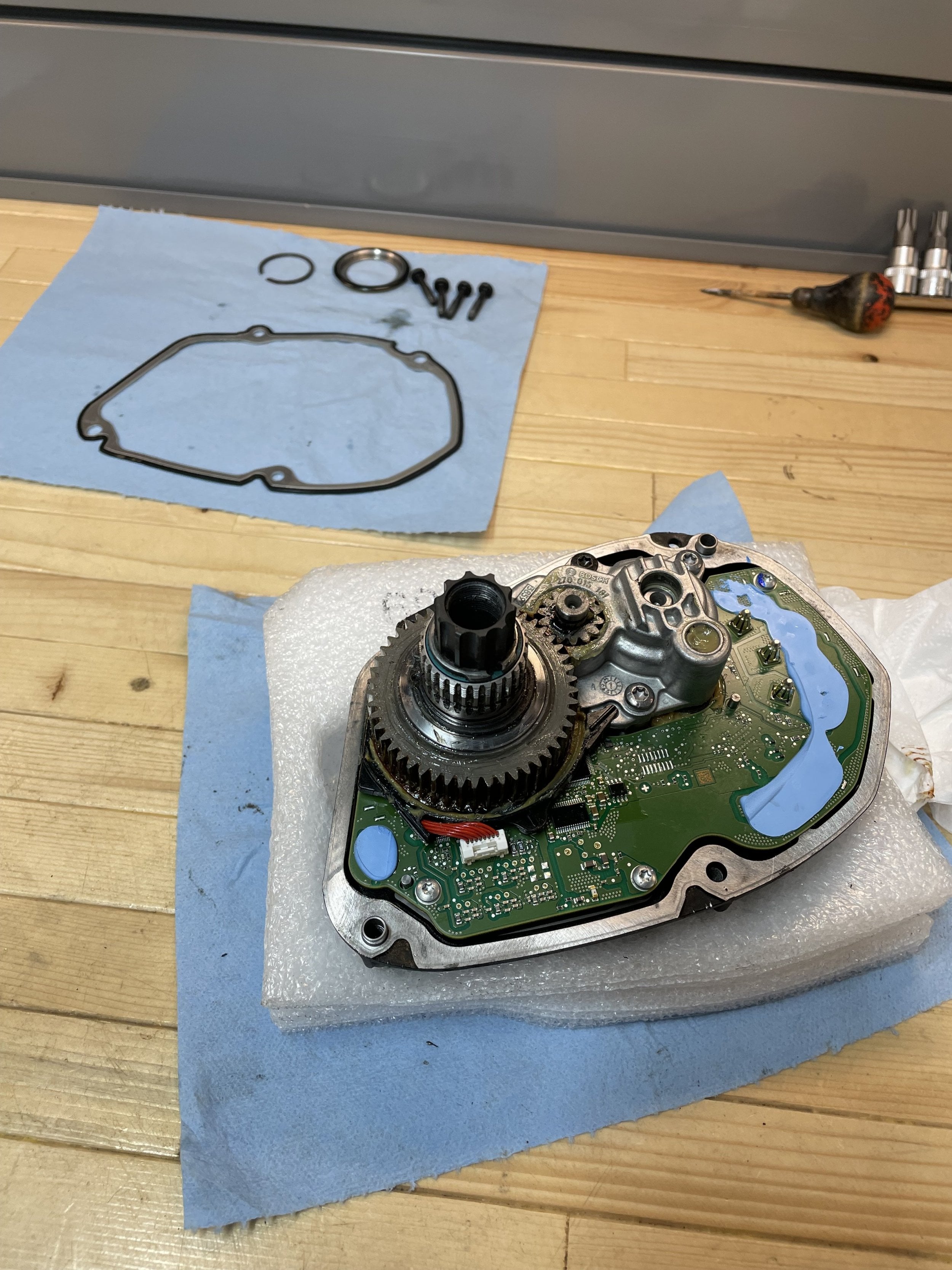

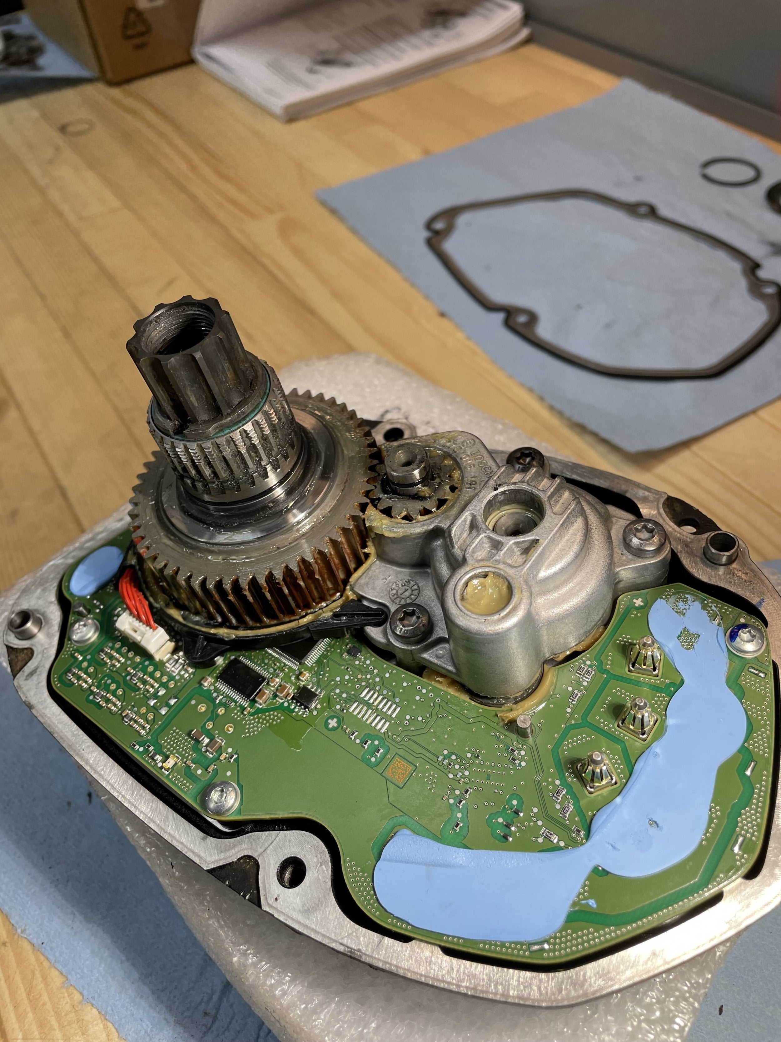

What's up with the rusty coloured grease on the big gear? Does that indicate water ingress? Seems like quite a long way into the shaft to reach that gear...
Yes, the grease does look rusty coloured. There was some water ingress along the casing seal so I carefully checked the gears and cpu board. There was no rust pitting on the gears but the very small amount of water has me worried. Basically enough water to get one end of a Q-tip damp. I believe the water may be entering through the casing seal in spots.
The inside was dry and clean, other than a very small amount of water.
Thanks for the shout out for Cycle Chrome, those guys have put a lot of effort into learning about eBike motors, including flying over to the UK to spend a few days training with us. As for your water ingress, I think what you perceive to be water is oil. This is a very light clear oil that looks just like water and sits on the circuit board and around the gasket seal. The oil leaches out from the grease and is doing its job. You can normally tell this because water entering the motor is seldom clean.
You can see that water has entered into your motor through the right hand crankshaft bearing and emulsified the grease, turning it grey.

What you said about the moisture makes sense. It was a very clear liquid that looked like water. I wasn’t too concerned about it because it was only found around the casing perimeter.
The grease around the cog(s) had two different colours though. I carefully inspected the rust-coloured grease but found no indication of rust developing. I applied a small amount of grease in areas that may have needed it before I closed up the casing. Removing the crank or cpu or some bearings is above my skill level. I think I will keep my motor servicing to a bearing seal kit (which I will install) and keep another kit as a spare. The Bosch grease included in the kit (greenish) is almost empty since I’ve used it several times.

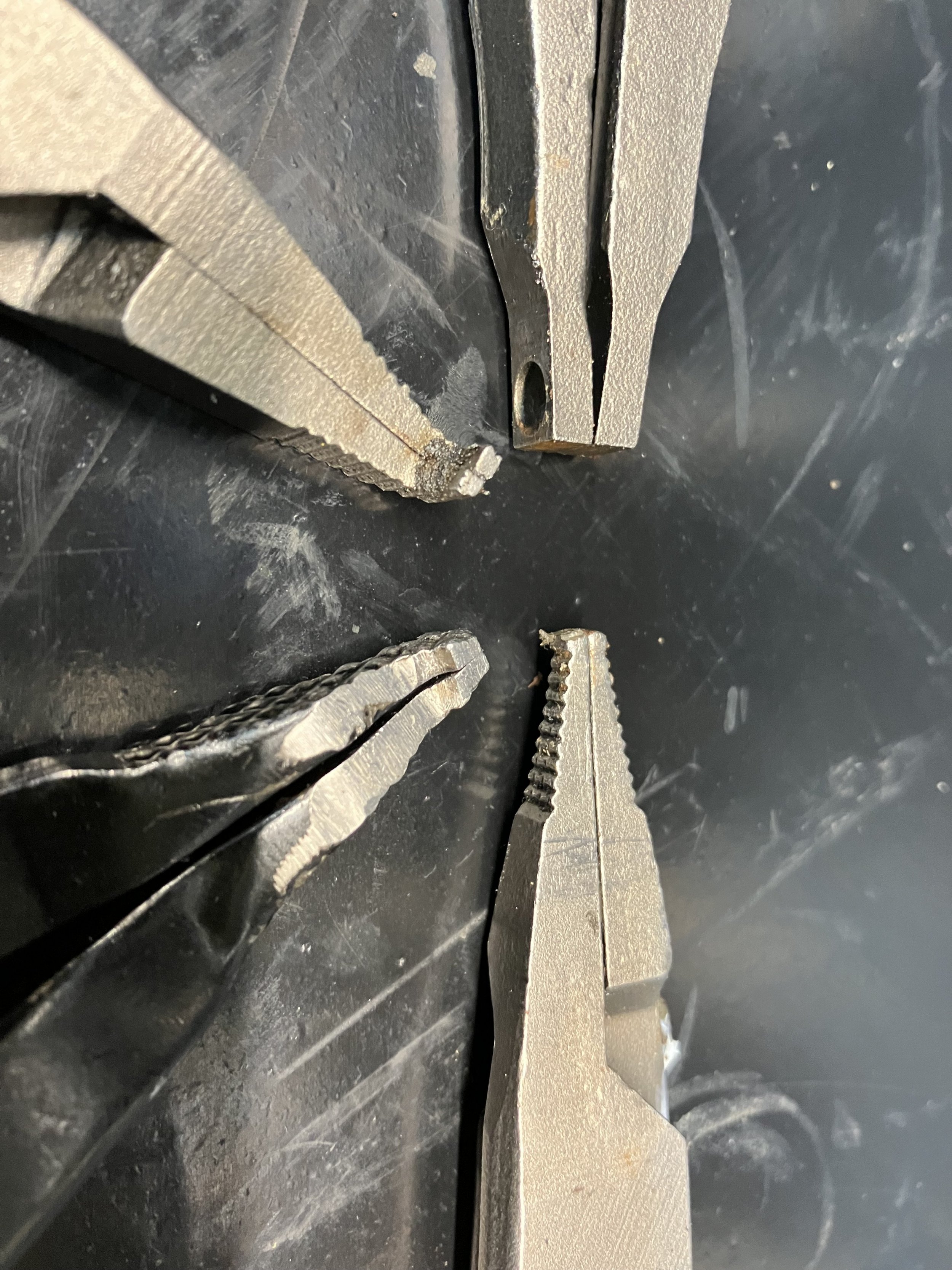

Installing the bearing seal kit is relatively easy if you have the right tools. The cir-clip can be a little tricky though (any tips or secrets for easier removal?). I may modify one of my cir-clip tool for this particular cir-clip. (Grinder, file, etc). What ever it takes. Using two common screwdrivers is possible …but it’s tricky.

We use an array of different 'C' Clip pliers. Some have to be modified to suit but most do the job as they are.
