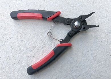

I couldn't undo the quicklink, no matter what I tried. So reverted to a pair of pliers squeezing one outer link end at an angle with the opposite outer link end. Slid apart in seconds. (I know you can use your shoelace, but that presumes that a: you can do shoelaces b: you weren't wearing rigger boots. )
I then couldn't get the new link to close up ?!?! brake on, weight the pedal etc etc .. nothing .. doh ... So I reverted to what seems to be one of my most used bike tools .. the circlip pliers ... click .. perfect .. Just wondering now if I could have used the pliers on opposite link corners in the same way I took it off ??? :rolleyes:
I was gonna buy a proper removal tool (on-line) but I needed one right then and there and couldn't wait. I've got cheap multi-purpose circlip pliers and lost a few over the years and ended up with a handful of spare prongs from previous sets, so I decided to grind one up into shape. Just a temporary one-off until I can buy a proper one. The thing is, it works so well that I can't be bothered buying a proper one. And oh, I can take the prongs off the handle, making it small enough to fit into my mini tool bag for the trail. There's enough exposed metal for me to squeeze them with my fingers... or if it's too hard I could wrap the prongs with my shoelace and pull... oh, hang on...
LOL ... I just realised why it didn't work based on your description ... What a total muppet, I joined the chain on the "lower run" and then decided I didn't want to run it round onto the top as the link would be too short and might jam somewhere... sadly, at that point, my brain was kidnapped by aliens, so I carried on regardless, and tried doing it with it on the lower run .. :oops:o_O:confused:(n):unsure::LOL::LOL::ROFLMAO::ROFLMAO::ROFLMAO: ... Brilliant .. welcome dementia ..
