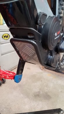

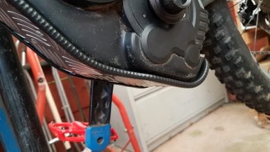

Beekeeper I had one made by frankie boy on this forum..... 565BAB41-4B86-4C80-A04F-C99EBB9CCA1F.jpegB881C4FA-5512-4BA3-ACFB-104EFFCBFC14.jpeg
don’t know if he has still got any plate left to make you one, but it might be worth asking... I gave him £25 and he sent me it
had it on for over a year.....a few dents and scratchs but still protecting my motor
My mate bought a carbon fibre one which lasted about 6 months, then fell apart.......so he then got a frankie boy special.....still going strong ?
perhaps give frankie boy a message see if he is still doing them ?

@Beekeeper, I have enough materials for one more bash plate if you want one?

Ok, do you want me to make a bash guard for you then? £25 inc. postage to mainland UK. Will buy enough materials for 2-3 so can do a better price if you know anyone else who wants one.

I'm interested to know how you attach these plates to the bottom as all I see is the two bolts holding the small plastic cover in place that fits just above the main cover ??
On the gen 2 you use the 4 countersunk screws that hold the plastic bash plate on.
