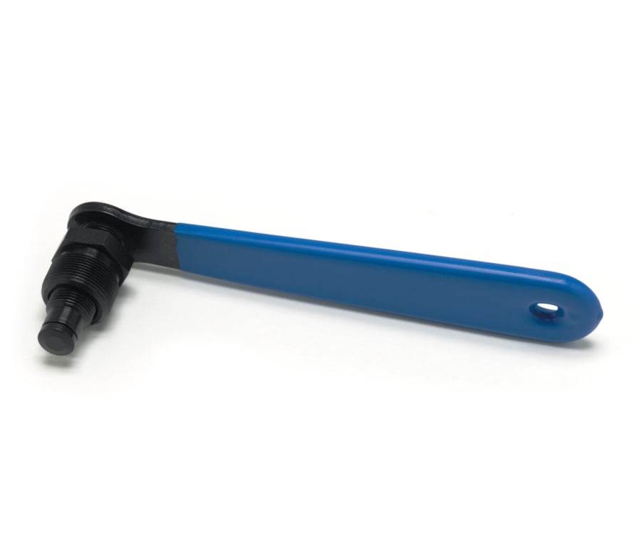

Bought something like this recently. Think it’s a park tool version. Has a blue handle. Does the job perfectly.

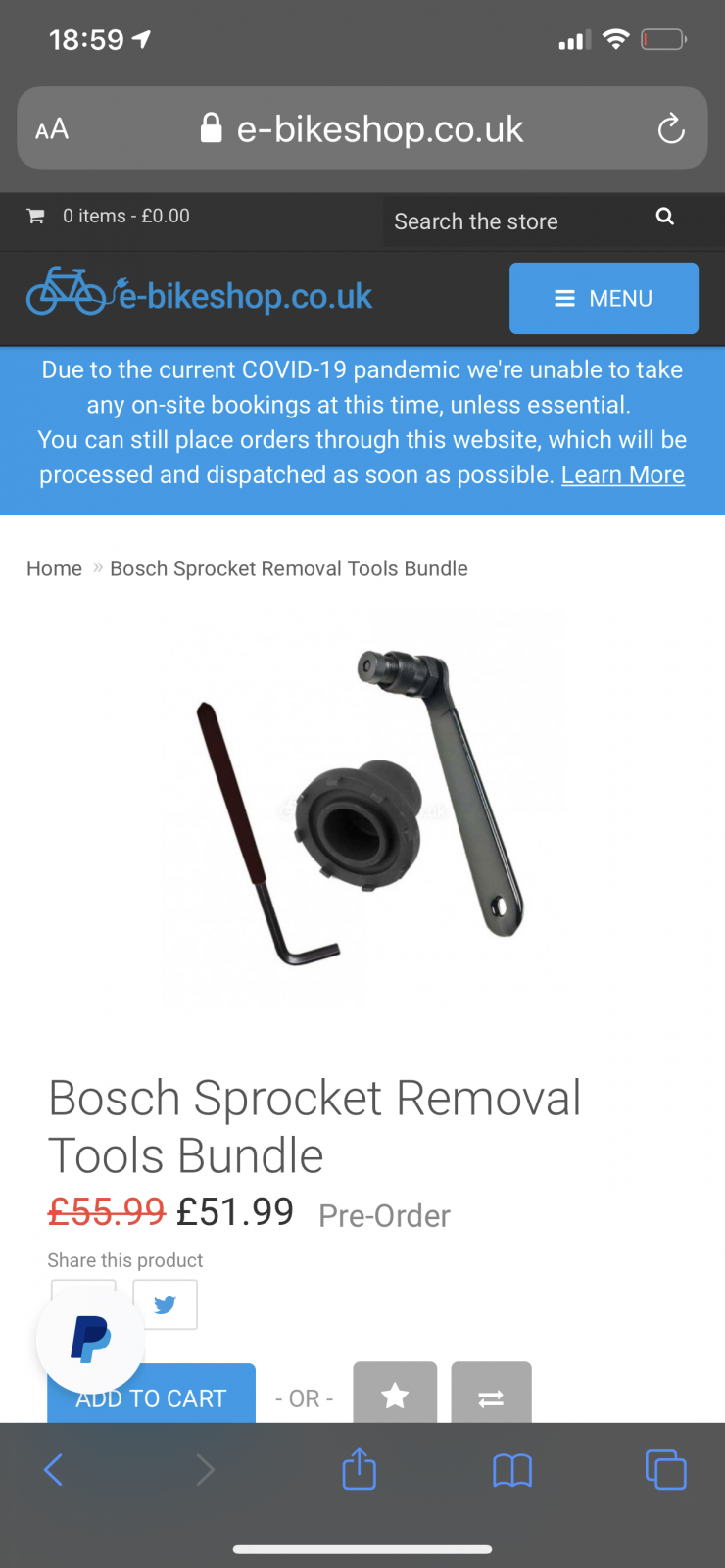

The one I got was part of a bundle of tools to remove the front sprocket on a Bosch Gen 2 motor (2019 Cube)
if you go to e-bike shop.co.uk you can get them there.
You will need a different too however if you have Active Line / Active Line PLUS Bosch motor as this has a smaller spline.
the website is very informative in this regard
Beware: that looks like a Park Tool CCP-22 which is NOT suitable for Bosch Gen 4 motors. That end bit is too small and disappears into the hollow axle without giving any purchase for the puller to work with.

Crikey
>£45 for delivery
Ouch
Going for this option instead

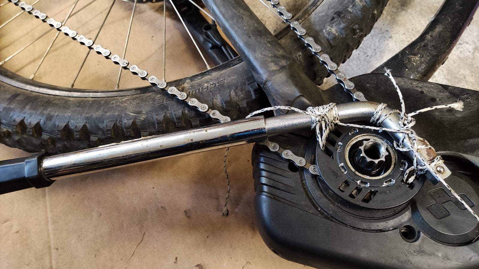

Tried that lock-ring tool... Don't bother with it.
The teeth aren't very deep so they'll jump out because of how wide the engagement is and just strip the holes.
Here's the solution you need... String
Or light rope ... I happen to have a lot of kite line lying around.
Tie a bent bar or spanner to the lock-ring
Lash it down tight avoiding the crank in the center.
works easy and you don't need to spend anything.
