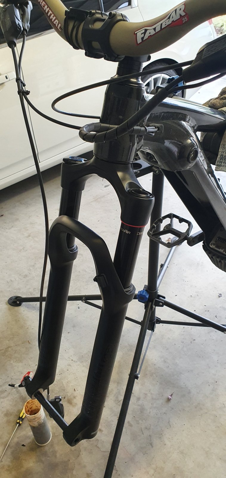

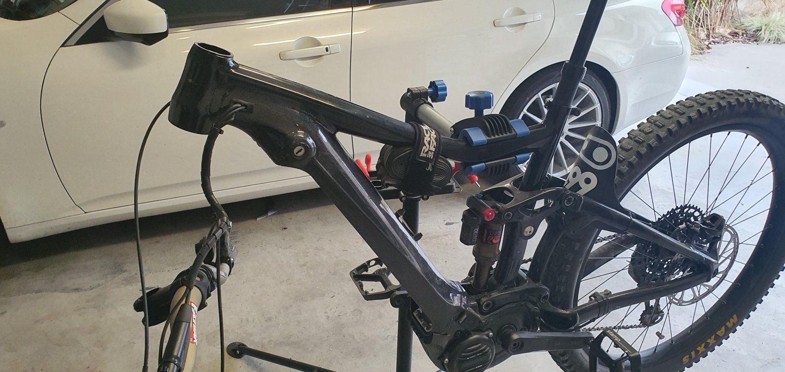

Thought I'd try the mullet thing to get the front rolling better through dips and roots.
Managed to pick up a new take off set of 29" Lyrik rc's for a great price so thrrw them on while waiting for the wheel I bought to arrive, popped my 27.5 back in to test the forks out today, had the Fox 36 performance on the e+1, also had recently picked up a new take off Fox Factory Dpx2 185x55 as well which is super plush ?
Wow is what I'll say about the Lyriks, I thought the Fox's were pretty good but these Lyrik's are quite alot nicer, super plush with great support and supple...even if the 29er front doesn't work out I won't be putting the Fox back up front!
The plan is to go back to my stock bars for the 29er as I'm running the 40mm Fatbar so the bar height will stay the same but I'll have Reign geo up front for bombing downhill...so cool when a plan comes together and actually makes something better haha...

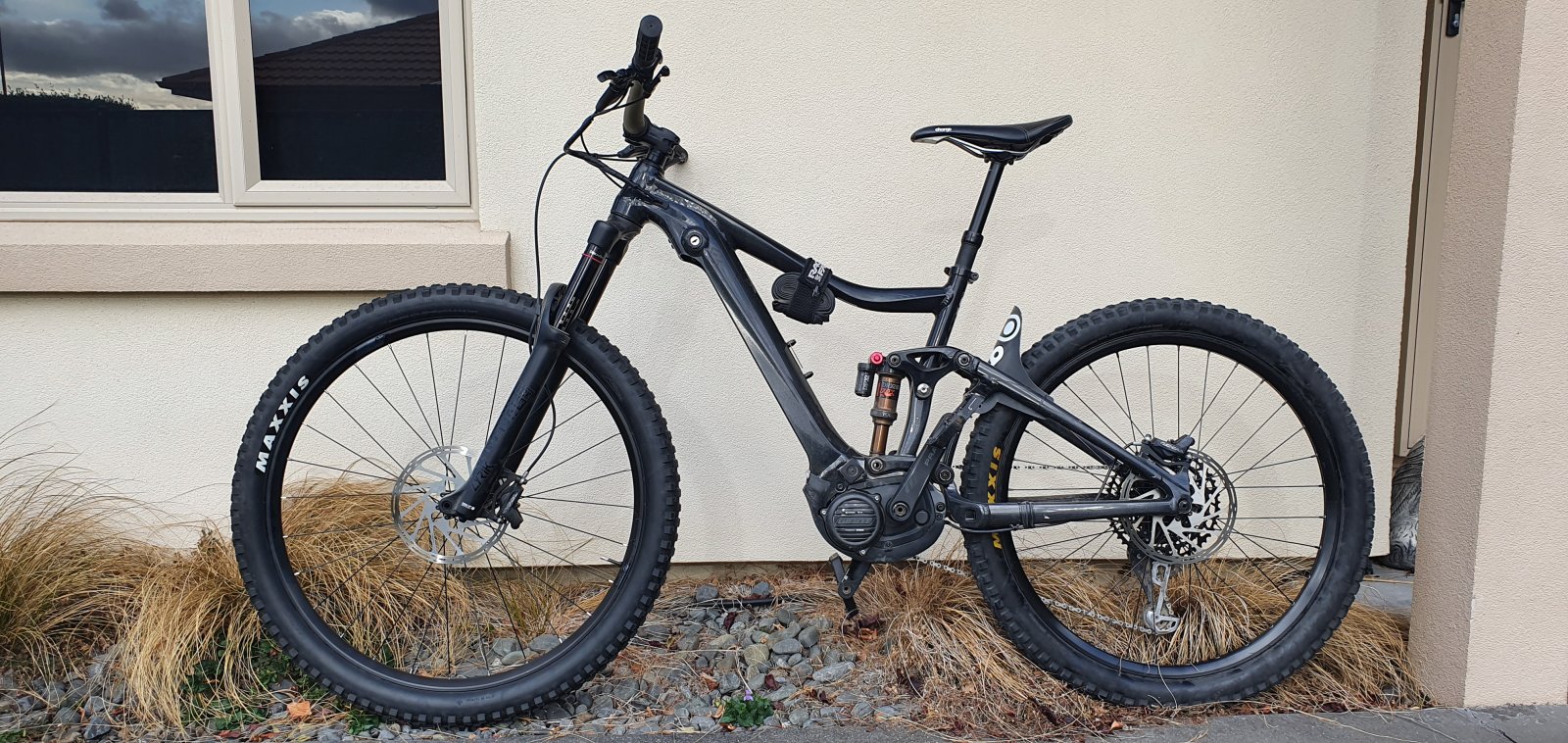

My new wheel turned up the other day after I'd just been for a ride and destroyed my 2nd rear hub ?
Had a spare cheap rear wheel so swapped tyre etc over then fitted front wheel and tested in driveway with the still fitted 40mm Fatbars....it felt really lazy just doing circles on concrete so did what I'd planned on and swapped stock bars back on.....much better feeling and ride position feels pretty normal.
Measuring vertically from floor to top of stem its gained 20mm and floor to crank bolt 15mm, end of bars is the same as with Fatbars was before.
