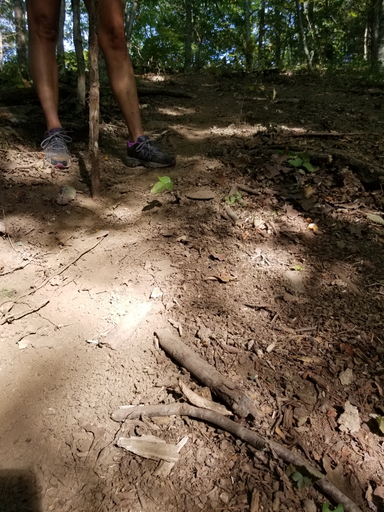

This is the stuff were riding in, and as my OEM Rekon gets used up, I'm struggling to get traction when climbing.
The e-wild looks great, and I know the Forekaster works well on this stuff too. Id like to try a highroller II as well. Lots of choices for sure.
With the wet season coming on, is a narrower tire going to cut through slop better than a + size? I'm settled on something between 2.5 and 2.8 but need help deciding!

Photos can be deceptive I know, but at first glance I believe my Giant Trance E+2 shod with 27.5x2.6 Michelin E-Wild would cruise up that no problem.

Yes pictures never show accurately how steep it is. This one is hard to walk without falling down, hence my wife using a make shift walking stick. But the terrain is shown accurately.... loose, with inches of rubble and hard clay and sedimentary stone underneath.
This is a first gear and second gear... max boost (level 5) climb for me.
