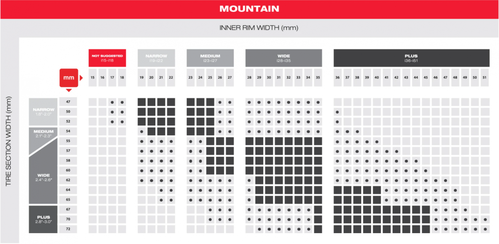

On stock roval rims? How about 2.5s? Not too skinny on 38mm rims?
Yup ! On stock rims !!!! It gives you more air volume. You probably loose out a little on lateral suspension when you're leaned over as the tyre can't flex as much as it would on a thinner rim, so you might notice this is you're a good rider.
2.5's are probably the ideal size I guess .. For me, 2.4-2.6 seems good.

Take a look at this tyre/rim chart from WTB
Page past the first chart to the chart for mtb

Thank you!
