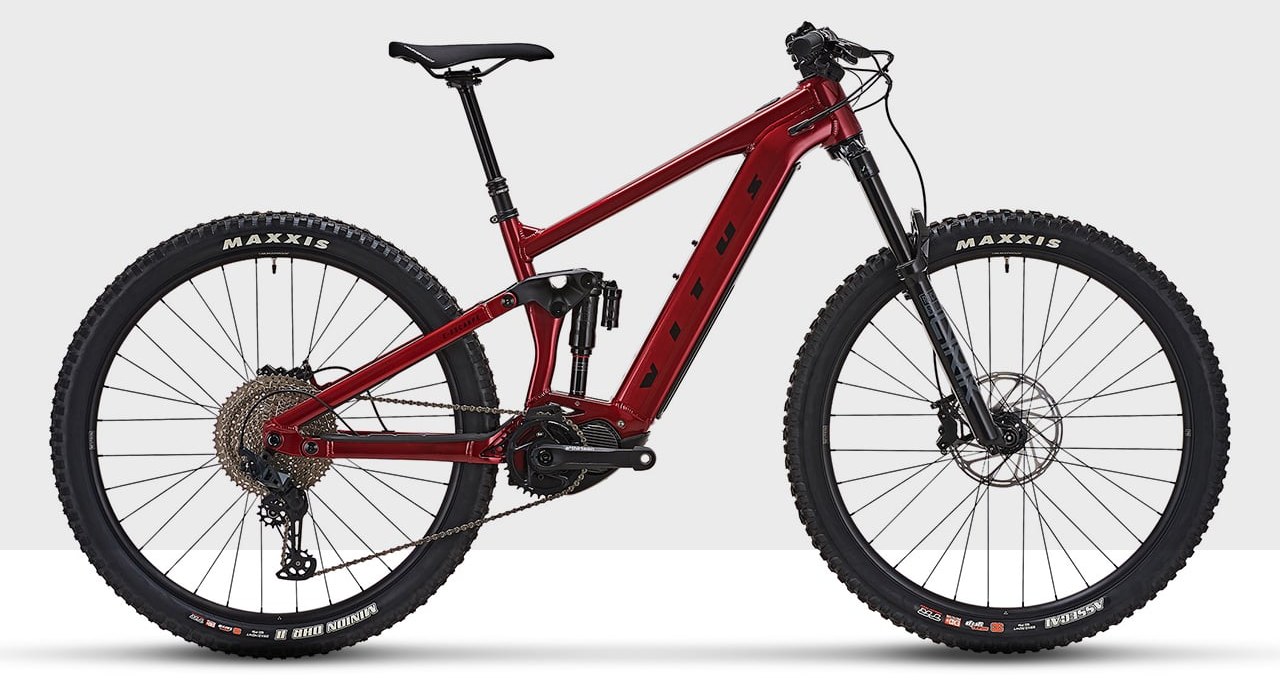

The Vitus E-Escarpe 290 2024 is a direct-sale aluminium trail eMTB from CRC/Wiggle's house brand, refreshed for the latest model year around Shimano's EP801 drive on a full-29-inch chassis. It runs 150 mm of fork travel and 140 mm rear, with a 630 Wh battery and a claimed system weight in the mid-23 kg range. Headline numbers: 85 Nm of torque, 600 W peak power, a 65 degree head angle, a 450 mm chainstay and reach growing from 437 to 522 mm across four sizes. The single-trim direct-sale model means buyers configure the bike through Vitus's online channel. Community verdict: a solid value-led aluminium trail eMTB with proven Shimano EP801 reliability, though community visibility has dropped since CRC's restructuring.
Drive system and range. The Shimano EP801 is the latest evolution of the EP8 family, delivering 85 Nm of torque and 600 W of peak power. It supports Bluetooth firmware updates through the E-TUBE Project Cyclist app and gives riders proper assist mode customisation that Bosch's locked-down ecosystem cannot match. The 630 Wh battery delivers strong real-world range, with mixed trail use typically reaching 50 to 80 km depending on assist mode and rider weight. Shimano's worldwide service network adds reassurance for long-term motor support, although owners of older Vitus generations have flagged that EP-series error codes can be opaque until cleared at a Shimano dealer.
Geometry and handling. A 65 degree head angle is bang on the modern trail norm. Reach grows from 437 mm in S to 522 mm in XL, a generous 85 mm spread that suits both shorter and taller riders. The 450 mm chainstay is identical across all sizes, on the longer side of the trail-eMTB market, which favours stable climbing and high-speed composure. Wheelbases run 1193 to 1291 mm. The Vitus runs full 29-inch wheels, a deliberate move away from earlier-generation E-Escarpe models that ran mullet (29 front, 27.5 plus rear). The E-Escarpe shares its frame with the longer-travel E-Sommet, with the main difference being shock travel.
Build and value. Vitus offers the E-Escarpe 290 as a single trim through their direct-sale channel. Build details depend on stock availability: historically the E-Escarpe has run FOX 36 Performance fork, FOX Float DPS rear shock and SRAM or Shimano mid-tier drivetrains. The standout strength is the direct-sale price-to-spec ratio: Vitus traditionally undercut equivalent brand-name aluminium trail eMTBs by £500 to £1,000 thanks to the cut-out-the-middleman model. The questionable note is the direct-sale support model: Vitus dealer reach is essentially zero, with all warranty and service routed through CRC or Vitus's online channels.
Community-verified strengths. Long-term Vitus E-Escarpe and E-Sommet owners praise the chassis: the same frame base spans the trail-to-enduro range with only shock travel differing between variants. Owners report the bike as fitting well-matched fork and rear suspension setups, with stable, planted feel that inspires confidence on technical terrain. The 630 Wh battery and Shimano EP801 motor combination has solid long-term reliability data across the Vitus eMTB line.
Caveats and known gripes. The 2020-2022 generation E-Escarpe frames had a documented seat tube limitation: shock-passing-through-frame design prevented full insertion of 150 mm droppers even on size L frames. The 2024 generation should resolve this, but buyers should confirm with the dealer. Earlier generations also had small psi tolerance windows on the fork pressure, with owners reporting wallowing if too low and harsh feel if too high. Vitus / CRC's restructuring in 2024 affected long-term dealer support and warranty consistency, with some community members reporting longer wait times for service. And the single-trim ladder gives no premium upgrade path within the model.
Verdict. The E-Escarpe 290 2024 suits the value-led trail rider who wants Shimano EP801 reliability, a 630 Wh removable battery and full-29-inch geometry on an aluminium chassis at direct-sale pricing, and who is happy with online-only warranty support. Riders chasing wider UK dealer reach, more trim options or newer-generation motor systems should look at the Cannondale Moterra Neo, the Cube Stereo Hybrid or the Marin Alpine Trail E. Production status: current.
Geometry read
Size
Descending
63
A solid all-round descender (65° head angle, 140mm) — capable in the rough and steep without being an all-out bruiser.
Playfulness
57
Size balance
96
Rear-long with a planted front in L (FC:RC 1.76) — easy to weight the front and quick to turn, though it can feel light at the back at real speed.
Technical climbing
76
Shimano EP801 and a steep 76° seat angle keep the weight planted over the front — a proper winch. 600W of peak power and 85Nm of torque — a strong full-power motor.
Best suited toBig-day all-rounders who climb a lot and still descend hard.
Strong up and composed down — a do-it-all, not a specialist.

Bike geometry diagram
SMLXL
Reach437 mm451 mm478 mm522 mm
Stack617 mm626 mm635 mm644 mm
Chainstay450 mm450 mm450 mm450 mm
Headtube Angle65°65°65°65°
Seattube Angle (eff)76°76°76°76°
BB Drop35 mm35 mm35 mm35 mm
Wheelbase1193 mm1211 mm1243 mm1291 mm
Front Centre743 mm761 mm793 mm841 mm
FC:RC1.651.691.761.87
