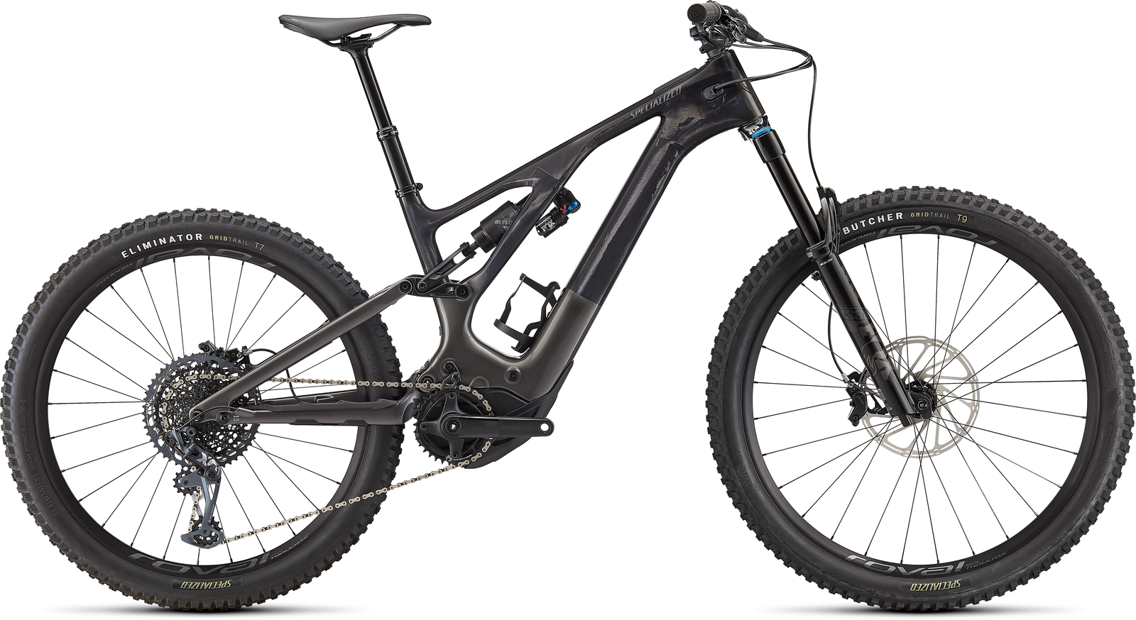

Hugely popular full-power trail bike that set the trail standard
Motor
Specialized 2.2 · 90Nm · 565W
Battery
Specialized M3-700 · 700Wh
Travel F/R
160/150mm
Wheels
MX (29F / 27.5R)
Frame
Full carbon / Aluminium

The 2022 Turbo Levo is the launch-year catalogue of the third-generation (Gen 3) Levo, introduced in March 2021. Every trim runs the Specialized 2.2 motor (90Nm, 565W) with the MasterMind or standard TCU, a dedicated mixed-wheel chassis (29in front, 27.5in rear), 160mm fork and 150mm of Horst-link rear travel. The 700Wh M3-700 battery features on everything except the base Alloy, which makes do with a 500Wh M3-500, so check which pack you are getting at the bottom of the range.
Geometry is the party trick: carbon frames (and the Comp Alloy) offer six settings, with eccentric headset cups swinging the head angle from 63 to 65.5 degrees and a chip moving the BB 7mm either way. S-Sizing runs S1 to S6 (Pro and S-Works sold in S2-S6), letting riders size on reach rather than inseam.
The UK ladder ran from the £5,250 Alloy (RockShox 35 Silver, SRAM SX) through the £6,750 Comp Alloy and £8,250 Comp (the FACT 11m carbon frame with Fox 36 Rhythm and GX Eagle, added to the range in spring 2022), to the Expert (launched at £8,750, listed at £9,250 by mid-2022) and £10,750 Pro with mechanical X01 Eagle and Fox 38s, topping out at the £13,000 S-Works with XX1 AXS, Magura MT7s and Roval Traverse SL carbon wheels. UK prices rose noticeably during 2022, so used listings quote a spread of original RRPs.
This model year is discontinued: the 2023 catalogue re-priced the range and moved the Expert to GX AXS, and the platform was replaced outright by the Gen 4 Levo in 2025. As a used buy the 2022 and 2023 Gen 3 bikes are mechanically very close, differing mainly in build kits and colourways.
