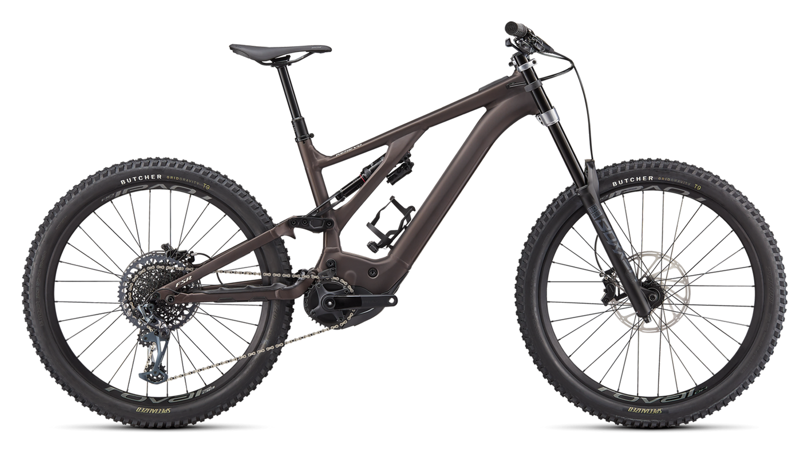

The 2022 Kenevo was the full-power freeride eMTB in Specialized's range, a 180mm-travel M5 alloy Sidearm chassis on 27.5in wheels at both ends, running the Specialized 2.2 motor (90Nm, 565W). It sat above the Levo as the self-shuttling bike-park and big-mountain option, with an Enduro-derived rearward axle path and DH-grade Roval alloy rims and Butcher Grid Gravity T9 tyres on both builds.
Two trims were sold. The Comp (£6,750) paired a Marzocchi Bomber Z1 fork with a Fox Float X Performance air shock, SRAM GX/NX Eagle shifting, Code R brakes and the smaller 500Wh battery with the LED TCU. The Expert (£8,750) went full downhill spec with a dual-crown RockShox Boxxer Select RC, a Super Deluxe Select Plus air shock, X01 Eagle, 220mm rotors front and rear, the 700Wh battery and the MasterMind TCU with MicroTune. Unusually for the Kenevo line, neither 2022 build ran a coil shock.
Geometry is committed across the S2 to S5 sizes: a 64.5-degree head angle, 78-degree seat angle, 450mm to 525mm reach and long 454mm chainstays, with a lower shock mount flip chip for fine-tuning. The platform had one further year: a 2023 runout switched both builds to coil shocks and revised drivetrains before the full-power Kenevo was discontinued, leaving the lightweight Kenevo SL to carry the name on.

Bike geometry diagram
S2S3S4S5
Reach450 mm475 mm500 mm525 mm
Stack602 mm611 mm620 mm629 mm
Seattube400 mm420 mm440 mm465 mm
Chainstay454 mm454 mm454 mm454 mm
Headtube Angle64.5°64.5°64.5°64.5°
Seattube Angle (eff)78°78°78°78°
Wheelbase1234 mm1263 mm1292 mm1322 mm
Headtube105 mm115 mm125 mm135 mm
BB Height351 mm351 mm351 mm351 mm
Standover799 mm799 mm799 mm799 mm
Front Centre780 mm*809 mm*838 mm*868 mm*
FC:RC1.721.781.851.91
