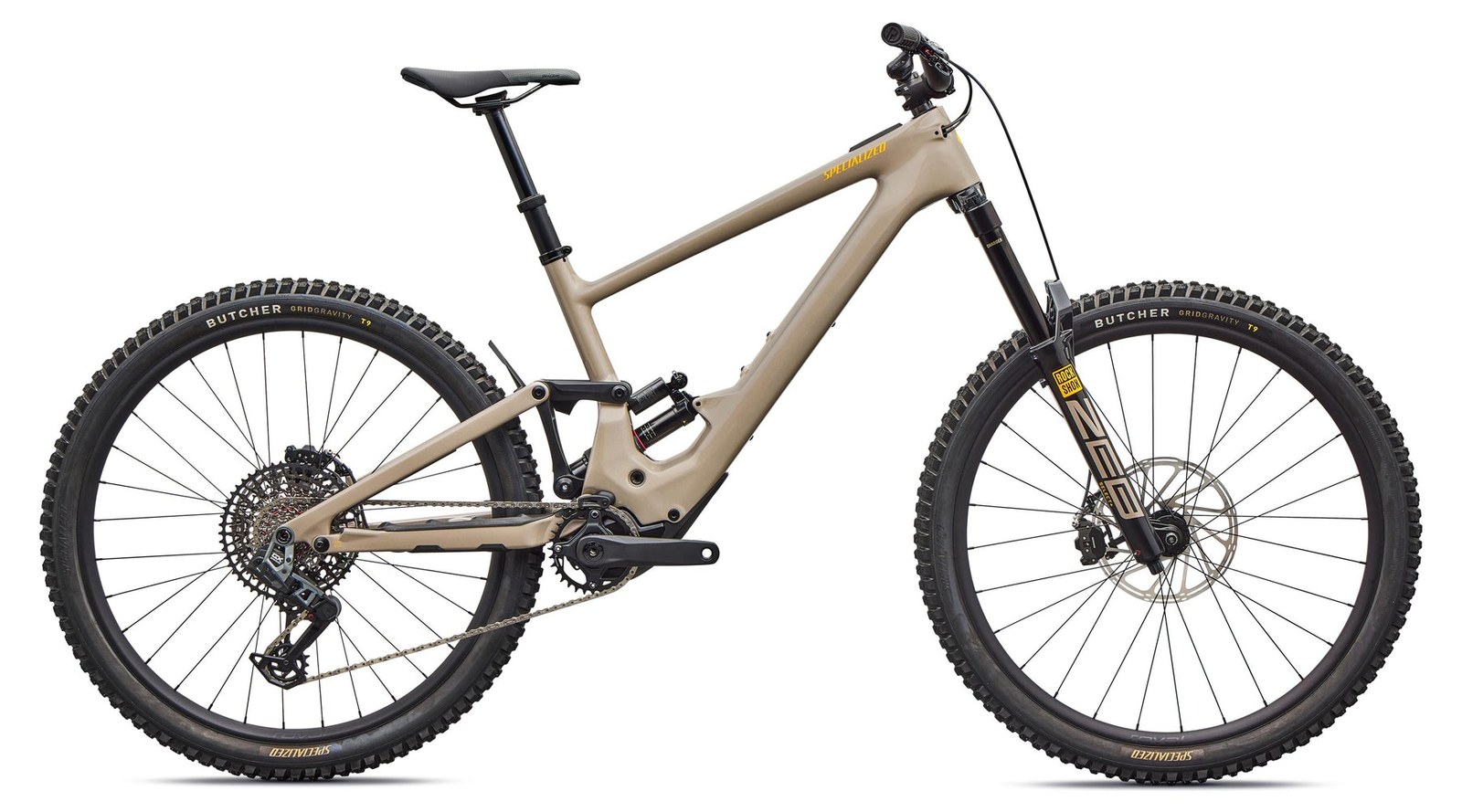

Carbon long-travel SL eMTB with adjustable geometry
Motor
Specialized SL 1.2 · 50Nm · 320W
Battery
Specialized SL1-320 · 320Wh
Travel F/R
170/170mm
Wheels
29F/29R
Frame
Full carbon
Weight
20.36 kg
Price
£5,999
View the Specialized Kenevo SL on Specialized’s site
Specialized Kenevo SL 2026
From £5,999
EMTB Forums verdict
The Specialized Kenevo SL 2026 is the long-travel lightweight eMTB in the Specialized line, a carbon Horst-link chassis with 170 mm of travel front and rear powered by the new SL 1.2 motor and an integrated 320 Wh battery. Headline numbers: 50 Nm of torque, a manufacturer-claimed 320 W peak, 20.36 kg claimed weight, a properly slack 63.5 degree head angle and reach progression 435 mm on S2, 460 mm on S3, 485 mm on S4 and 510 mm on S5. The community framing has long divided: @p3eps puts it directly: people calling the Kenevo SL underpowered are missing the point, this is for riders who want a little help on climbs and to ride further.
Drive system and range. The Specialized SL 1.2 is the latest evolution of the brand's lightweight motor with 50 Nm of torque, 250 W nominal and a 320 W manufacturer-claimed peak from a remarkably light 1.95 kg unit. The Specialized SL1-320 320 Wh battery is integrated and not removable. @jcmonty notes a detuned Avinox setting at 60 Nm and 400 W "feels close to Kenevo SL power" - a useful cross-reference. Range is the Kenevo SL's design trade: 320 Wh on the 50 Nm motor with the Specialized 160 Wh range extender (mounted in the bottle cage) lifts capacity to 480 Wh for big days, getting genuine enduro-range coverage at the cost of carrying the extender.
Geometry and handling. A 63.5 degree head angle is properly slack and modern enduro, in line with what you would expect on a full-power 170/170 mm chassis. Reach steps clean 435 mm on S2, 460 mm on S3, 485 mm on S4 and 510 mm on S5. The 447 mm chainstay is held constant across sizes. Wheelbase progression 1238 to 1327 mm is on the longer side. With 170 mm of travel front and rear on a 20 kg chassis, this is genuinely a long-travel enduro tool wrapped in lightweight kit: there is nothing comparable for descent capability at this weight.
Build and value. Specialized publishes a single base trim at £5999, 20.36 kg, for the spec we have on file. The 2026 platform inherits the proven Kenevo SL chassis with the new 1.2 motor as the headline upgrade. £5999 puts the Kenevo SL within reach of mainstream full-power enduro carbon competitors: it is the value play if you want lightweight feel and 170 mm of travel without paying boutique-brand prices.
Community-verified strengths. Three things owners praise. The 170/170 mm chassis at 20.36 kg is genuinely class-leading for descent capability at this weight, with prior-generation owners consistently rating the Kenevo SL's rough-trail composure. Specialized's dealer network is the deepest in the eMTB market, which matters for warranty service. And the 63.5 degree head angle paired with the 1.95 kg SL 1.2 motor gives a unique combination of slackness and lightness not available from any other brand at this travel.
Caveats and known gripes. Three honest flags. @alleeex documents significant pedal kickback on large cases and hard drops to flat, severe enough to be an ankle-injury concern. This is a fundamental kinematics issue with the platform and worth knowing about. @Neeko DeVinchi flags the non-removable battery design creates complications for international travel and range-extender management: be aware. And @Utah Rider notes that the prior 2023 Kenevo SL was marked down to $3800 USD at one Utah LBS in 2024 / 2025 as the platform aged: the 2026 may see similar pricing pressure within 18 months of release. @alleeex also notes O-Chain compatibility is not available for this motor.
Verdict. The Kenevo SL 2026 is for the rider who wants the descent-capable 170/170 mm chassis at proper lightweight weight (20.36 kg) with the latest SL 1.2 motor, Specialized's dealer network and is comfortable with a 320 Wh integrated pack supported by the Range Extender. Pedal kickback is a real issue on large hits to know about. If you want a removable battery, full 80 to 90 Nm power or a quick-handling trail bike, look at a Levo SL, Trek Fuel EXe or Orbea Rise. Production status is current.
