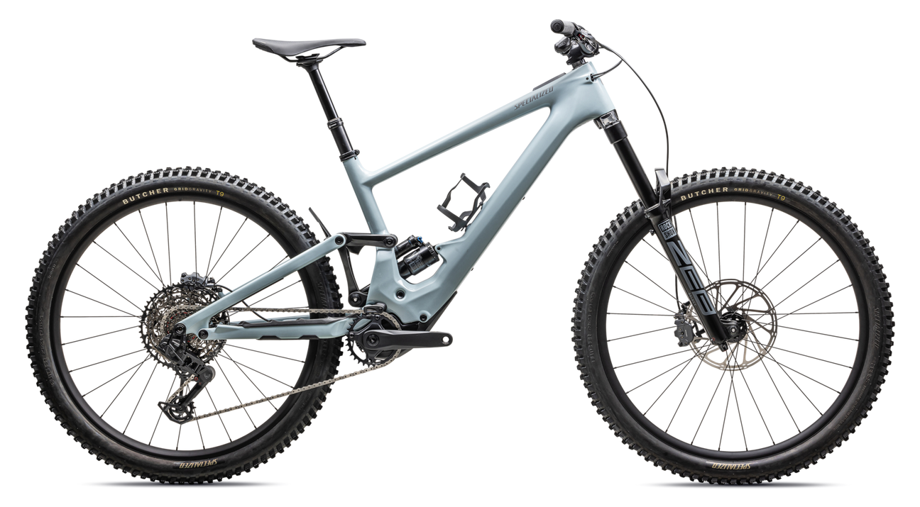

The Specialized Kenevo SL 2025 is the Californian brand's lightweight enduro eMTB, a carbon Horst-Link chassis with serious 170 mm of travel front and rear, powered by the Specialized SL 1.2 motor system. Headline numbers: 170/170 mm of travel, SL 1.2 motor at 50 Nm and 320 W peak (1.95 kg, the same lightweight platform as the Levo SL), a non-removable 320 Wh internal battery, a properly slack 63.5 degree head angle, reach 435 to 510 mm across S2/S3/S4/S5 with two chainstay/wheelbase flip-chip options (8 geometry rows), 20.32 kg claimed base weight, and a £6,250 base price stepping through Comp (£6,500), Ohlins Coil (£7,999), Expert (£8,500, 19.6 kg), to S-Works (£12,500). The community verdict, summed up by @p3eps, is that "those who are saying the Kenevo SL and Levo SL are underpowered are clearly missing the point of these bikes": this is for the rider who wants the lightest possible 170 mm enduro chassis with a polite assist.
Drive system and range. The Specialized SL 1.2 motor at 50 Nm and 320 W peak is the lightweight motor used across the SL platform. The 320 Wh SL1-320 battery is the small-pack defining choice and is not removable per @Neeko DeVinchi, which "creates complications for international travel and range extender battery management". The optional Range Extender bottle adds 160 Wh for big-day rides, taking total capacity to 480 Wh. Real-world range on 320 Wh in a 20.3 kg full-enduro chassis is realistically 25 to 35 miles in Eco/Trail modes, dropping significantly in Turbo. @Bullit notes that "TQ engine reduces performance when constantly driven in turbo mode", though the Kenevo SL uses Specialized's own SL motor rather than TQ.
Geometry and handling. The 63.5 degree head angle is properly slack and bang on the modern enduro brief. Specialized uses size-naming (S2 to S5) with reach 435, 460, 485 and 510 mm and chainstays available in two flip-chip settings: short (437 to 440 mm) for nimble handling or long (447 mm) for stability. Wheelbase scales 1225 to 1316 mm. The flip-chip plus four-size programme gives genuine geometry flexibility, more than most rivals offer. Specialized ran a full 29 inch wheel setup on this generation, which @cycle101 flagged as a step away from the original Kenevo's 27.5 mullet character.
Build and value. Five trims with a £6,250 to £12,500 spread. @Utah Rider notes 2023 Kenevo SL stock has been heavily discounted in the US (one example marked down to $3,800 from a Utah dealer), so off-season buys are available. Standout choice across the range is the carbon-everywhere construction at 20.32 kg base/19.6 kg Expert weight. Questionable: the £12,500 S-Works premium for largely cosmetic and finishing-kit changes is hard to justify against the £6,250 base when the SL 1.2 motor is identical.
Community-verified strengths. First, the chassis quality and weight: 19.6 to 20.3 kg for a 170/170 mm full-enduro is genuinely impressive. Second, the geometry flip-chips and size-specific reach give proper fit options. Third, @Neeko DeVinchi notes the "revised linkage placement designed to prevent stone and crud accumulation in compression areas", a real-world durability touch.
Caveats and known gripes. Pedal kickback is the most consistent technical flag: @alleeex reports the Kenevo SL "suffers from significant pedal kickback on large cases and hard drops to flat, severe enough to cause ankle injury risk". @alleeex separately notes O-Chain compatibility is "not available for this motor". The non-removable battery and small 320 Wh capacity are deliberate weight choices but limit utility for longer or international trips. @1234 flags that "TQ motor can be upgraded on Trek Slash+ unlike Specialized Kenevo SL which is locked", and the Specialized SL motor offers no firmware upgrade path to higher torque.
Verdict. The Kenevo SL is in current production. Buy it if you want a 19 to 20 kg full-enduro chassis with proper 170 mm travel, a slack 63.5 degree front and the lightweight-and-polite-assist character of the Specialized SL platform. Look elsewhere if you need 70 Nm-plus assistance, a removable battery, a 600 to 800 Wh native pack without range extenders, or O-Chain pedal-kickback protection. The Kenevo SL remains a niche but excellent execution of the lightweight enduro brief.

17Crank failures and crank/spindle play (the KSL signature issue) · typical onset: Cranks: first hard jumps.
11SL 1.1 motor replacements (motor internals in the Specialized SL report) · typical onset: 2 weeks to 1,700 miles.
11Speed sensor / harness faults · typical onset: Any age; connector corrosion era after winters.
Zero KSL frame-crack reports across 6,460 posts and five years; the alloy-link carbon frame's record is clean across these threads.
