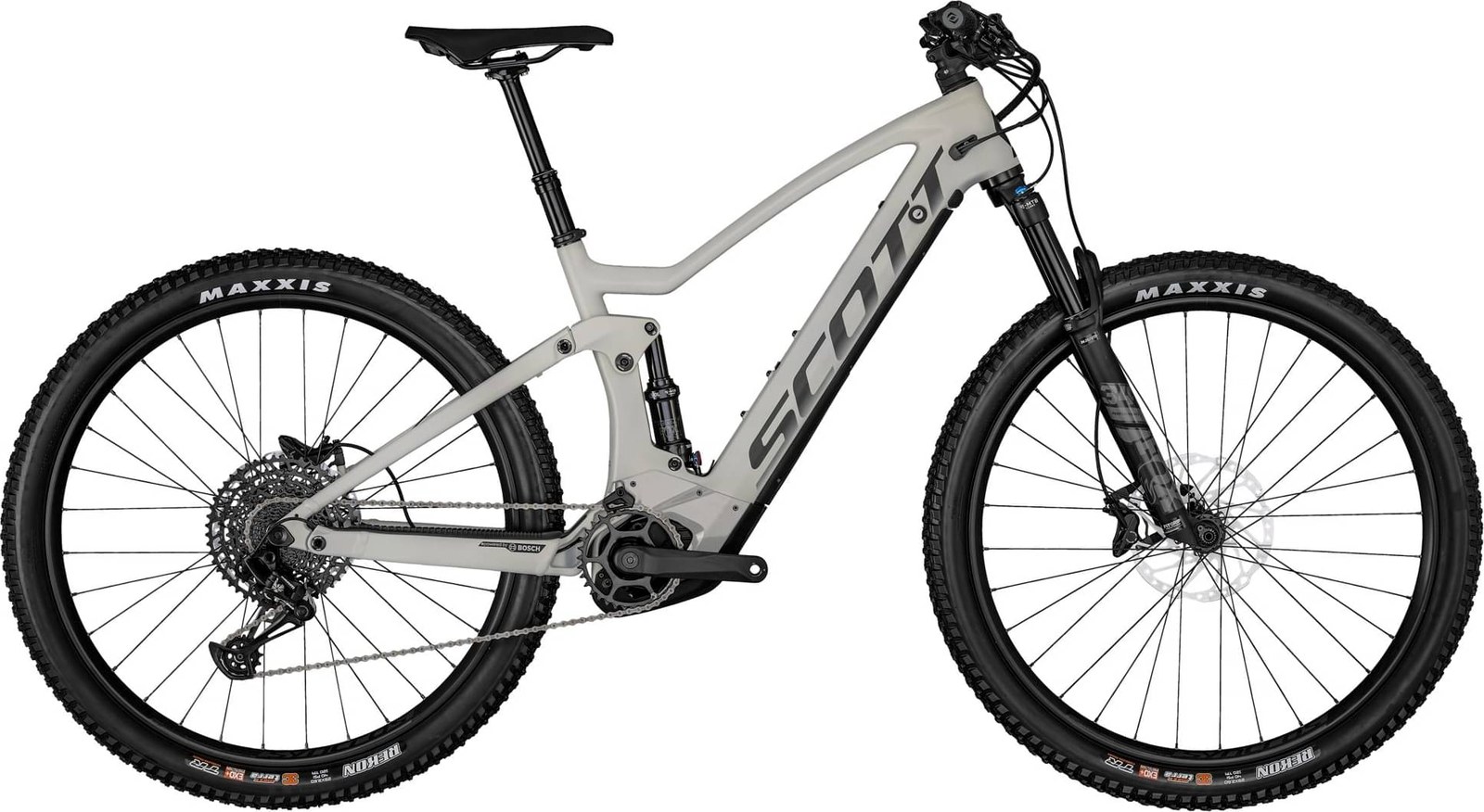

Scott Strike eRIDE 2023
From £4,999
EMTB Forums verdict
The 2023 Scott Strike eRIDE was the comfort-led trail eMTB in Scott's full-power range, built on a virtual 4-link frame with 140mm of travel front and rear and matched 29in wheels. Power came from the Bosch Performance Line CX Gen 4 (85Nm) fed by a removable PowerTube battery, 625Wh on the 910, 920 and 930 and 500Wh on the entry 940, all Range Booster ready. The signature feature was Scott's TwinLoc remote, switching the shock and fork between Lockout, Traction Control and Descend modes while a flip chip nudges the geometry between a higher and lower setting.
Trims ran from the carbon-framed flagship 910 with a Fox 34 fork and Shimano-grade kit, down through the alloy 920 and 930 to the value 940 on SRAM DB8 brakes. A separate Strike eRIDE EVO sub-line sat alongside it as a burlier 150mm enduro variant on a longer-travel fork and a larger battery, which is a different platform to the 140mm bike documented here.
This generation is now discontinued. Scott retired the Strike eRIDE name and folded its full-power trail duties into the later Genius eRIDE and Patron eRIDE lines.
