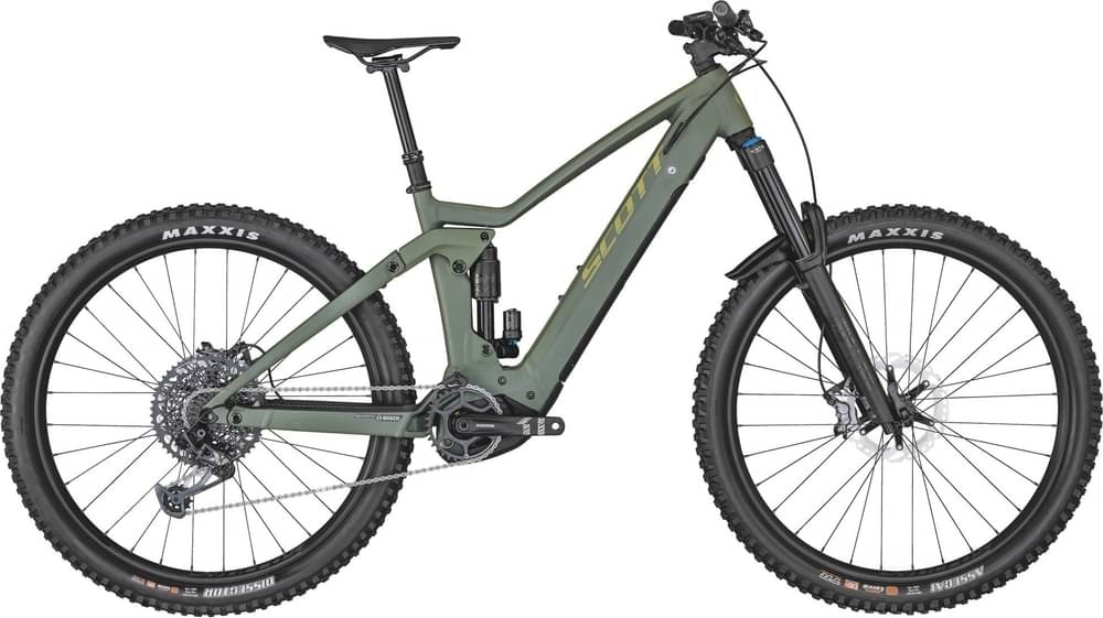

Scott Ransom eRIDE 2022
From £5,449
EMTB Forums verdict
The 2022 Ransom eRIDE was Scott's full-power electric enduro bike: an aluminium frame with 180mm of Virtual 4 Link (Horst-link) travel at both ends, 29in wheels, and Bosch's 85Nm Performance Line CX Gen 4 motor fed by a 625Wh PowerTube battery with the simple Purion display. A flip chip on the upper shock mount gave high and low settings and allowed mullet or full 27.5in wheel conversion.
The two-trim ladder was straightforward. The 910 (£6,499) paired a Fox 38 Performance Elite GRIP2 fork and Float X2 Performance shock with a SRAM X01/NX Eagle drivetrain and Shimano XT four-piston brakes on 203mm rotors, and was strong value for the money. The 920 (£5,449) swapped to a RockShox ZEB, a Shimano XT/Deore mix and MT520 brakes on the same frame, battery and suspension travel.
Geometry was stable rather than radical: a 64 degree head angle, long 465mm chainstays and roomy reach figures, though tall seat tubes and standover limited sizing up. BikeRadar rated the 910 at 3.5/5 in its 2022 eMTB Bike of the Year test, praising the intuitive handling and Bosch motor while criticising the fast-rolling EXO+ Dissector rear tyre.
The model is discontinued. It carried over into a near-identical 2023 range at higher prices before the line was dropped; the gravity end of Scott's e-bike range has since been taken over by the Voltage eRIDE.
