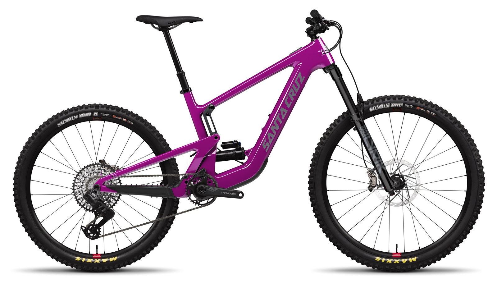

Santa Cruz Heckler SL
Santa Cruz
Heckler SL 2023
DiscontinuedLightweight · TrailLegacy · 1/10iFreshness 1/10
Lightweight VPP trail bike with quiet Fazua assistance
Motor
Fazua Ride 60 · 60Nm · 450W
Battery
Fazua 430 · 430Wh
Travel F/R
160/150mm
Wheels
MX (29F / 27.5R)
Frame
Full carbon
Weight
18.93 kg
Price
From £6,699
View the Santa Cruz Heckler SL on Santa Cruz’s site
Santa Cruz Heckler SL 2023
From £6,699
EMTB Forums verdict
The Heckler SL was Santa Cruz's first lightweight, mid-power e-bike and a deliberate break from the full-power Heckler that shares its name. A Fazua Ride 60 motor (60 Nm, 450 W peak) and an integrated 430Wh battery keep system weight down, so the lightest CC builds drop to around 18.9 kg. The payoff is a bike that pedals and handles much like a regular trail bike, with discreet assistance on tap through the Breeze, River and Rocket modes.
Underneath the e-system it is pure modern Santa Cruz: 150mm of lower-link VPP travel, a 160mm fork, mullet wheels and a slack 64.3 degree head angle in the High flip-chip setting (64.0 degrees, fractionally slacker, in Low). Five sizes (S to XXL) with semi size-specific chainstays make it easy to get fitted, and the flip chip lets you firm up the geometry slightly. The build ladder ran from the alloy-wheeled R at £6,699 to the Reserve carbon, SRAM Transmission XX AXS RSV at £11,999.
It is worth being clear that this is the lightweight Fazua SL, not the full-power Shimano EP8 Heckler that was sold alongside it. The 430Wh pack is integrated and not removable, though the frame is ported for the optional Fazua range extender if you want more reach.
This original 2023 Heckler SL has since been discontinued and superseded by later model years, so it now lives on mostly second-hand. For riders who want eMTB capability without full-power weight or assistance, it remains a genuinely well-rounded option.
