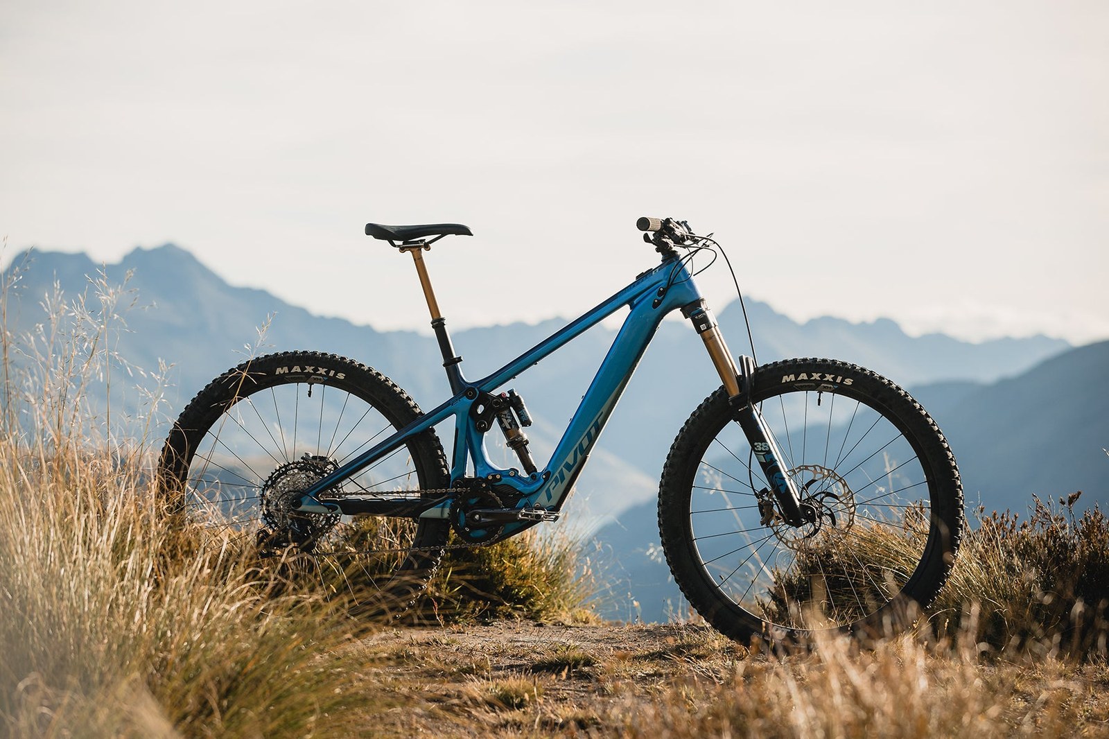

Pivot Shuttle LT 2024
EMTB Forums verdict
The 2024 Pivot Shuttle LT is the long-travel enduro member of Pivot's e-bike family, built around a full-carbon dw-link frame with 160mm of rear travel and a 170mm Fox 38 fork. For 2024 it gained the Shimano EP801 motor (85 Nm, 600 W peak), an integrated battery Pivot quotes at 756 Wh, and a flip-chip that switches between a High BB and a slacker Low BB setting (64.5 deg to 64.0 deg head angle).
Three builds were offered: the Ride SLX/XT on Fox Performance suspension and Shimano SLX/XT four-piston brakes, the Team XTR on Fox Factory kit and a full Shimano XTR group, and the range-topping Team Di2 with Fox Factory Float X2 and Shimano XT Di2 shifting. All three roll on DT Swiss hybrid 29in wheels with Maxxis Assegai EXO+ tyres front and rear, and big 220mm front and 203mm rear rotors. Pivot quotes a 22.5 kg claimed weight for the Team XTR build.
This model year is now discontinued and Pivot's later Shuttle LT moved to a Bosch drive system, so the EP801-powered 2024 bike represents the last Shimano-motor generation. UK pricing is no longer available as Pivot's former UK distributor Saddleback has ceased trading; figures here are US RRP and European RRP captured from Pivot's own 2024 pages.
