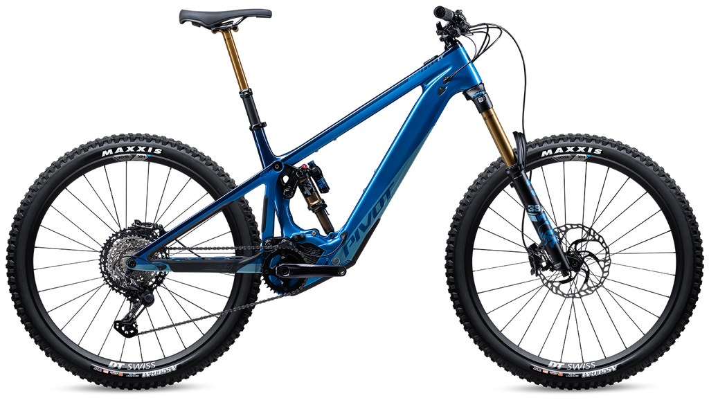

The 2023 Pivot Shuttle LT is a full-power 29er enduro eMTB and a carryover of the 2022 launch model. It pairs a full-carbon dw-link chassis with 160mm of rear travel and a 170mm Fox 38, drawing directly on Pivot's EWS-proven Firebird. A flip chip lets you raise the bottom bracket and steepen the head angle by half a degree, but in its Low setting the head angle sits at 64.5 degrees with a long 1307mm wheelbase on the XL, so it is built to descend.
Power comes from a Shimano EP8 (DU-EP800) drive unit delivering 85Nm of torque, 250W continuous and 500W maximum, fed by a sizeable 756Wh battery integrated into the downtube with USB-C charging. The Deore XT Di2 build steps up to the EP801 motor, which keeps the same torque but lifts peak power to 600W to enable FREE SHIFT and AUTO SHIFT, while the mainstream Ride SLX/XT and Team XTR builds use the standard EP8. Maxxis Assegai EXO+ tyres, a 220mm front and 203mm rear rotor, and a full-size bottle inside the front triangle round out a sensible enduro package.
Three builds were offered: Ride SLX/XT (GBP 9,350), Team XTR (GBP 12,350) and the range-topping Team Di2 (USD 10,499, no UK RRP captured). It was always a premium proposition, with prices to match, and Pivot quoted the Team XTR at a claimed 22.5kg.

Bike geometry diagram
SMLXL
Reach449 mm471 mm491 mm514 mm
Stack631 mm640 mm649 mm658 mm
Seattube370 mm400 mm430 mm470 mm
Chainstay439 mm439 mm439 mm439 mm
Headtube Angle64.5°64.5°64.5°64.5°
Seattube Angle (eff)77°77°77.5°78°
Wheelbase1229 mm1245 mm1281 mm1307 mm
Headtube110 mm120 mm130 mm140 mm
BB Height357 mm357 mm357 mm357 mm
Standover694 mm698 mm700 mm701 mm
Front Centre790 mm*806 mm*842 mm*868 mm*
FC:RC1.801.841.921.98
