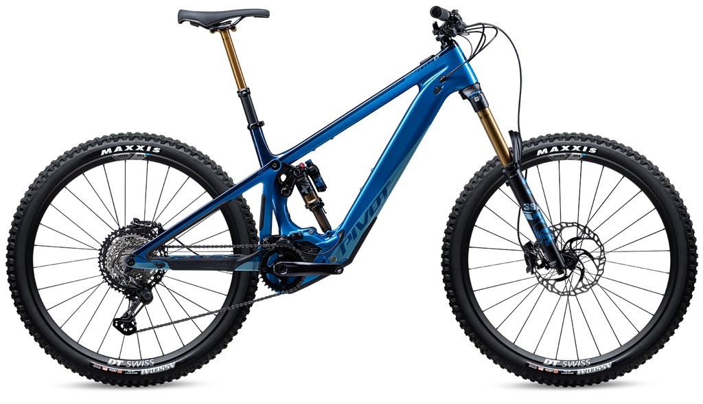

Pivot Shuttle LT 2022
EMTB Forums verdict
The 2022 Pivot Shuttle LT was Pivot's long-travel full-power enduro eMTB, launched in July 2022 under the tagline 'a bird with bigger wings' and built on the geometry and dw-link kinematics of the EWS-proven Firebird 29. The full-carbon chassis carries 160mm of dw-link rear travel and a 170mm Fox 38 fork with a custom eMTB tune, paired with a trunnion-mounted Fox Float X shock. A flip chip switches between a High BB setting (64.5 degree head angle) and a Low BB setting that drops the bottom bracket and slackens the head angle to 64.0 degrees.
Power comes from a Shimano EP8 (DU-EP800) drive unit delivering 85Nm of torque, fed by an integrated, removable 756Wh battery with a USB-C charging port. Pivot billed it as having the biggest battery and most powerful motor in its e-bike range at the time. All four sizes clear a full-size water bottle inside the front triangle and run high-grip Maxxis Assegai EXO+ 3C tyres on both wheels, with 223mm front and 203mm rear rotors.
Two builds were offered. The Ride SLX/XT (9,899 USD / 9,999 EUR) mixes a Fox Performance 38, Fox Performance Float X, Shimano SLX/XT 12-speed and DT Swiss H1900 wheels. The range-topping Team XTR (11,999 USD / 11,999 EUR) steps up to a Fox Factory 38 GRIP2, full Shimano XTR M9100, an XT M8150 E-MTB crank, DT Swiss HX1501 wheels and a carbon Phoenix Team cockpit. No UK GBP RRP was published for the 2022 model at launch.
This model is discontinued. It was carried into 2023 largely unchanged before Pivot later relaunched the Shuttle LT on a Bosch drive system, so this Shimano EP8 carbon Shuttle LT is now a first-generation, outgoing bike.

Bike geometry diagram
Flip-chip position
geometry changes with the chip
SMLXL
Reach449 mm471 mm491 mm514 mm
Stack631 mm640 mm649 mm658 mm
Seattube370 mm400 mm430 mm470 mm
Chainstay439 mm439 mm439 mm439 mm
Headtube Angle64.5°64.5°64.5°64.5°
Seattube Angle (eff)77°77°77.5°78°
Wheelbase1229 mm1245 mm1281 mm1307 mm
Headtube110 mm120 mm130 mm140 mm
BB Height357 mm357 mm357 mm357 mm
Standover694 mm698 mm700 mm701 mm
Front Centre790 mm*806 mm*842 mm*868 mm*
FC:RC1.801.841.921.98
