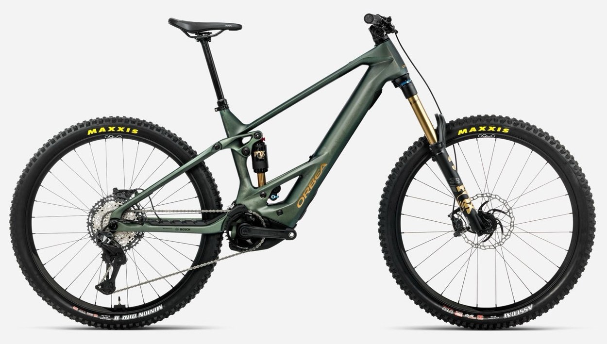

The Orbea Wild 2026 is Orbea's carbon enduro flagship and one of the most credible Bosch CX Gen 5 platforms on sale. Headline numbers: 170mm fork, 170mm rear, Bosch Performance Line CX Gen 5 at 120Nm and 750W peak with a 2.8kg motor mass, a 750Wh battery, 63.5 degree head angle and reach 435 to 505mm across S, M, L and XL. With top trims running the Bosch CX-Race motor variant for race-tuned mode mapping. The community read is positive: @mmcengineer reports the 2025 carbon Wild feels noticeably lighter than the previous aluminium frame, and @NVRider calls it "a beast: stable, planted, bump-absorbing: better for riding fast over rocks/roots".
Drive system and range. The Bosch Performance Line CX Gen 5 is the headline. 120Nm of torque, 750W peak and Bosch's PU2.0 firmware. Top trims pair the CX-Race variant for race-tuned mode mapping. The 750Wh battery is integrated through the downtube. @Spiff notes the Orbea Wild's diagonal tube design supports adding a Bosch PowerMore 250Wh range extender via a 44 euro Orbea interposer plate, taking the package to 1,000Wh effective. Real-world range on 750Wh sits at two to three hours of mixed alpine riding with 1,500 to 2,000m of vertical achievable for typical riders. Bosch's Flow app, Kiox 300 display and OTA firmware updates are all standard.
Geometry and handling. 63.5 degrees up front is properly slack for enduro use. Reach steps cleanly: 435 (S), 455 (M), 480 (L), 505 (XL). Chainstays are a uniform 448mm and wheelbase tops out at 1311mm on XL. The package matches the Wild's enduro brief: confident on steeps, stable on fast rough terrain, balanced through tight switchbacks.
Build and value. The gold spec lists one base trim. Orbea historically offers the Wild in multiple trims via the MyO custom-builder, where buyers configure fork, shock, drivetrain, brakes and finishing kit individually. @Mr.G confirms the 2026 Wild M10 ships with SRAM Maven Silver brakes (HS2 220mm front, 200mm rear rotors) and Kashima-coated Fox suspension front and rear on the L size: a serious flagship spec sheet. Standout: MyO custom build configurator. Questionable: integrated battery and PowerMore extender interface require an Orbea interposer plate.
Community-verified strengths.
  • Carbon frame feel. @mmcengineer calls the 2025 carbon "noticeably lighter" than the previous aluminium frame.
  • Descending composure. @NVRider rates the Wild as "stable, planted, bump-absorbing... better for riding fast over rocks/roots".
  • Top-trim spec. @Mr.G reports the M10 with SRAM Maven Silver brakes (220/200mm HS2 rotors) and Kashima Fox suspension: flagship-grade kit.
  • Range extender supported. @Spiff documents the Orbea interposer plate (44 euro) that lets owners fit the Bosch PowerMore 250Wh extender.
Caveats and known gripes.
  • DVO suspension incompatibility. @Abildgaard reports 2022-current Wild frames are incompatible with DVO shocks because the compression knob interferes with the lower frame cross-beams.
  • PowerMore extender requires interposer. @Spiff flags the standard PowerMore mounting interferes with the diagonal tube; the 44 euro Orbea interposer plate fixes it.
  • Seatpost insertion limit. A poster references the Orbea tech manual noting the size M Wild has a 310mm maximum seatpost insertion depth, which limits dropper choice for taller riders on M frames.
  • Direct-sale service variance. @Robson reports a poor IBKBIKE service experience on an Orbea Wild Shimano hub defect, where the dealer redirected the customer to Shimano directly.
  • Four sizes only. No XS or XXL; riders under 1.65m or over 1.95m should fit-check.
Verdict. The 2026 Wild is one of the most polished Bosch CX Gen 5 carbon enduro platforms on sale, with proper 170/170mm travel, modern slack geometry, MyO custom-build flexibility and a route to 1,000Wh effective range via the PowerMore extender. It suits riders who want a carbon enduro tool with Bosch's mature ecosystem and Orbea's custom-build configuration. Buyers needing DVO suspension compatibility, a removable battery without interposers or wider XS/XXL sizing should look at the Specialized Kenevo, Trek Rail Plus or Whyte E-180. Production status: current.

Bike geometry diagram
SMLXL
Reach435 mm455 mm480 mm505 mm
Stack625 mm634 mm643 mm652 mm
Chainstay448 mm448 mm448 mm448 mm
Headtube Angle63.5°63.5°63.5°63.5°
Seattube Angle (eff)77.5°77.5°77.5°77.5°
Wheelbase1228 mm1252 mm1282 mm1311 mm
Headtube110 mm120 mm130 mm140 mm
BB Height358 mm358 mm358 mm358 mm
Front Centre780 mm804 mm834 mm863 mm
Trims · 2
M-Team
£8,999
M-LTD
£10,999
MotorBosch Performance Line CX Gen 5 · 120 Nm · all trims
Battery750 Wh · all trims
Travel F/R170/170 mm · all trims
FrameCarbon · all trims
ForkFox 38 Float Factory 170, Grip X2, QR15x110, Kashima · all trims
ShockFox Float X2 Factory Trunnion 2-Pos Adjust Kashima custom tune 205x65mm · all trims
HeadsetAlloy 1-1/2", Black Oxidated Bearing · all trims
StemOC Mountain Control MC11 Alu SL, 0º · all trims
HandlebarOC Mountain Control MC10 Carbon, Rise 20, Width 800 · all trims
SaddleFizik Aidon 208x145mm manganese railFizik Terra Aidon X1 145mm
SeatpostOC Mountain Control MC22, 31.6mm, DropperOC Mountain Control MC10, 31.6mm, Dropper
BrakesShimano XT 8220 Hydraulic DiscShimano XTR 9220 Hydraulic Disc
Rear derailleurShimano XT M8260 SGSShimano XTR M9260 12s
Cranke*thirteen Helix Coree*thirteen Helix Race Carbon
ShiftersShimano XT M8250Shimano XTR M9250
CassetteShimano CS-M8200 10-51t 12-SpeedShimano CS-M9200 10-51t 12-Speed
ChainShimano M8100Shimano CN-9100
DrivetrainShimano XT M8250 12-speedShimano XTR M9250 12-speed
WheelsOquo Mountain Control MC32TEAM POWEROquo Mountain Control MC32LTD POWER
TyresFront: Maxxis Assegai 2.50" 60TPI 3CG/EXO+/TR MaxxGrip; Rear: Maxxis Minion 2.40" 120 TPI 3CT/DD/TR MaxxTerra · all trims
Weight23.92 kg
Price£8,999£10,999
