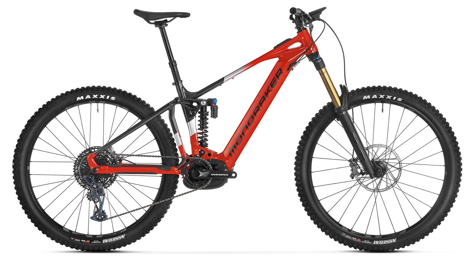

Mondraker Level 2024
From £5,999
EMTB Forums verdict
The 2024 Mondraker Level is the previous-generation, full-power super-enduro eMTB in the range, built around a 6061 aluminium Stealth Evo frame running Mondraker's Zero Suspension System with 180mm up front and 170mm at the rear on full 29in wheels. Power comes from the Bosch Performance Line CX Gen 4 Smart System motor (85Nm) fed by a 750Wh Bosch PowerTube battery, putting it firmly in the heavy, long-range, descent-focused camp at roughly 26 to 27kg.
Geometry is long and slack across the board: a 65-degree head angle, 76.5-degree effective seat angle and reach growing from 450mm on the SM to 510mm on the XL, with consistent 455mm chainstays and a 357mm BB height. It is a stable, planted platform aimed at fast, rough enduro terrain rather than playful trail riding.
The three trims share the frame and geometry but climb steadily in kit. The R (£5,999) runs a RockShox ZEB coil and SRAM DB8 brakes, the RR (£6,999) steps up to a FOX FLOAT 38 Factory fork, DHX2 coil and Code Bronze stoppers, while the flagship XR (£8,499) gets Öhlins RXF 38 M.2 and TTX22 M.2 suspension, Code Silver brakes and a 10-52T GX Eagle drivetrain. All three roll on e*thirteen e*Spec alloy wheels with Maxxis Assegai DH-casing tyres.
