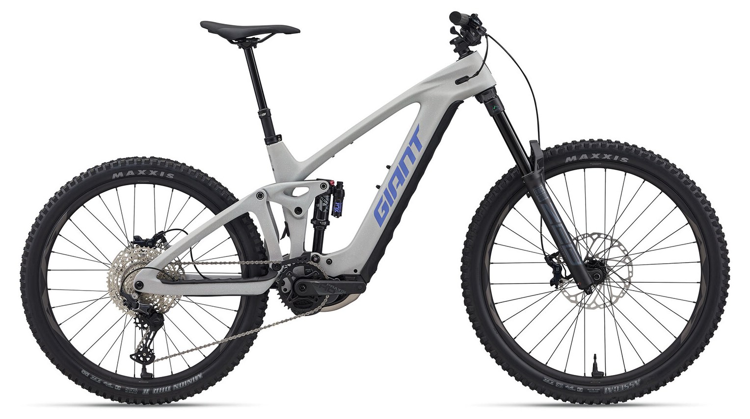

The Giant Reign E+ 2026 is Giant's enduro-class full-power eMTB, refreshed for 2026 around an aluminium Maestro chassis with 170 mm of fork travel and 160 mm rear. Headline numbers: a claimed 24.9 kg system weight, a 63.7 to 64.5 degree adjustable head angle and a 425 to 520 mm reach range spread across an unusually deep twelve-size geometry table that mixes flip-chip high and low settings with three full size points. £7,499 entry price for the base trim. Community verdict: a serious, agile, mullet-ready enduro chassis with deep size and geometry choice that has finally caught up with the gravity riders Giant always wanted to court.
Drive system and range. Giant's Syncdrive motor system is custom-spec'd by Shimano, and the 2026 generation introduces the new Syncdrive Race motor at 90 Nm on a 48 V architecture. The 2026 carbon frame option carries an integrated 560 Wh main pack plus a 280 Wh range extender, which Giant package as a single 840 Wh system. The aluminium base trim runs the standard 625 Wh PowerTube-compatible pack. Long-term Reign E+ owners report mid-mode average draw around 103 to 112 Wh per hour, with peak draw on Turbo of 207 to 217 Wh per hour, which puts a 625 Wh tank well into 5 hour-plus all-day territory in mixed assist. Bluetooth firmware updates via Giant's Ride app keep the motor refined.
Geometry and handling. The 12-size geometry table is a standout: SM, MD, LG and XL each get high and low flip-chip options, plus three intermediate S, M and L sizes. Reach grows from 425 mm to 520 mm. Head angles range 63.7 to 64.5 degrees depending on flip-chip setting, with the low setting putting the front end into seriously slack enduro territory. Chainstays sit between 448 and 457 mm and grow with size, which is a sensible modern approach that gives bigger riders proportional rear centres. Wheelbases span 1209 to 1328 mm. The Reign runs MX out of the box (29 front, 27.5 rear) for snappy direction change, with the option to convert to full 29 via the flip chip.
Build and value. The base trim at £7,499 brings the Syncdrive Race motor, 24.9 kg system weight, Maestro suspension and Giant's in-house spec, with detailed component-level info available through dealer channels. The standout strength is the geometry table breadth, which lets buyers match frame size and ride feel precisely. The questionable note is that the carbon range-extender 560+280 Wh build is reserved for higher trim levels above the base price, so buyers wanting all-day range on the aluminium chassis may need to look at aftermarket battery options or upgrade to the carbon variant.
Community-verified strengths. Long-term 2022-onwards Reign E+ owners praise the chassis stability, mullet-setup agility and how the Maestro suspension handles big hits at speed. Owners running 4,500 km plus mileage report battery health still at 94 per cent and motor reliability strong, even in Scottish wet conditions. The bike is repeatedly highlighted as more agile than its weight suggests, with the MX setup giving the rear end a playful feel. Component reliability of the Syncdrive (Shimano-built) drive has held up well across multi-year ownership reports.
Caveats and known gripes. The speed sensor (Giant Integrated 4430-FSJISS-01) has historically been the most common failure point across earlier generations, taking owners three seasons of troubleshooting before identification. A separate community-flagged issue is a cosmetic frame crack above the motor caused by filler cracking, replaced under warranty by Giant UK. The non-removable integrated battery on the 2026 carbon trim has divided opinion: some owners welcome the cleaner aesthetics while others want the option of off-bike charging. Range extender adds bulk and complexity if you do want bigger capacity.
Verdict. The Reign E+ 2026 suits the enduro and bike-park rider who wants Giant's mullet-ready Maestro chassis with seriously deep geometry options, proven Shimano-built Syncdrive Race drive and strong UK dealer support, at a mid-trail price point. Riders chasing DJI Avinox-level peak power, removable batteries on the carbon frame or boutique finish should look at the Amflow PX Carbon Pro, the Specialized Kenevo or the Mondraker Crafty. Production status: current.
