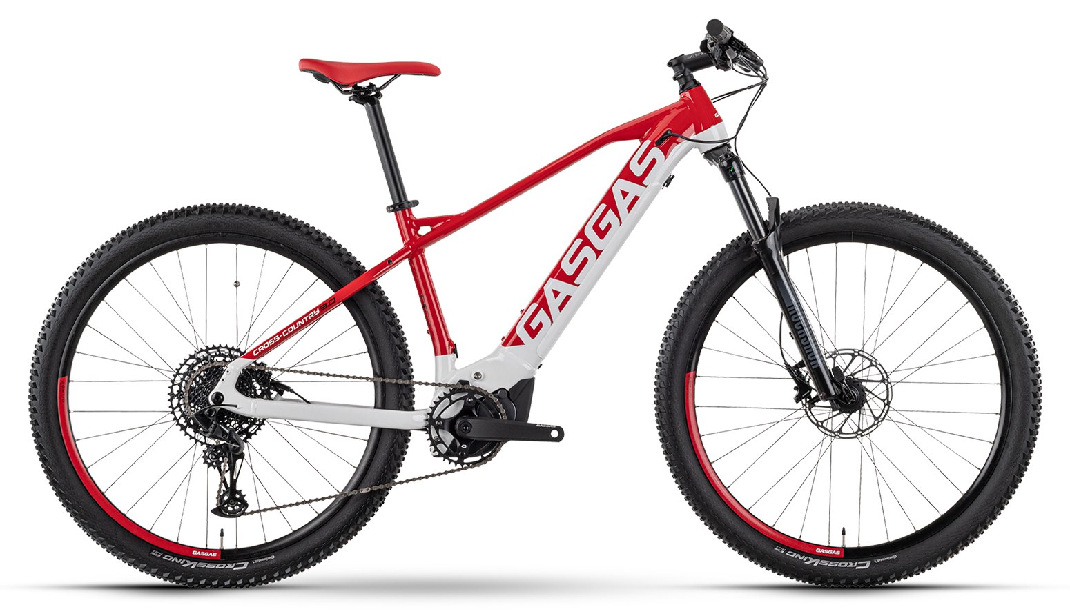

EMTB Forums verdict
The GasGas G Cross Country is the brand's entry-level hardtail e-MTB, a budget skill-builder rather than a trail weapon. All three 2025 trims share an aluminium 6061 frame, GasGas finishing kit and a 720mm bar, and lean on Yamaha motors paired with conservative XC-leaning geometry: a 67-degree head angle and 74-degree seat angle on the 29-inch 2.0 and 3.0, and a steeper 69-degree head angle on the smaller 27.5-inch 1.0.
The £2,699 G Cross Country 3.0 is the pick of the range and the only one worth the spend over its sibling. For the same money as the 2.0 it brings a 120mm RockShox 35 Silver TK air fork in place of the SR Suntour coil unit, the stronger 85Nm Yamaha PW-X3 motor instead of the 70Nm PW-ST, a wider-range 12-speed SRAM SX Eagle drivetrain (11-50T) versus the 2.0's 9-speed Tektro, and it is lighter at a claimed 23.2kg against 23.9kg. Both run the 630Wh Simplo battery, Continental Cross King 29x2.3 tyres and 180mm rotors. At identical pricing the 3.0 is the clear choice.
The £1,599 G Cross Country 1.0 sits in a different bracket: 27.5-inch wheels, a 100mm coil fork, an 8-speed Tektro drivetrain, a detuned 50Nm Yamaha PW-CE motor and a smaller 400Wh external battery. It is the lightest at 21.9kg and aimed squarely at smaller or first-time riders. With no rear suspension and modest forks across the line, this is a confidence-building commuter-and-light-trail platform, not a bike for technical descents.

Bike geometry diagram
Flip-chip position
geometry changes with the chip
SMLXL
Reach400 mm420 mm440 mm460 mm
Stack626 mm630 mm636 mm665 mm
Seattube400 mm450 mm500 mm550 mm
Chainstay465 mm465 mm465 mm475 mm
Headtube Angle69°69°69°67°
Seattube Angle (eff)74°74°74°74°
Wheelbase1136 mm1156 mm1176 mm1233 mm
Headtube120 mm125 mm130 mm140 mm
BB Height319 mm
Front Centre671 mm*691 mm*711 mm*758 mm*
FC:RC1.441.491.531.60
