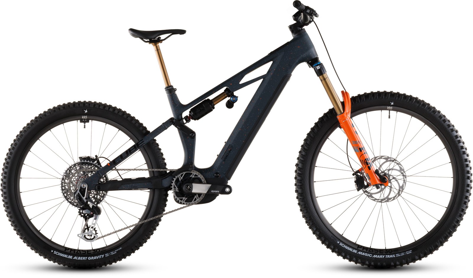

Cube Stereo Hybrid ONE77 HPC 2026
From £3,999
EMTB Forums verdict
The Stereo Hybrid ONE77 HPC is Cube's big-hitting carbon enduro eMTB: 170mm of travel front and rear, a mullet wheel set-up (29in front, 27.5in rear) and the latest 120Nm Bosch Performance Line CX drive fed by an 800Wh PowerTube battery. The HPC carbon front triangle pairs with an alloy rear, and every build carries the angle-adjustable ACROS headset, so you can switch between a slacker 63.8 degree and a more moderate 64.4 degree head angle to suit the trail.
The five-trim ladder is unusually broad. The RACE opens the range at 3999 GBP on a SR Suntour Aion fork, Magura Louise brakes and a Shimano Deore/XT mix; step up through the SLX (4499 GBP, Fox 38 Rhythm and Shimano XT) and the TM (5499 GBP, Fox 38 Factory, SRAM GX AXS Transmission and Maven brakes). The AT at 6499 GBP adds Shimano XT Di2 and Bosch ABS Pro, while the flagship SLT (7999 GBP) tops it off with the Bosch CX-R race drive, SRAM XX AXS Transmission, Magura Gustav Pro brakes, Newmen carbon wheels and a Fox Transfer Factory dropper. Claimed weights climb from 23.8kg on the SLT to 25.4kg on the RACE.
Geometry is consistent across the four frame sizes: a 443mm chainstay throughout, reach from 427mm (S) to 506mm (XL) in the slack setting, and a 76.7 degree effective seat angle for a planted climbing position. With UDH dropout, a direct-mount chain guide and fully integrated cable routing, it is pitched squarely at riders who want a long-travel, big-battery machine for sustained mountain descents rather than featherweight efficiency.
