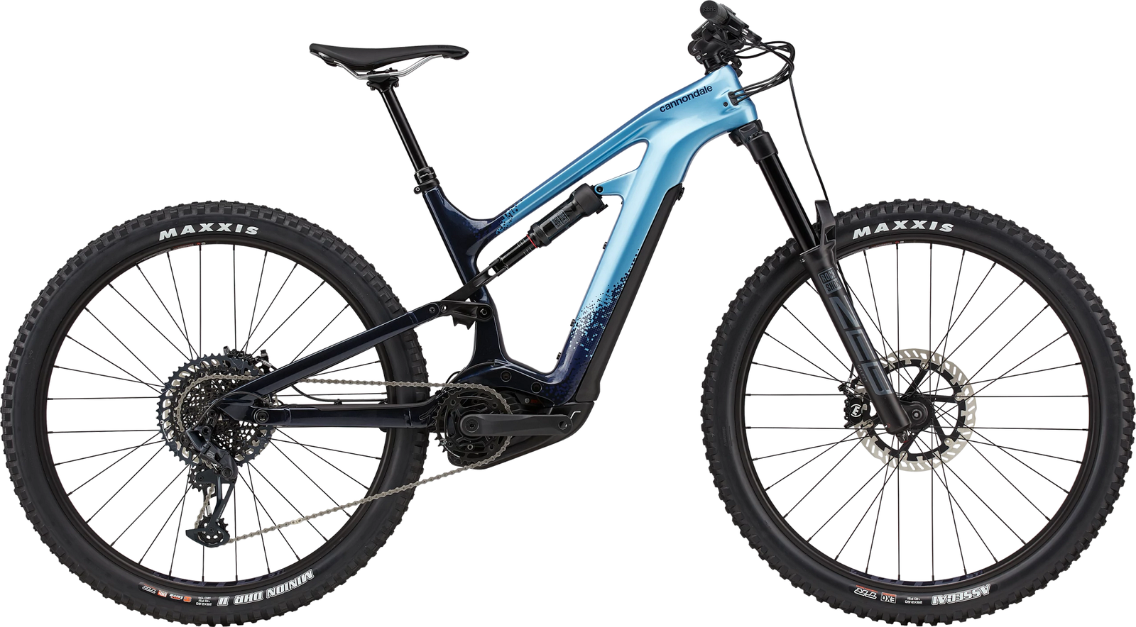

EMTB Forums verdict
The 2022 Cannondale Moterra Neo is a full-suspension e-mountain bike range, now discontinued, that split into two distinct frames in this model year. The flagship Carbon models (Carbon 1 at 8,200 GBP, Carbon 2 at 7,000 GBP) use a BallisTec carbon front triangle with an alloy swingarm, 160mm of travel at both ends, a RockShox Zeb fork and a Bosch Performance Line CX motor fed by a 625Wh PowerTube. The alloy models (Neo 3, 4, 5 and the rack and mudguard equipped EQ) drop to a 150mm SmartForm frame on Bosch 750Wh or Shimano power.
Spec scales cleanly with price. Carbon 1 gets a SRAM X01/GX Eagle mix, Magura MT7 brakes on 220/203mm rotors and a RockShox Zeb Ultimate; Carbon 2 keeps the Zeb but steps to Magura MT5 brakes and an NX/GX drivetrain. Among the alloy bikes, the 5,750 GBP Neo 3 pairs a 750Wh Bosch system and Kiox 300 display with a RockShox Yari and Shimano four-piston brakes, the 5,000 GBP Neo 4 runs a Shimano EP8 with a 630Wh pack, and the 4,000 GBP Neo 5 is the entry point on a Shimano E7000 and 504Wh battery. The EQ adds a 750Wh Bosch system, integrated rack and fender mounts and a coil fork for utility riding.
Geometry across both frames is modern but not extreme: a 65 degree head angle, a 77 degree effective seat angle and a 455mm chainstay on most sizes, with Cannondale's Proportional Response tuning the suspension kinematics per size. The carbon frame is slightly longer in reach (435 to 520mm S to XL) than the alloy (428 to 510mm), and the small size runs a mullet 27.5in rear wheel on both. As a discontinued bike this is now a used or old-stock buy, and we hold no owner ride-feel data for it, so the notes above are spec-based only.
