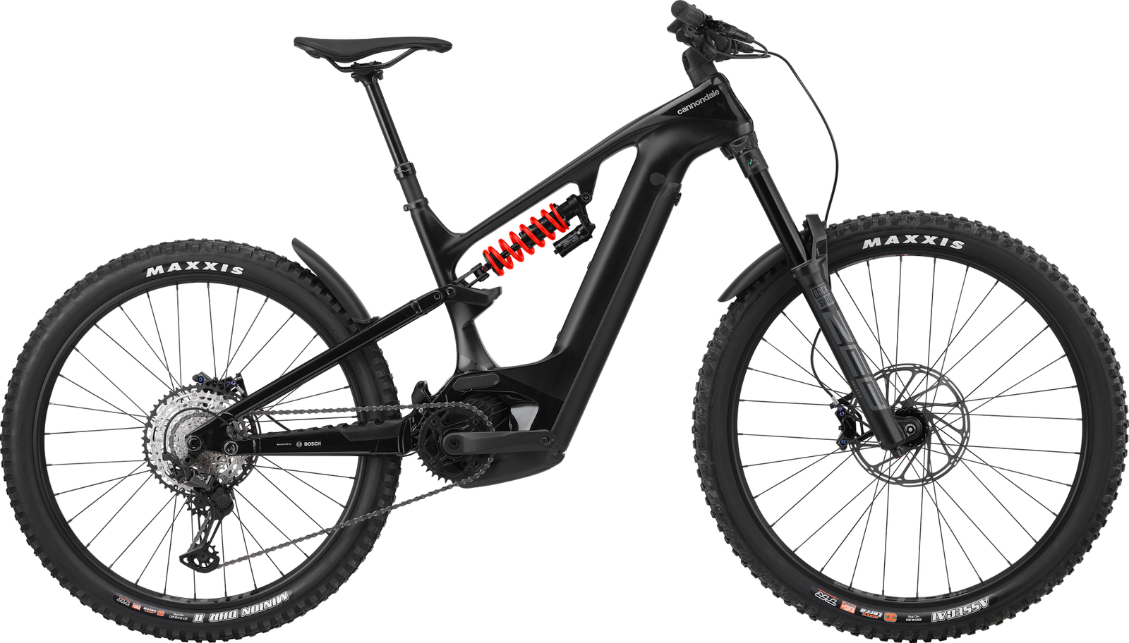

The Cannondale Moterra Neo LT 2024 is the longer-travel sibling to the standard Moterra Neo, a carbon front triangle with SmartForm C1 alloy swingarm, built around the Bosch Performance Line CX Gen 4 motor and a 750 Wh PowerTube battery. Headline numbers: 170 mm fork, 165 mm rear travel, Bosch CX Gen 4 at 85 Nm, 750 Wh removable PowerTube, a 64.0 degree head angle, reach 430 to 505 mm across S to XL, 452 mm fixed chainstay, 26.51 kg claimed and £7,250 for the Carbon LT 2 trim. Production status is discontinued, replaced in the Cannondale line by the lighter, slacker Moterra SL platform. The community verdict, drawing on the Carbon LT 1 ownership thread from @Wiltshire Warrior, is that the LT is a properly capable mullet enduro chassis that takes upgrades well, with mullet-or-29er flexibility and dual-battery support.
Drive system and range. The Bosch Performance Line CX Gen 4 delivers 85 Nm of torque. The 750 Wh PowerTube is removable from the down tube. @Amber Valley Guy reports an earlier-generation 2023 Moterra EP8 sibling running "4500 miles with zero motor or battery issues", although noting earlier EP8 generations had "hit-or-miss quality control". The 750 Wh pack delivers comfortably 45 to 60 km of real-world enduro riding depending on assist mode and elevation gain. Powermore range extender compatibility is supported but requires a configuration file update from a Cannondale-authorised dealer per @Spiff, and physical fitment is constrained by the diagonal-tube bottle cage position requiring "90 mm clearance below lower mounting screw".
Geometry and handling. The 64.0 degree head angle is bang on enduro norm. Reach progresses 430, 453, 476 and 505 mm across S to XL with a fixed 452 mm chainstay and wheelbase scaling 1235 to 1330 mm. The mullet 29 front / 27.5 rear setup is standard, though @Wiltshire Warrior's upgraded LT1 supports "mullet and 29er front wheel options". The 452 mm chainstay is on the longer side for an enduro chassis and biases the bike toward climbing stability and front-wheel grip rather than tail-end agility.
Build and value. Single Carbon LT 2 trim documented at £7,250 with 26.51 kg claimed. Build sheet is RockShox ZEB Select Charger RC 170 mm fork, RockShox Deluxe Select+ Coil rear shock with 2-position lever (a standout feature for this price), SRAM Code R brakes with 220 mm front and 200 mm rear CenterLine rotors, and a Shimano SLX/XT mixed 12-speed drivetrain. Standout choice is the coil shock as standard: most rivals at this price specify air shocks, and the coil delivers superior bump compliance on technical enduro descents. Questionable is the discontinued status: 2024 stock is now end-of-line and discounting is likely.
Community-verified strengths. First, the chassis takes high-end upgrades well: @Wiltshire Warrior's LT1 build documents a transformative move to a "RS Silver 29 160 mm fork" that "transformed rollover ability". Second, the wheel-size flexibility (mullet or full 29er front) and dual-battery support (500/400 Wh on earlier generations, 750 Wh on this trim) make the platform versatile. Third, the coil shock specification and 220 mm front rotor on the LT 2 trim are properly serious enduro kit at this price.
Caveats and known gripes. Motor reliability has historic flags. @Wiltshire Warrior's LT1 needed a "refurbished motor at 900 miles", a real cost-of-ownership note. Powermore range extender fitment is restricted per @Spiff, with mechanical interference at the diagonal-tube bottle cage. The 26.51 kg weight is heavy in the 2024 enduro market and considerably heavier than the Moterra SL replacement (19.5 kg). The bike is discontinued: warranty support continues via Cannondale dealers but new-stock availability is dwindling. Crank arm cap and chainring nut torque settings need attention out of the box per @Spiff's sister-bike service notes (40 Nm and 35 Nm respectively, often factory-fitted below spec).
Verdict. The Moterra Neo LT 2024 is discontinued but remaining stock continues to ship through Cannondale dealers. Buy it if you want a 170/165 mm carbon-front-alloy-rear mullet enduro with the Bosch Performance Line CX Gen 4 motor, a 750 Wh removable battery and a coil shock as standard, you can find dealer stock at a discount, and you have access to Cannondale service support. Look elsewhere if you want a sub-23 kg lightweight chassis, the latest 2025/2026 platform (Moterra SL replaces this), or you cannot live with the 26.51 kg full-power weight. The LT 2024 remains a credible enduro tool at a discount, but the platform's days are clearly numbered.

Frame
Moterra Carbon front triangle with SmartForm C1 alloy swingarm, 27.5 inch rear / 29 inch front mullet wheels, 170mm fork / 165mm rear travel, Proportional Response Tuned Suspension, removable downtube battery, alloy skid plate.

Trims · 1
Carbon LT 2
£7,250
MotorBosch Performance Line CX Gen 4 · 85 Nm
BatteryBosch PowerTube 750 · 750 Wh
Travel F/R170/165 mm
FrameCarbon
ForkRockShox Zeb Select Charger RC 170mm DebonAir 15x110 44mm offset
ShockRockShox Deluxe Select+ Coil 2-Pos
HeadsetAcros integrated sealed bearing, tapered
StemCannondale 2, 6061 Alloy, 35mm, 0 degree
HandlebarCannondale 3 Riser, 6061 Alloy, 25mm rise, 8 degree sweep, 800mm
GripsFabric FunGuy
SaddleFabric Scoop Shallow Sport, steel rails
SeatpostCannondale DownLow Dropper, internal routing, 31.6mm, 125mm (S) / 150mm (M-XL)
BrakesSRAM Code R hydraulic 220/200mm
Rear derailleurShimano XT
CrankFSA Bosch E-bike crank, 55mm chainline, 160mm, 34T
ShiftersShimano SLX, 12-speed
CassetteShimano SLX, 10-51, 12-speed
ChainShimano SLX, 12-speed
DrivetrainShimano XT/SLX 12-speed FSA Bosch 34T 160mm 10-51
WheelsWTB ST i30 TCS; Formula F hub, Shimano MT410 R
TyresMaxxis Assegai 29x2.6 (F) / DHR II 27.5x2.6 (R)
Weight26.51 kg
