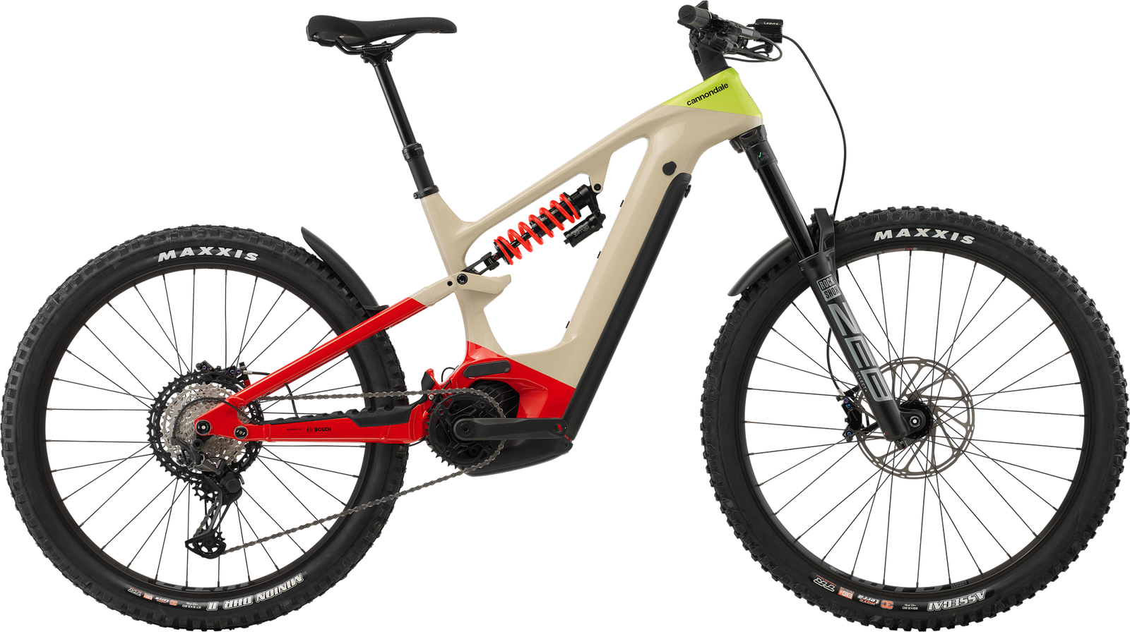

Cannondale Moterra Neo LT 2023
From £7,250
EMTB Forums verdict
The Moterra Neo LT was Cannondale's long-travel (LT = Long Travel) take on its Moterra Neo platform: a mixed-wheel enduro eMTB with 170mm up front from a RockShox Zeb and 165mm out back via a coil-sprung Deluxe Select+ shock. That is a clear step beyond the 150/150mm air-sprung base Moterra Neo, pushing the LT firmly into burly, descent-focused enduro territory rather than do-it-all trail riding.
Power came from the Bosch Performance Line CX Gen 4 motor (85Nm, up to 340 percent assist) fed by Bosch's largest 750Wh PowerTube, removable for off-bike charging and managed through a Kiox 300 display. The carbon-front, alloy-swingarm chassis used Cannondale's Proportional Response suspension, giving each frame size its own kinematics. Two carbon trims were sold: the Carbon LT 1 (Shimano XT, SRAM Code RSC brakes) and the Carbon LT 2 (XT mech with SLX shifting and Magura MT5 brakes).
Geometry was deliberately middle-of-the-road for the class, with a 64 degree head angle and 76.5 degree effective seat angle, but it stood out for its long 452mm chainstays (constant across all sizes) and a notably tall bottom bracket. That makes it a planted, sure-footed climber and a stable high-speed descender at the expense of playfulness, and the coil-equipped LT 2 was the heaviest bike in some group tests of its era.
The Moterra Neo LT has since been discontinued and superseded by Cannondale's latest Moterra range, which moved to the Bosch Performance Line CX Gen 5 (Smart System) motor. As a used buy it remains a capable long-travel, big-battery mile-cruncher for riders who prioritise stability and range over flickability.

MotorBosch Performance Line CX Gen 4 · 85 Nm · all trims
BatteryBosch PowerTube 750 · 750 Wh · all trims
Travel F/R170/165 mm · all trims
FrameCarbon front triangle, SmartForm C1 alloy swingarm · all trims
ForkRockShox Zeb Select, Charger RC, 170mm, DebonAir, 15x110mm, 44mm offset · all trims
ShockRockShox Deluxe Select+, Coil, 2-position mode adjust, adjustable rebound, 165mm travel · all trims
HeadsetAcros integrated sealed bearing, tapered · all trims
StemCannondale 2, 6061 alloy, 35mm, 0 degree · all trims
HandlebarCannondale 3 Riser, 6061 alloy, 25mm rise, 8 degree sweep, 800mmHollowGram SAVE riser bar, carbon, 35mm clamp, 30mm rise, 8 degree sweep, 780mm
GripsFabric FunGuy · all trims
SaddleFabric Scoop Shallow Sport, steel railsFabric Magic Elite, cro-mo rails
SeatpostCannondale DownLow Dropper, internal routing, 31.6, 125mm (S) / 150mm (M) / 170mm (L-XL) · all trims
BrakesMagura MT5 4-piston hydraulic disc, Magura MDR-P 220/203mm 6-bolt rotors, MT5 Trail HC leversSRAM Code RSC hydraulic disc, 4-piston, SRAM CenterLine 220/200mm rotors
Rear derailleurShimano XT · all trims
CrankFSA Bosch E-bike, 55mm chainline, 160mm, 34T · all trims
ShiftersShimano SLX, 12-speedShimano XT, 12-speed
CassetteShimano SLX, 10-51, 12-speedShimano XT, 10-51, 12-speed
ChainShimano SLX, 12-speedShimano XT, 12-speed
DrivetrainShimano XT; FSA Bosch E-bike, 55mm chainline, 160mm, 34T; Shimano SLX, 12-speed; Shimano SLX, 10-51, 12-speed; Shimano SLX, 12-speedShimano XT; FSA Bosch E-bike, 55mm chainline, 160mm, 34T; Shimano XT, 12-speed; Shimano XT, 10-51, 12-speed; Shimano XT, 12-speed
WheelsWTB ST i30 TCS, 32h, tubeless readyWTB KOM Trail i30 TCS, 32h, tubeless ready
Tyres(F) Maxxis Assegai 29x2.6" 3C EXO+ TR, (R) Maxxis Minion DHR II 27.5x2.6" 3C EXO+ TR · all trims
