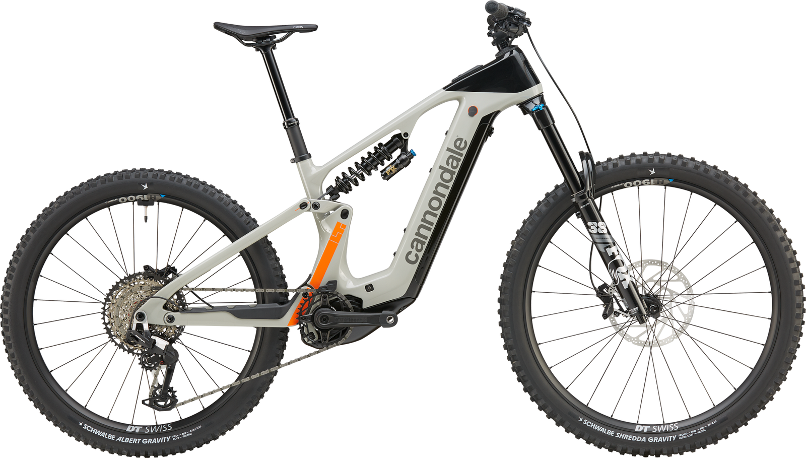

Cannondale Moterra LT 2026
From £6,500
EMTB Forums verdict
The Moterra LT is the longest-travel, hardest-hitting model in Cannondale's full-power Moterra range. This new generation moves to a full carbon frame that Cannondale says shaves a kilo off the previous Moterra Neo LT, pairs a 170mm Fox 38 Performance fork with a 165mm Fox DHX coil shock, and runs a dedicated mullet wheel setup. Power comes from the 120Nm Bosch Performance Line CX (Gen 5) with a removable 800Wh PowerTube, swappable down to a 600Wh pack or extendable to 1050Wh with a PowerMore range extender.
The single UK build, the LT 1 at £6,500, is sensibly chosen for enduro abuse rather than showroom appeal: mechanical SRAM Eagle 90/70 T-Type shifting, TRP EVO Pro four-piston brakes on 220/203mm rotors, DT Swiss H 1900 wheels and radial-casing Schwalbe Shredda/Albert tyres. That undercuts the shorter-travel Moterra 1 (£7,500) and the lightweight Moterra SL LAB71 (£11,000) in the same catalogue, although the shorter-travel 150mm Moterra 2 offers the same full carbon frame and Bosch CX/800Wh system for £6,000.
Geometry is properly enduro: 64.4 degree head angle, 77.5 degree effective seat angle, 425 to 510mm reach across four sizes, and Proportional Response size-specific kinematics with chainstays that grow from 445mm to 450mm on the bigger frames. There is no flip chip; the coil shock carries a two-position adjustment instead.
As a newly launched generation there is little owner history on this frame yet, so long-term reliability and ride impressions from the community are still to come.

LT 1
£6,500
MotorBosch Performance Line CX Gen 5 · 120 Nm
BatteryBosch PowerTube 800 · 800 Wh
Travel F/R170/165 mm
FrameFull carbon (Moterra LT Carbon, alloy skid plate)
ForkFox Float Performance 38, 170mm, Grip Damper 3Pos, 15x110mm Kabolt thru-axle, tapered steerer, 44mm offset
ShockFox DHX Performance, Coil, 2 pos adj, 230x65mm
HeadsetAcros ICR, 1.5" to 1.8", sealed bearings
StemCannondale 1, 6061 Alloy, 35.0, 40mm, 0°
HandlebarCannondale 3 riser, 6061 Alloy, 25mm rise, 8° sweep, 4° rise, 800mm
GripsCannondale TaperRidge
SaddleFizik Terra Ridon X5, 145mm, Wingflex, S-Alloy Mobius rail
SeatpostCannondale DownLow Dropper, internal routing, 34.9, 150mm (S), 170mm (M), 200mm (L), 230mm (XL)
BrakesTRP EVO Pro 4-piston hydraulic disc, 220/203mm rotors, 2.3mm thickness; TRP EVO Pro hydraulic disc levers
Rear derailleurSRAM Eagle 90, T-Type
Cranke*thirteen e*spec Helix Core, 55mm chainline, 160mm, 34T
ShiftersSRAM Eagle 90, T-Type, 12-speed
CassetteSRAM Eagle 70 T-Type, 10-52, 12-speed
ChainSRAM Eagle 70 T-Type, 12-speed
DrivetrainSRAM Eagle 90, T-Type; e*thirteen e*spec Helix Core, 55mm chainline, 160mm, 34T; SRAM Eagle 90, T-Type, 12-speed; SRAM Eagle 70 T-Type, 10-52, 12-speed; SRAM Eagle 70 T-Type, 12-speed
WheelsDT Swiss H 1900 Spline, 30mm inner width, TC (tubeless ready); DT Swiss Competition straight pull spokes; (F) DT Swiss 370, 15x110mm thru-axle / (R) DT Swiss 370 LN Ratchet System, 12x148mm thru-axle, 6-bolt hubs
Tyres(F) Schwalbe Shredda Front, 29x2.5", Radial casing, Addix Ultra Soft Foldable, tubeless ready / (R) Schwalbe Albert, 27.5x2.5", Radial casing, Addix Soft Foldable, tubeless ready
