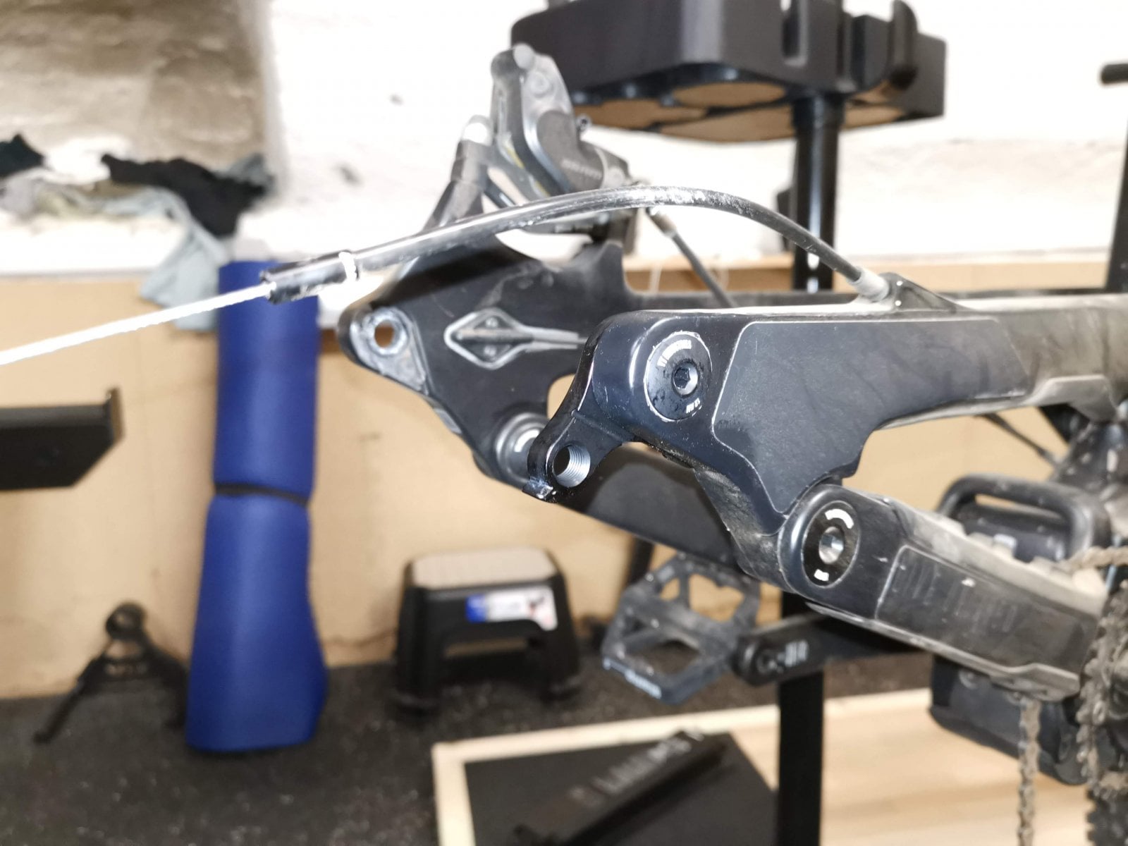

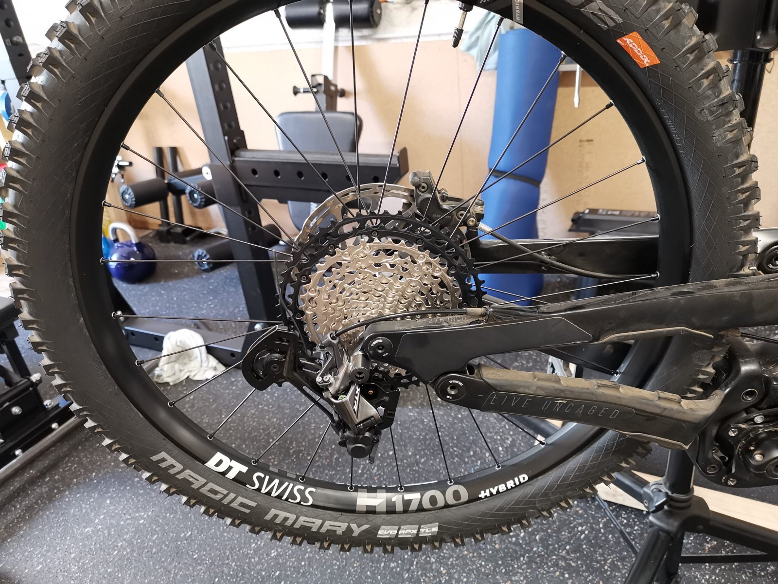

Sure?
I am trying it right now and it just looks wrong
The dérailleur stops before the 50T sprocket and won't go alle the way in. The stop screw is alle the way out......
Hasse I’m running a Levo that came with SRAM and I have a XTR setup now. It originally came with a 11-42 and now running 11-46 and no issues at all. Sometimes you need a longer stop screw and based on your 50t, I guess you are installing Eagle?

That's most likely the problem, try screwing it in until you can shift to the largest cog and then a bit more so the upper jockey wheel doesn't rub on the big cog
Thats the B.Screw - the stop screws prevent the chain from going to far in or out.

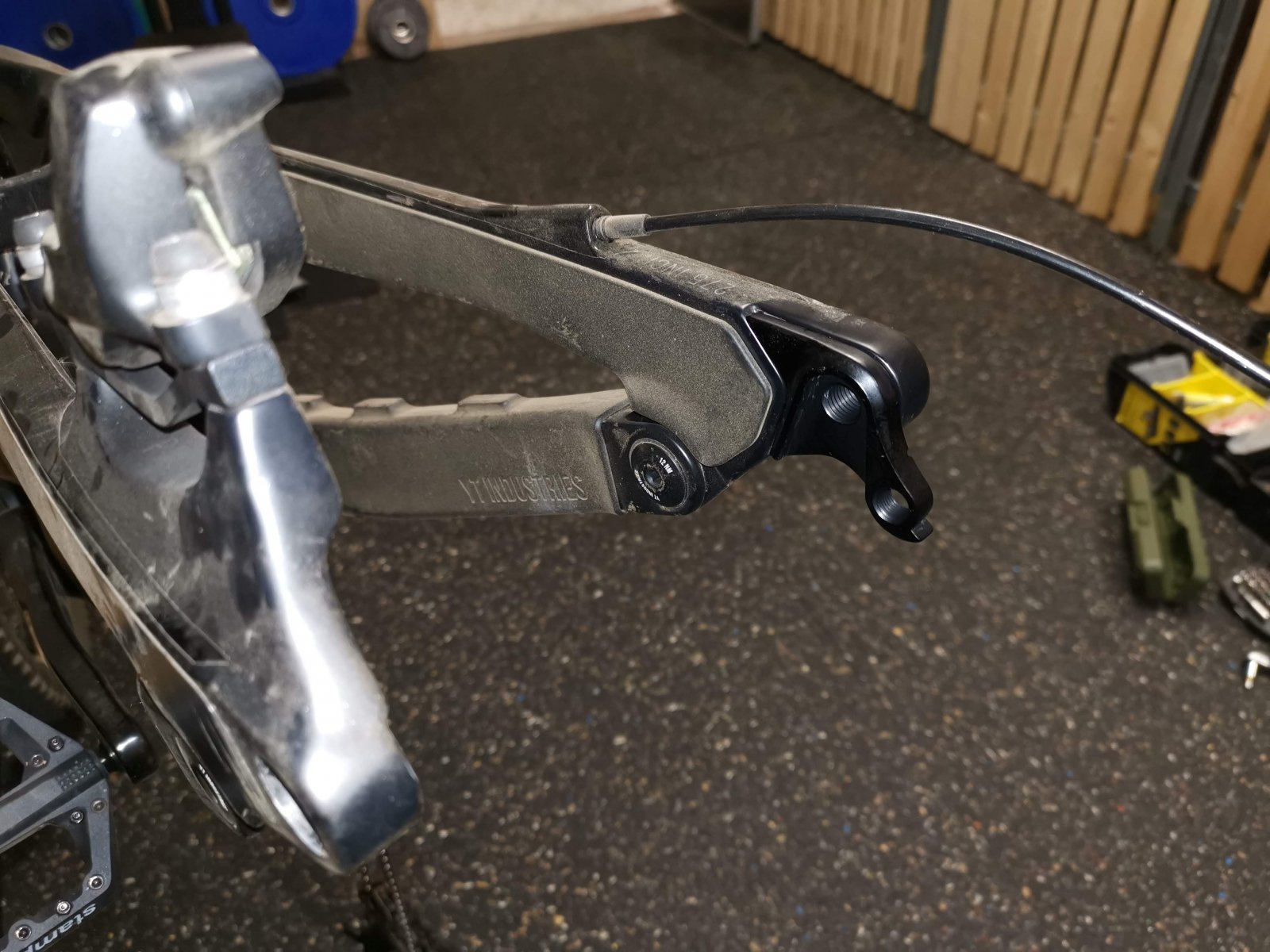

Found this: Standard Mount vs. Direct Mount Derailleur Hangers
So you can go from Sram to Shimano if you use a B-link but not the other way. Darn!

Yep, Direct mount does not fit SRAM. My Decoy and My wifes Canyon are both Direct Mount XT.
Glad someone spotted this.
NB: I edited this post after I looked at my Decoy.
That does sound like an adjustment issue not a compatibility issue. Have you got it on the hanger correctly ?

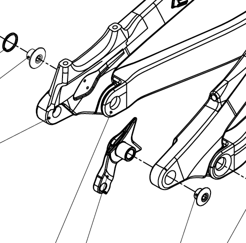

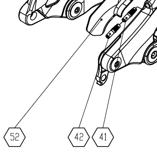

Apparently a Sram derailleur will not fit on a direct mount gear drop....
Quote: "Currently, SRAM does not offer any direct mount rear derailleurs, and always need to be mounted to a standard derailleur hanger. If your frame has a direct mount hanger, and you are switching from Shimano direct mount to SRAM, you will need to replace your hanger with a standard mount version of your hanger."
Its not in their parts catalog but it is in the explodet drawing for ordering parts...
Standart mount (top) - direct mount - Shimano (bottom)

Any idea which derailleur hanger fits the Decoy base with alloy swingarm? Ta
Got email answer from YT.
Same as the carbon rear end.
The Jeffsy 2019 Hanger.

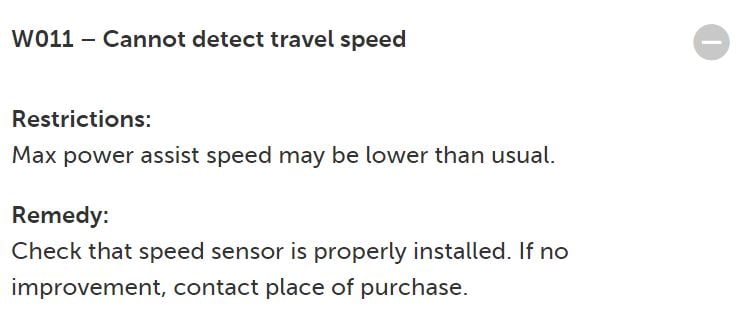

Hey guys. Just had error code w011 and can't make it go away. My decoy is essentially new so not sure what to do. Did you guys know how.to solve it?
hmm I got error code w011 a couple of times on the last rides and that indicates speed sensor but there is not much to adjust there,, anyone else had this?
Hey man. Just got the same issue. No speed reading out of the blue and motor cuts out.
How did you solve this?
I removed the speed sensor from the frame and cleaned it and have not had w011 since this (y)
