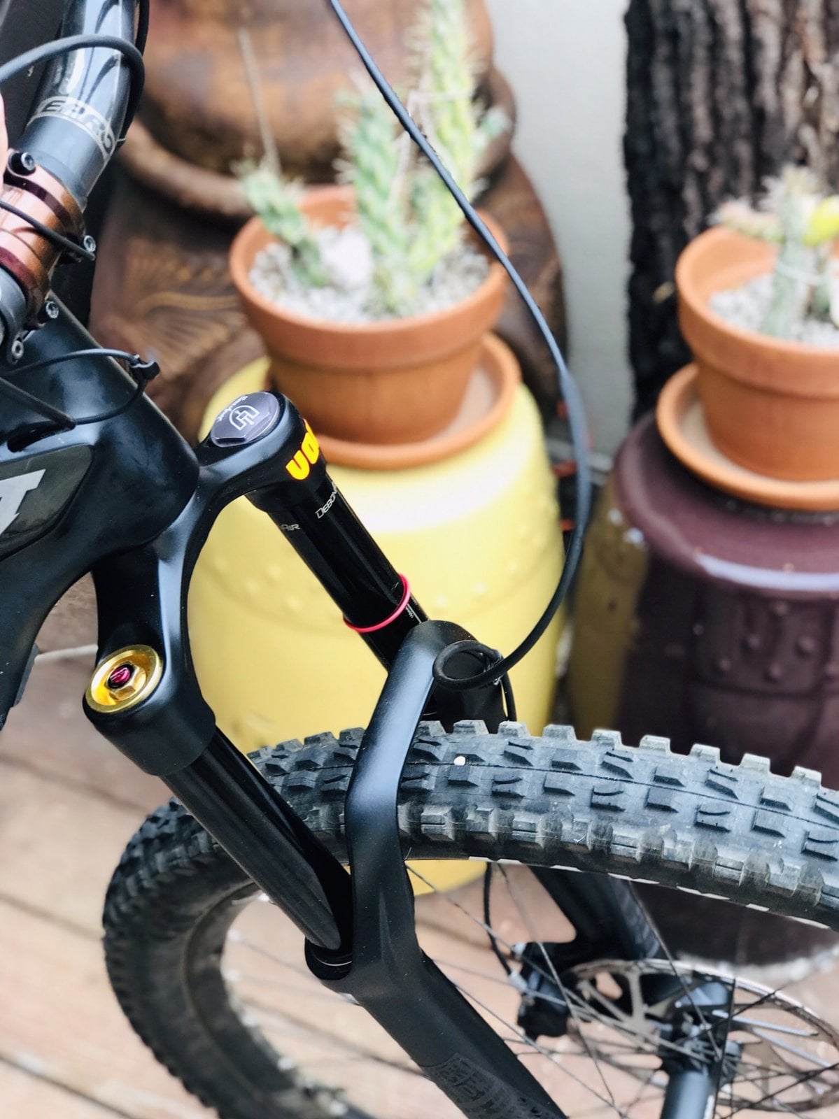

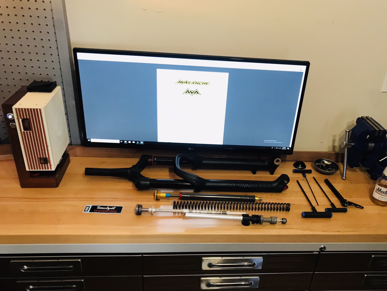

This is what I’m doing, already sent the bomber to avalanche. But I’m keeping the fork at 160 for now. Also fitting an avy damper and Vorsprung smashpot coil. I wasn’t worried about adding the weight to an already heavy bike, but now that I’ve ridden it I’m not so excited for two reasons. 1) the bike doesn’t feel all that poppy even with air suspension and 2) it’ll be over 55 pounds even after I swap in a carbon wheel set and handle bar. I should have it fully coiled by next weekend. I’ll let you know how it goes.
Wow man that sounds sweet(avy carts and smashpot in particular). I’d be tempted to go 180 smashpot. I wasn’t super enthused with flex on my lyric rc when I had it at 180 though, so there’s that. I was happy with the cheap RV cart but always felt it could use a luftkappe for a little more small bump compliance. Seemed a fair portion of the flex came from the steerer so I’ll be considering one of these “intend bc” headsets.

Smashpot it over 400 grams heavier than debonair, I think the avy cart is about 100g heavier than the moco, and the bomber is at least 500g heavier than the delux. The carbon wheel set I’m building should be a little less than 500g lighter than stock. So yea it’ll end up just over 54 lbs with pedals.

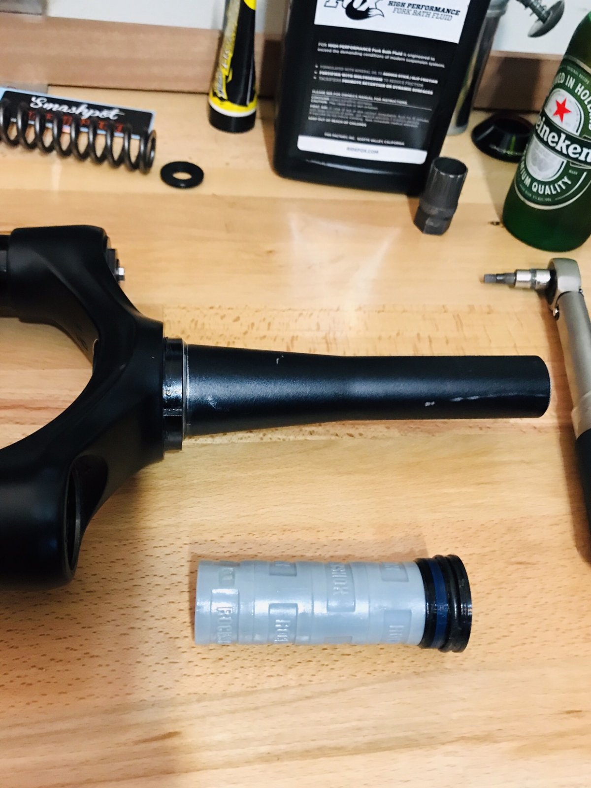

@IATR guess again: there are 4 volume spacers stock in the yari! That’s what the e-sticker on the crown indicates.
I’ve ridden a good variety of trails including some chunky stuff with big drops and have been super impressed with the stock suspension on the base model. I think most people would be happy with it actually. And like I said before I’ve hated every other yari I’ve tried.
That’s nuts. I’ve ridden a Yari with 3 and 4 before, it felt like it ramped up much quicker than what’s on the Base. :)
I know, right? Never would have tried 4 spacers in a long travel fork. I guess it adds some support to run the moco more open.
