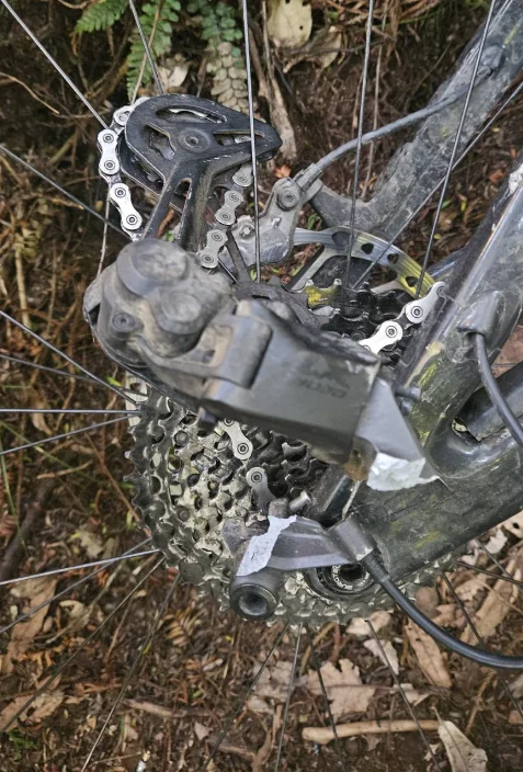

So far it's killed the Pinion MGU, let's see how long the cassette/derailleur manufacturers can stay alive. There will always be a place for derailleurs in the future, but a much smaller one?
What have you heard ?
In answer to the question, I doubt it. Transmission is a very good product IME. The price will also continue to drop over time. I think that CVTs/Virtual gearboxes will struggle to come close in terms of responsiveness. They'll be great for urban bikes etc, but not for mountain bikes IMO.
