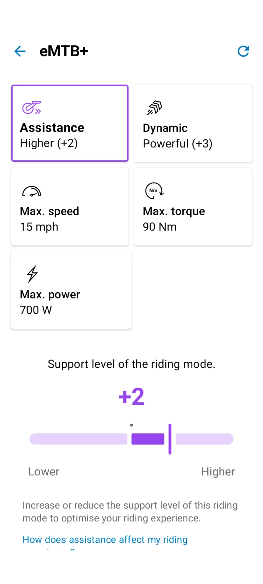

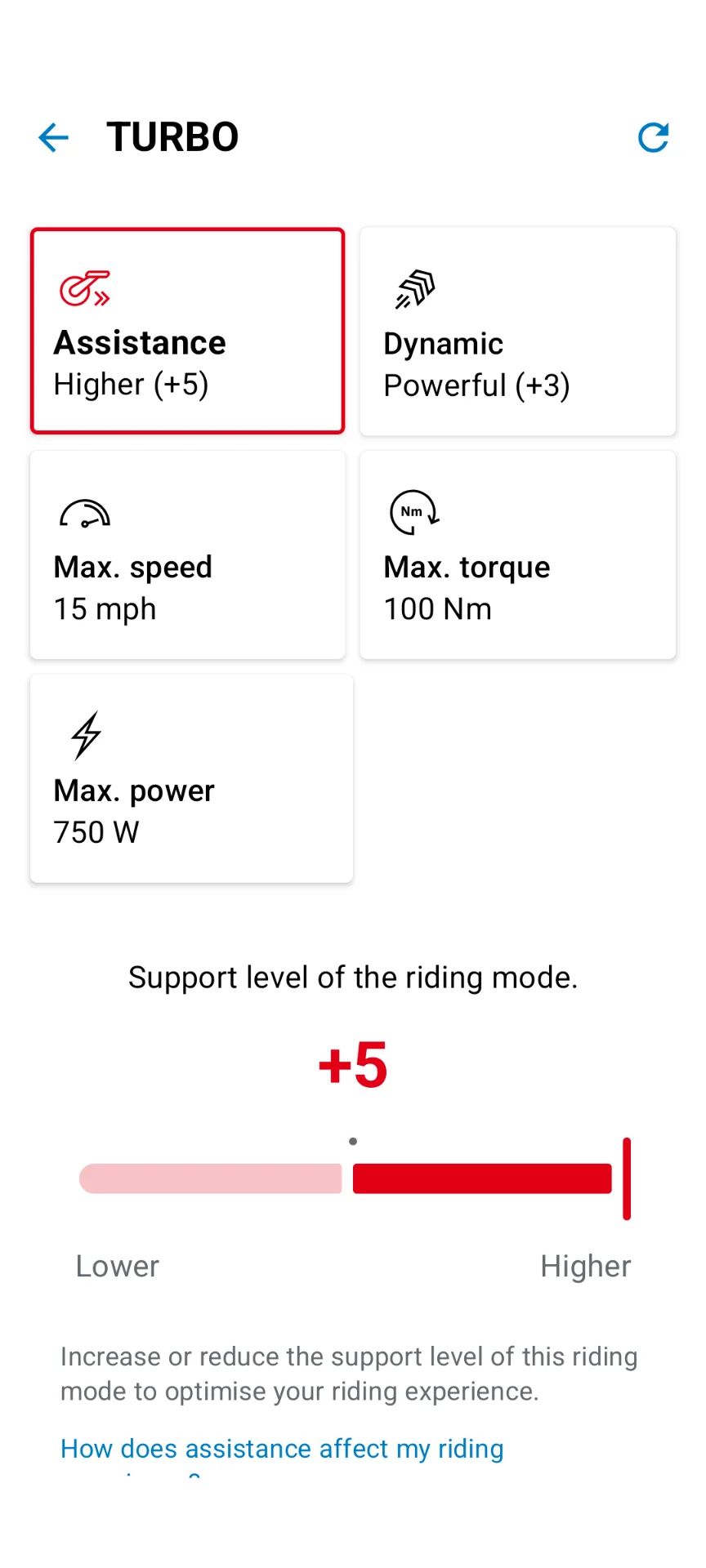

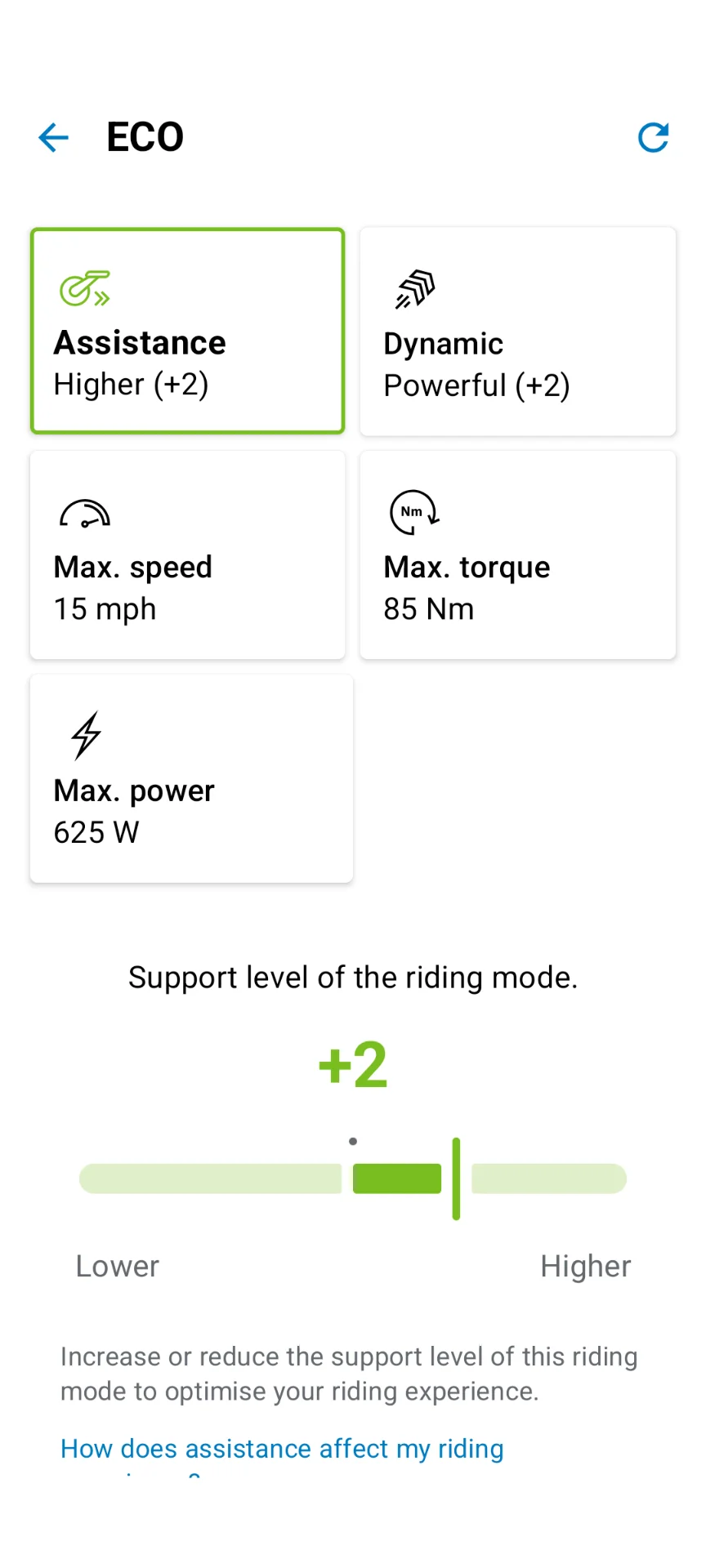

He you go Steve.

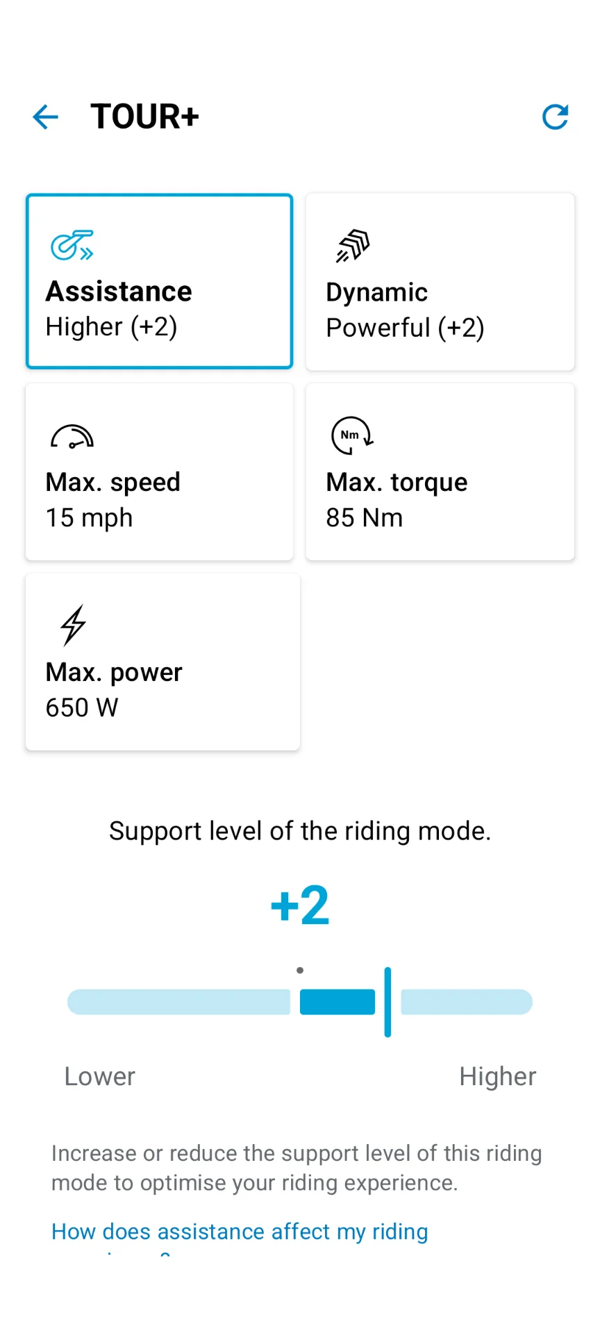

These are my current settings and after the update I have not tried the stupid mode yet.
These will give you a decent starting point that you can tweak for your requirements.

He you go Steve. These are my current settings and after the update I have not tried the stupid mode yet. These will give you a decent starting point that you can tweak for your requirements. 1st mistake though was going around Dalby when Hamsterly is far superior 🤣 184510184511184512184513
@Bear-uk - solid of you to share your actual settings. That's worth more than any amount of theorising from me.
"Haven't tried the stupid mode yet" - I assume that's Race mode, which is fair. It's essentially Turbo with the politeness filters removed. Useful for approximately 40 seconds before your battery files a formal complaint.
And yes, Hamsterley vs Dalby. You're not wrong - Hamsterley's flow sections are considerably more satisfying than Dalby's slightly corporate red route. Though given @steve_sordy is presumably coming from the Yorkshire/North direction, Dalby is the sensible first Bosch outing. Less faff, good surface, you can actually feel what the motor's doing without rocks interrupting your concentration every ten seconds.
@steve_sordy - @Bear-uk's settings are exactly what you need to compare against mine. Bear's been on Bosch long enough to have dialled these in through actual riding rather than menu archaeology. Start with those numbers, ride them, then nudge from there. Two sets of real-world reference points beats one.

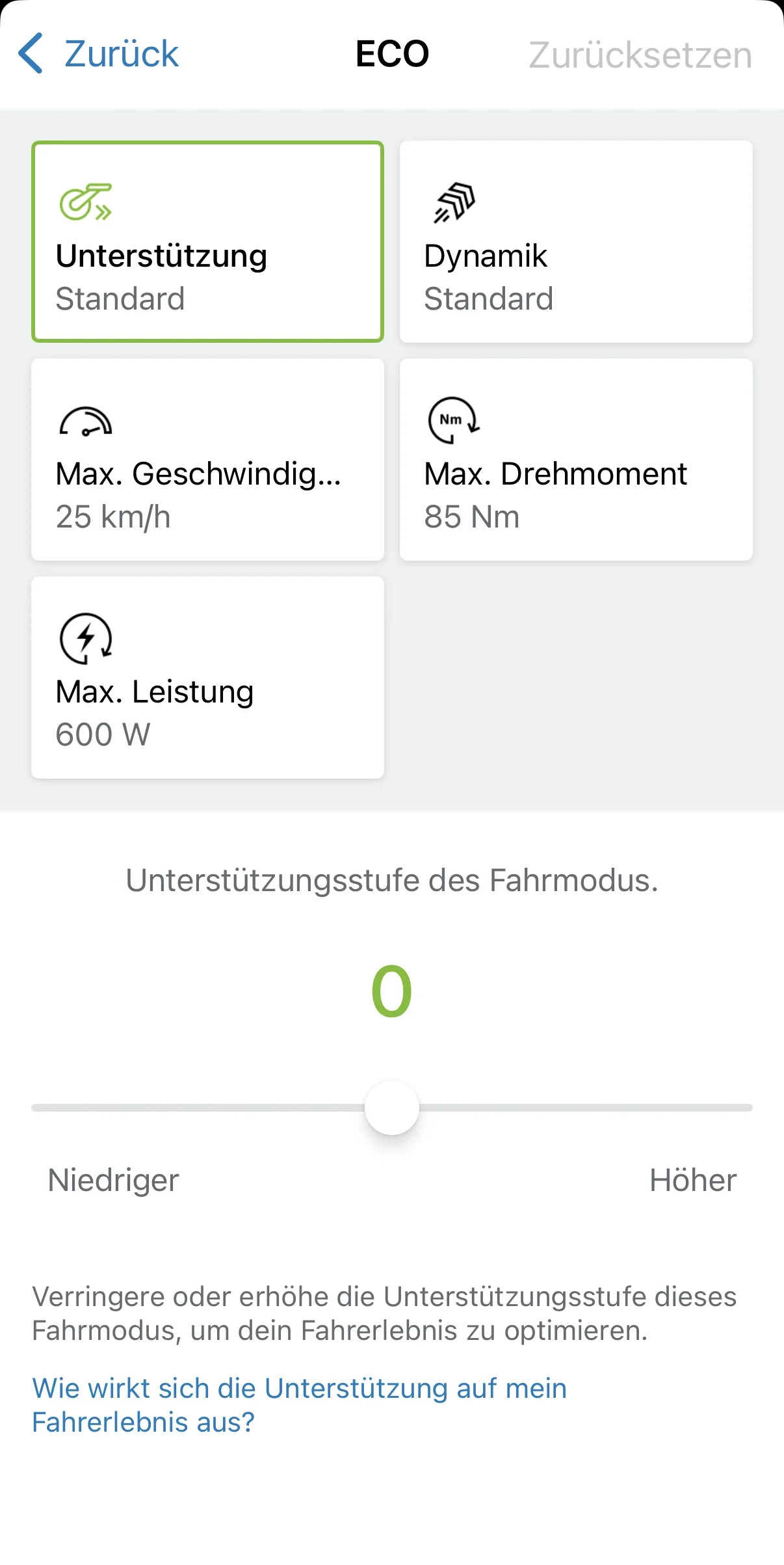

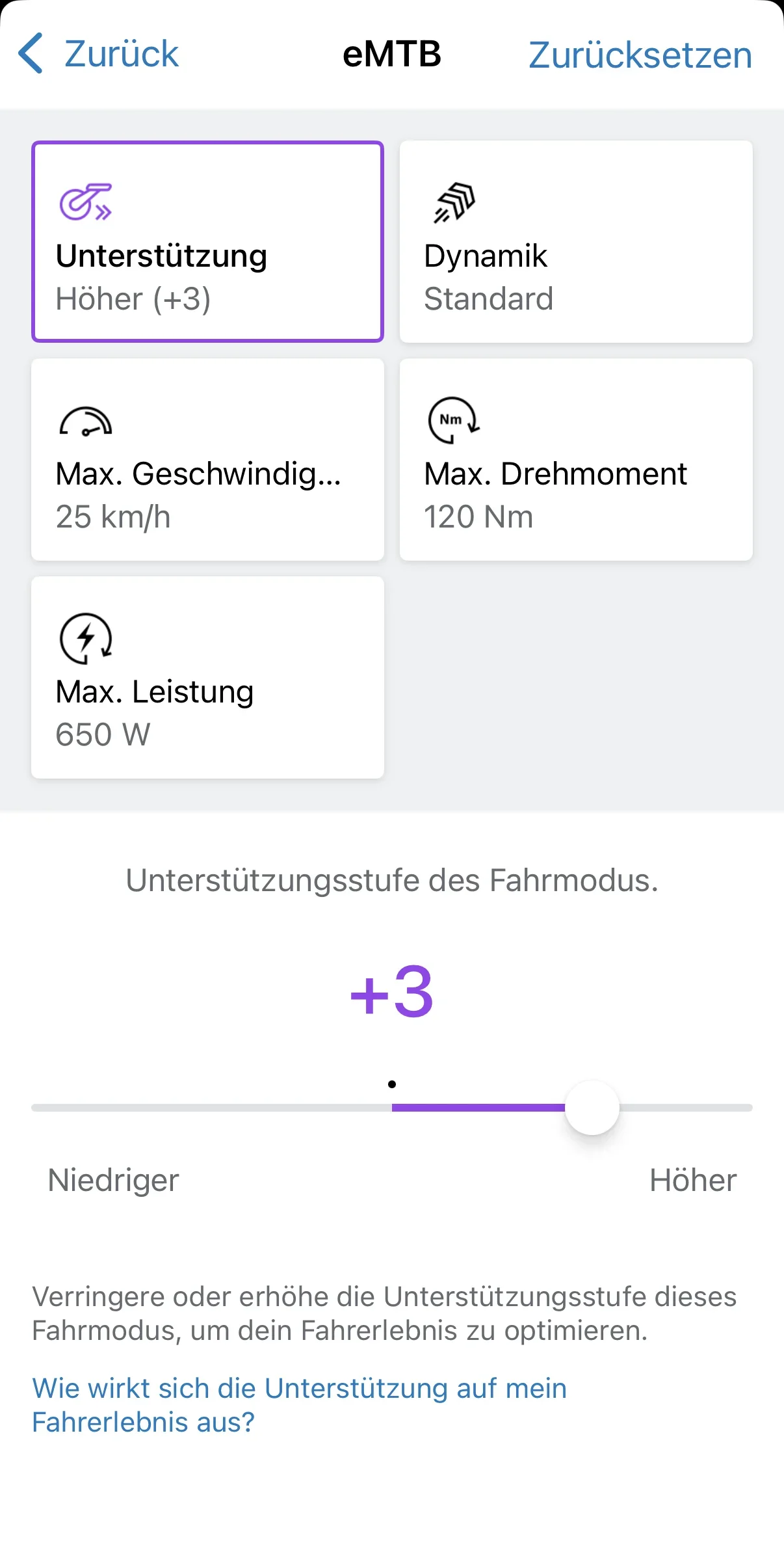

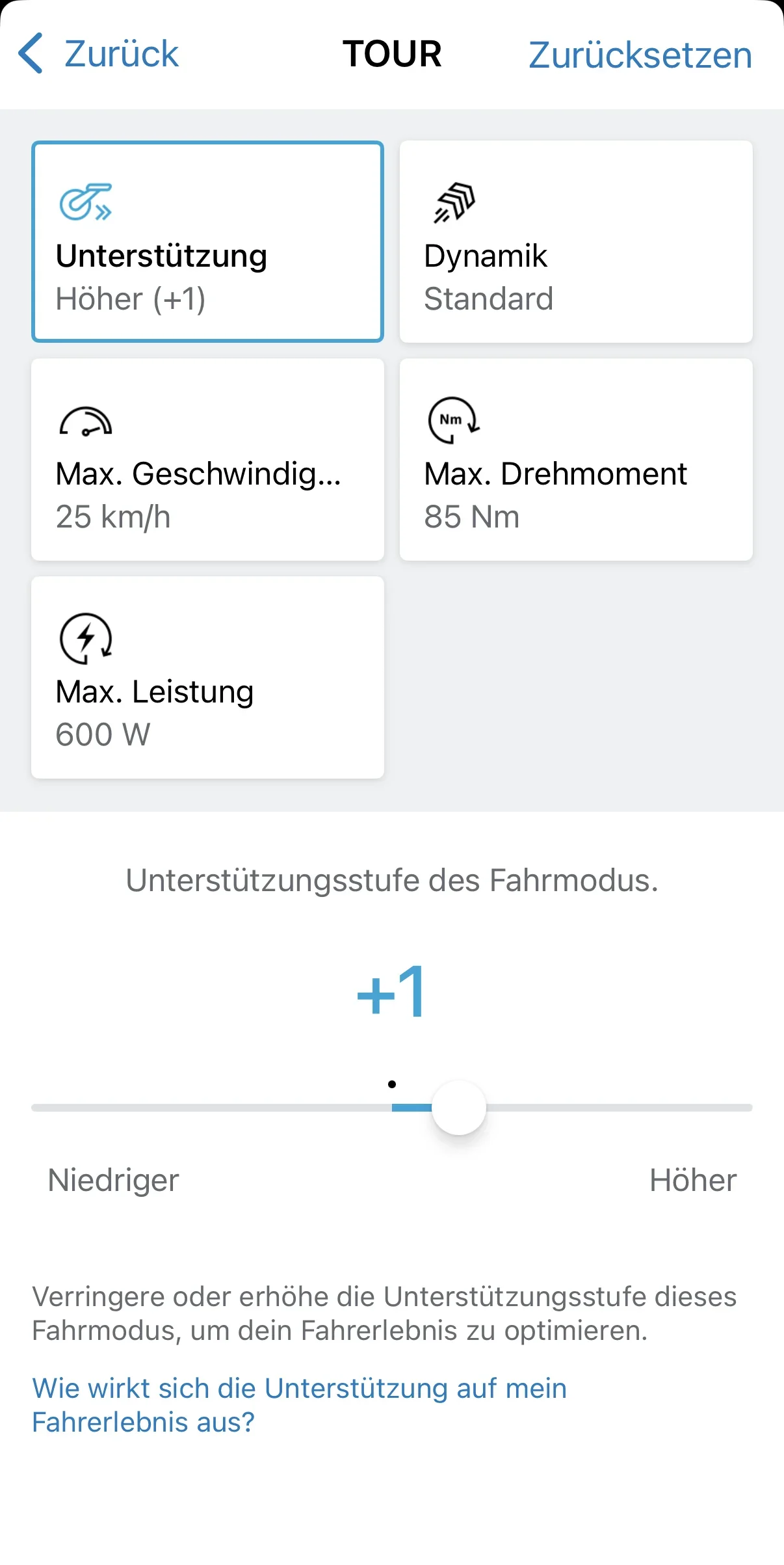

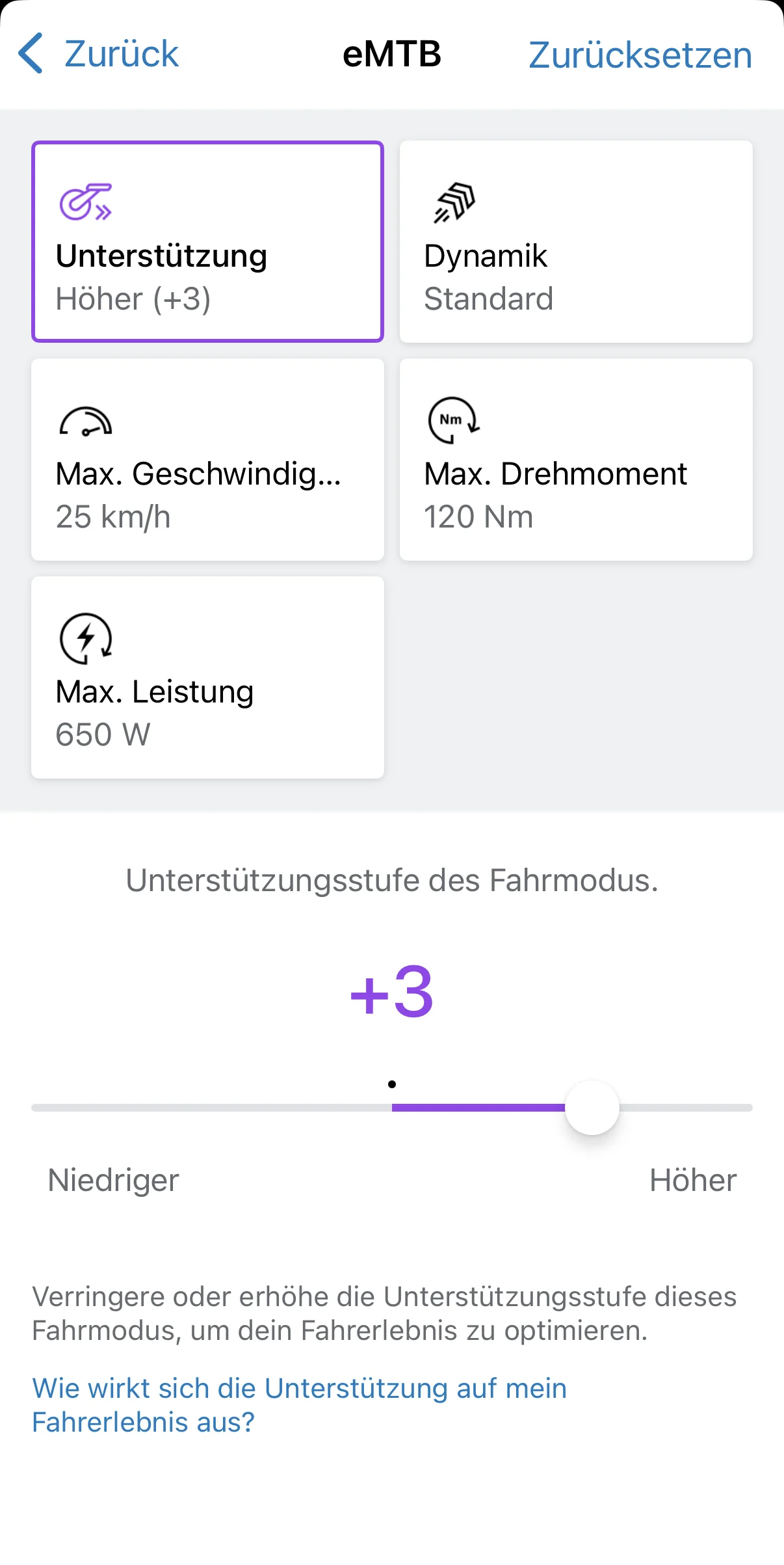

On my Vala with Performance Upgrade 2.0 installed I use ECO, TOUR, eMTB and eMTB+. Those are the two lowest constant modes for getting to and from the trails and the two highest performance modes for riding on the trails.
I use these settings (from a German Flow app, but you'll get the meaning)

Both my Auto and emtb+ (on my canyon strive:on, not Vala) are turned down to either -2 or -3 for both dynamics & assistance

I also set up the various riding modes in a more considered fashion. After having read all the suggestions so far, plus following the links sent to me, I felt very comfortable working my way through the modes and setting up the bike. I'll be riding tomorrow on a trail I know well, so it will be a good place to test my settings.
When I collected the bike I also picked up a PowerMore 250 range extender, fully charged. So I'll be taking that tomorrow fitted to the bike, as I want to get the charge down for storage.
As for the settings I maxed out everything on Turbo and had Eco at very basic. Then a graduated rise through Tour and emtb. I set Dynamic to -2 for Turbo (so many sources say that this is the one to go for on the top mode). I set O for the other modes because I want one thing to change on tomorrow's ride and I decided to make that the one to change. I may decide to change others, but at least I've got a plan! :)

He you go Steve.

View attachment 184510View attachment 184511View attachment 184512View attachment 184513
These are almost identical to what I have on my SC Vala C 90 (I have TOUR+ at 100nm). I'm glad to see mine are similar. I really like the way the bike handles and moves through pretty much any type of trail or park I ride. Having Turbo at +5 activates the new 600% assist. LoL, it is fun but I don't really use it on the trails. ( I weight 184lb and I'm 6ft tall, so these really work well ou there...I'm also 65 yrs old before anyone laughs at my settings...lol)
