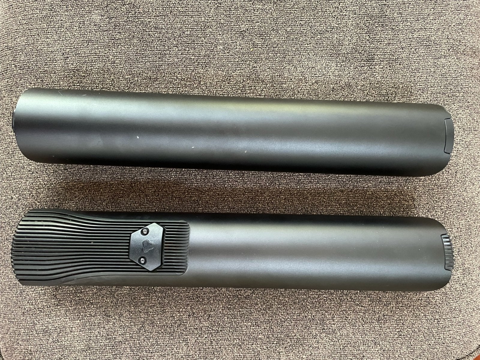

I have a dummy downtube for my bike. I'm assuming that will be affective for keeping the contacts covered.

Funny you should bring up hot and cold.
The owner's manual for my bike suggests putting the dummy tube in when transporting on a bike rack to avoid heat damage to the battery during transport.
