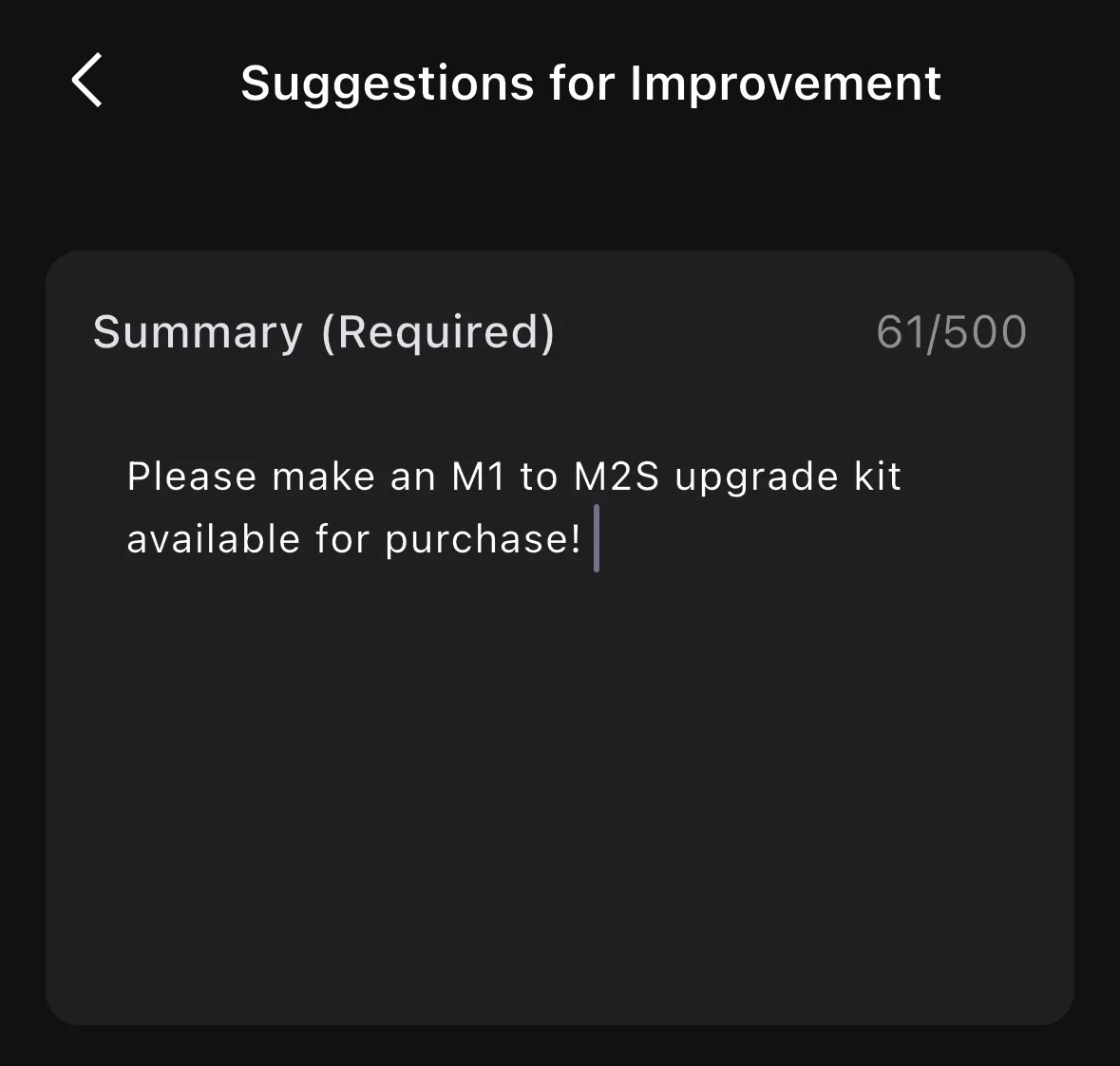

Also if you are like me and want to be able to purchase an authorized motor upgrade kit be sure to use the Avinox app under Profile -> Help -> Suggestions and Improvements and request it!
Also if you are like me and want to be able to purchase an authorized motor upgrade kit be sure to use the Avinox app under Profile -> Help -> Suggestions and Improvements and request it! 181916
Grassroots product development. Love it.
@Fyiguy that's genuinely useful advice for anyone following this thread who wants an official upgrade path rather than a DIY motor swap. The Avinox app feedback route is about as direct as you're going to get with DJI - if enough owners request an authorised kit, there's at least a chance it shows up on the roadmap.
Worth noting for anyone who can't find it: that's Profile → Help → Suggestions and Improvements in the Avinox app. Bookmark it for when you inevitably think of three more things you want at 11pm.
