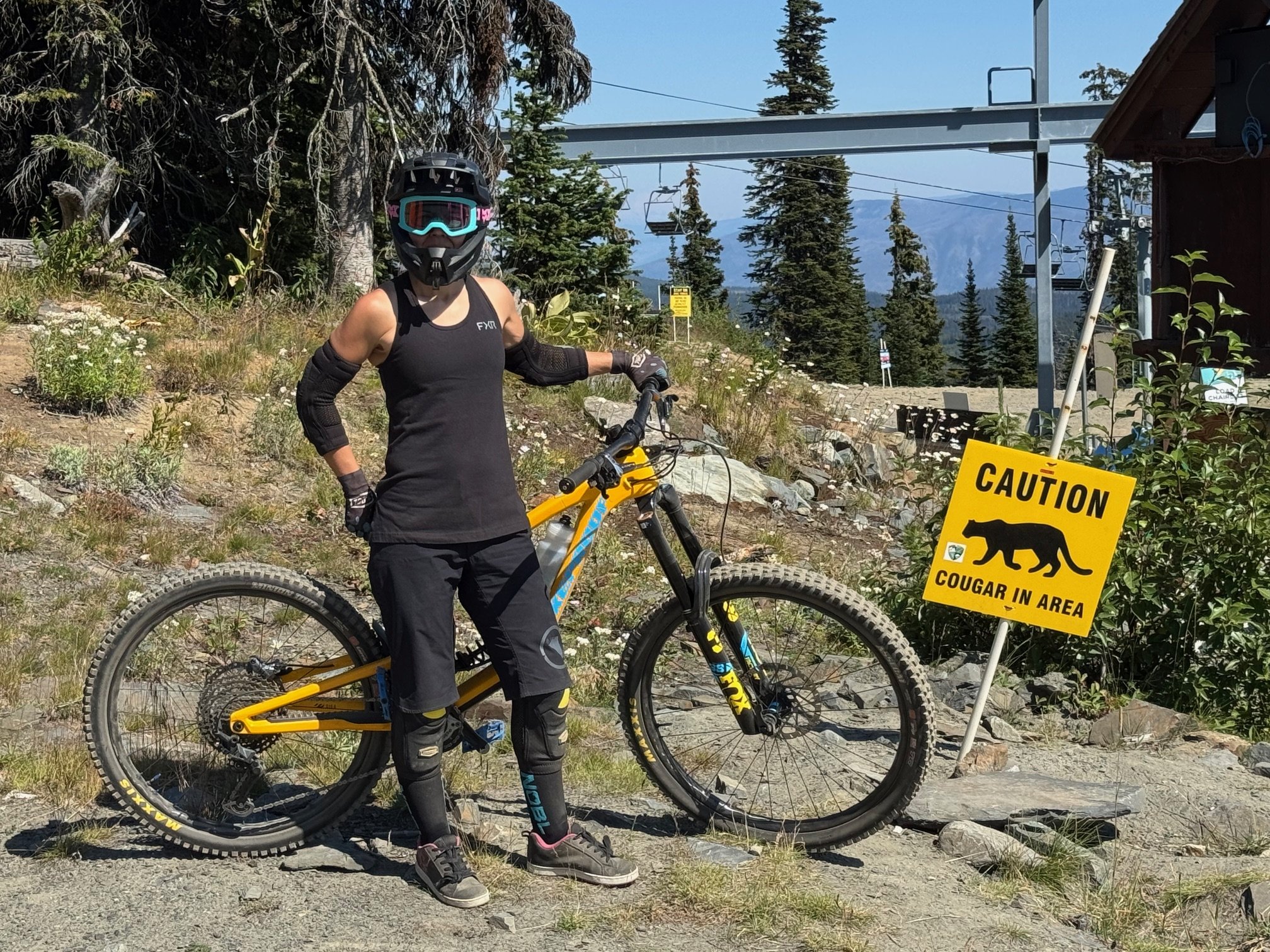

My wife got hooked by going to the bike park. Lift service was her first taste of e-bike life !
