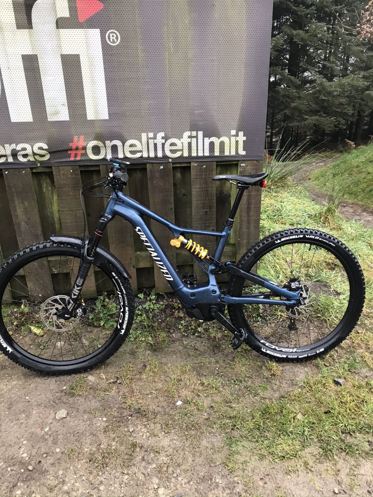

I am also curious about putting coil shock on. Rear also as I have basic Turbo Levo and front and rear shocks sounds like a washing machine. I live in Colorado so ride alot of rocky terrain. Thinking of putting a coil shock on rear and looking for suggestions or anyone selling a good used in the US. And then maybe coil on front or just upgrade to a Lyric Ultimate

Ibisacura I recently upgraded the suspension on my 2020 Levo comp. I decided to upgrade the existing Lyrik Select fork to the Lyrik Ultimate spec with HSC/LSC and 160mm travel. It was a bit less than 1/2 the cost of a new Ultimate fork (including shop setup)...just not as sexy. The guys at the local suspension shop recommended Ohlins or Cane Creek coils on the rear. I went with the Cane Creek DB Coil CS because it was more reasonably priced. All in all a reasonably priced upgrade that has made an enormous difference to the feel of my bike. BTW.... My riding style is fast single track/sketchy downhill stuff with some air. I’m too old to scare myself on big jumps which is why I didn’t throw huge sums on all dancing, big hitting suspension.

I have the base 2020 levo and put 160 lyric ultimates on with the ohlins rear, the difference is incredible.

Personally I would not run a coil on the Levo. The shock is a structural member so you lose a lot of stiffness plus there are a lot of failures of the shafts breaking. It is bad enough that Fox has put out a memo that the DHX2 should not be used and will not be warrantied when used in conjunction with the Levo/Kenevo. Even the coils with larger shafts have issues with leaking etc.
The final issue is that the leverage ratio is pretty flat so you will bottom a lot with any sort of aggressive riding unless you over spring then you lose the advantages of a coil
A much better option is to upgrade with a Fox X2 air or similar air setup. Any piggyback air shock will be an upgrade compared to what comes stock. The standard setups get overwhelmed very quickly and start spiking even on mellow runs.
The only caveat to this is coil shocks like the EXT that have a hydraulic bottom out mechanism.
