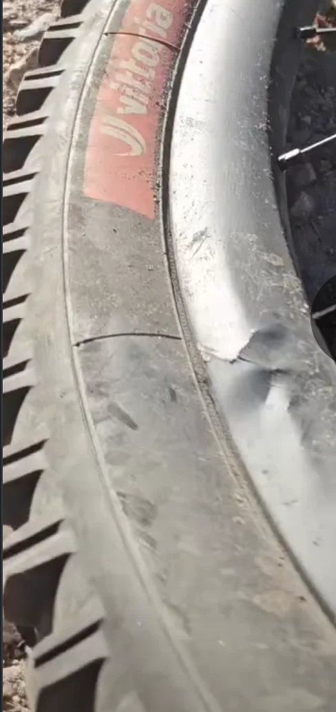

I joined the Amflow facebook group. Haven't heard of failed rims yet. Have seen a couple of rim impacts that cracked the rim. But every one you could see the tyre was damaged as well. So clearly an under-inflation issue, and why I run the Tannus Armour Liners, so I can run lower pressures, without risk of rim damage.

The stock aluminum hoops are too soft. Second ride a root dented the rear wheel on a root strike that never affects my others 4 bikes. 29psi, going 8mph (I have video.). Warranty denied. Switched out with Hunt Proven Enduros and no issues since.
I've dented RaceFace Alloy DH rims. And they are tough rims. That's why I started running Armoured Liners. Never dented a rim again. Never got a puncture again.
I can now run lighter alloy rims with the Armoured Liners, and still no issues. I'm running the lighter alloys on the Teewing, rather than carbon.
