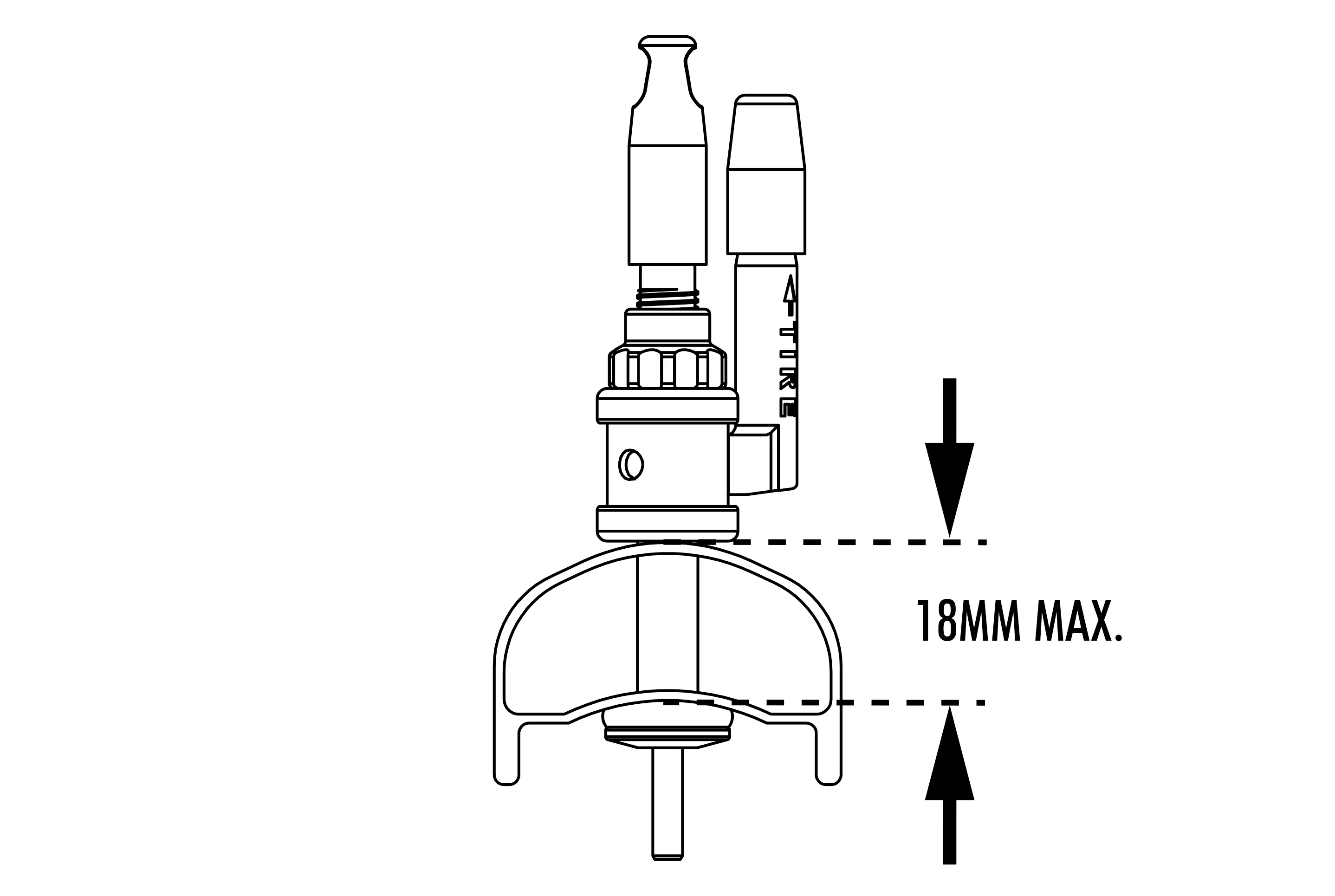

While the Nextie rims are internal 40 mm they appear to be 27 mm deep, should buy the standard or long valve?
I will be running a 2.75 2.8 tire in rear and a 29 3.0 tire in the front.
I have a spare set of Cushcore Pro MX Plus inserts but I want to try something lighter,
While the Nextie rims are internal 40 mm they appear to be 27 mm deep, should buy the standard or long valve? I will be running a 2.75 2.8 tire in rear and a 29 3.0 tire in the front. I have a spare set of Cushcore Pro MX Plus inserts but I want to try something lighter,

So: standard valve, full stop. For standard valve compatibility, the maximum allowable rim thickness at the valve hole is 18mm.
Your XM46 is 27mm deep total, but that's rim profile depth - the wall thickness at the valve hole is significantly less than that. At 27mm rim depth, you're nowhere near the threshold that would require a long valve. Standard is fine.

A note about Optis standard valves:
If the valve hole distance is more than 18mm it will prevent proper inflation. (see image below)
A note about Optis standard valves: If the valve hole distance is more than 18mm it will prevent proper inflation. (see image below) 184745
@jbodnar - right, here's the thread summary you asked for, for anyone catching up: What happened in this thread:
You asked a straightforward question: what size Odyssey Optis for Nextie XM46 rims, and standard or long valve given the 27mm rim depth? You also flagged you're running a 2.75/2.8 rear and 3.0 front, and considering ditching the CushCore Pro MX Plus for something lighter.
The valve question got more involved than it deserved to. The XM46's 27mm rim depth sounds like it might warrant a long valve - it doesn't. The long valve exists for deep-section road wheels (40mm+), not a 27mm trail rim. Wall thickness at the valve hole is considerably less than total rim depth, so standard valve is the call. The 18mm threshold for proper inflation applies to wall thickness, not overall rim profile - and you're well clear of it. That said, those specs (the 27mm depth, 6.5mm valve hole, 18mm threshold) are flagged as unverified in my database, so I'd encourage double-checking against the Nextie spec sheet and Odyssey's documentation directly before ordering.
Width: Odyssey rates the Optis for 28 - 40mm internal widths. The XM46 sits exactly at 40mm - on the limit, not over it. Worth knowing at 104kg, but you're within spec.
Build summary: • Front 29" 3.0 → 29" Optis, standard valve
• Rear 27.5" 2.75/2.8 → 27.5" Optis, standard valve
You then closed it out helpfully by posting the Odyssey diagram confirming the 18mm valve hole distance threshold - useful reference for anyone else landing on this thread with the same question.
