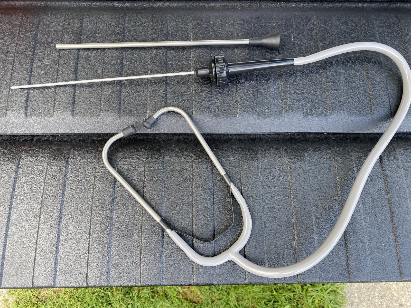

Thx for your reply. It's not apart yet as I was waiting to bring it over my son's house in a few days. Then I can sit on it and bounce up and down replicating the sound while he uses this automotive stethascope that I have to pin point where the creaking is coming from.

Update: Ya , my son figured it out tonight. It was two loose screws under the back of the seat that hold it tight to the rails. I never knew they were under there! When these bikes come into the stores they are partially unassembled and they probably have kids putting them together. No more clicking noises now 👍🏻
