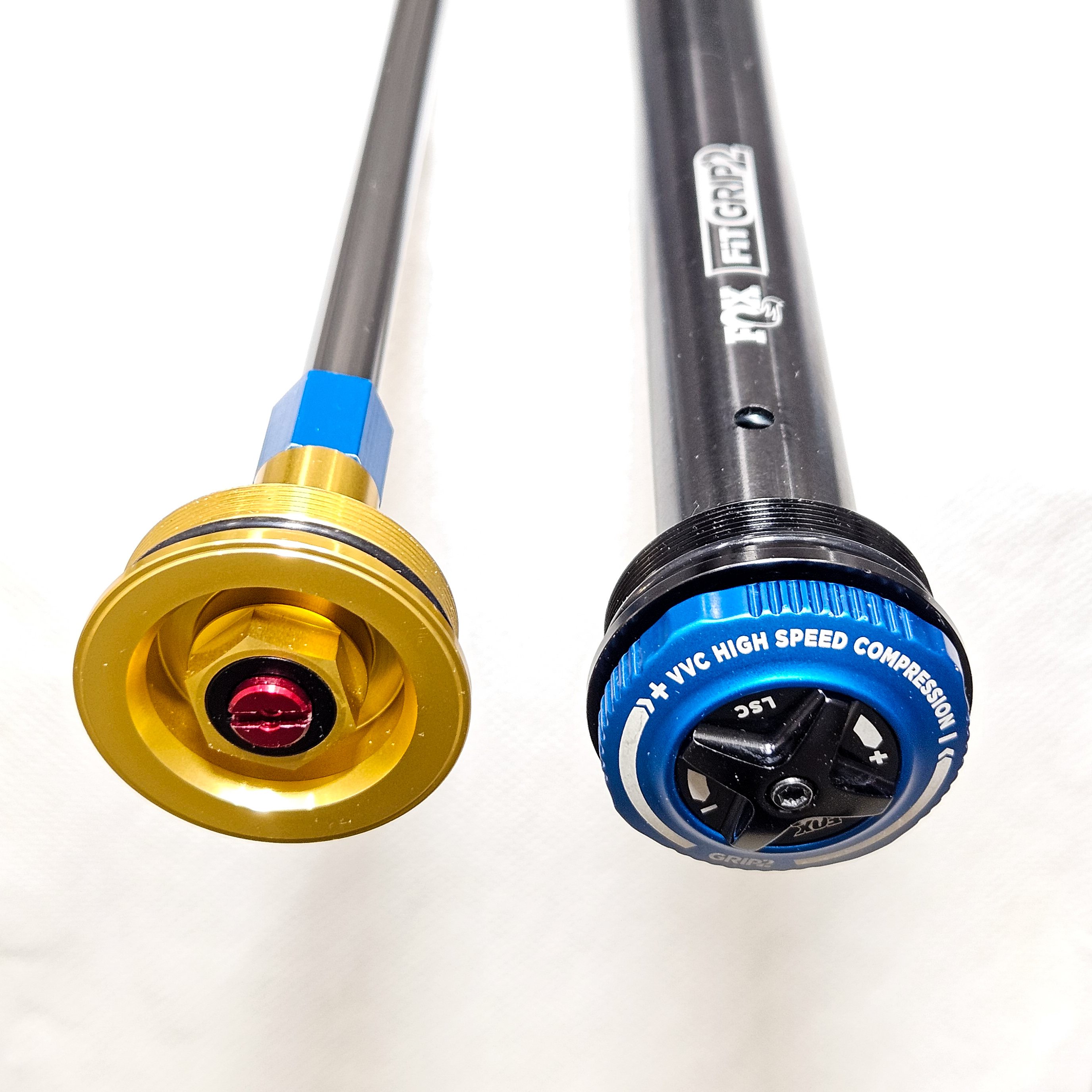

Avalanche open bath cartridge
+ Smashpot coil conversion
+ SKF dual compound seals
+ 330 ml of oil
= Ultimate suspension setup
AVALANCHE vs. FOX Grip2
