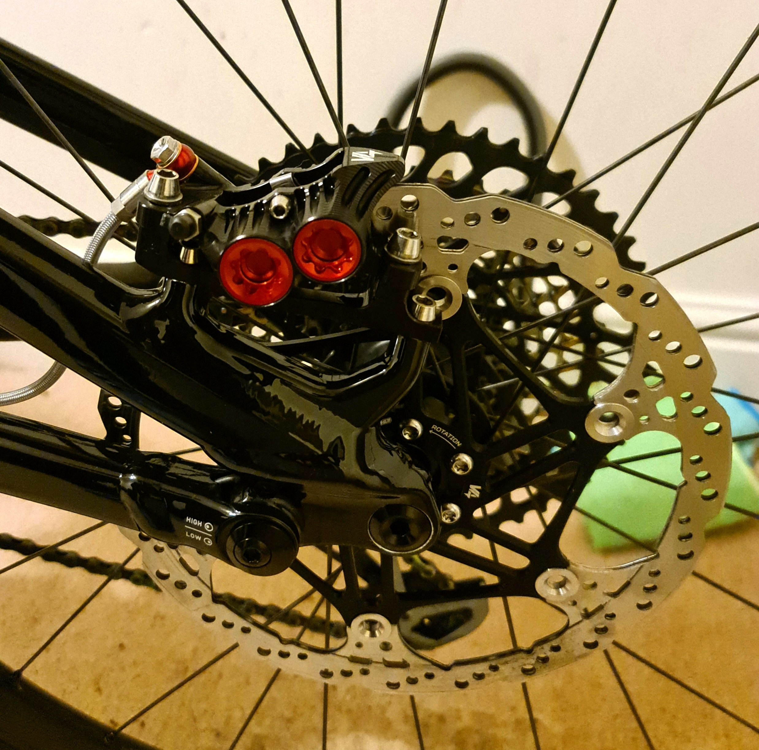

V4 floating 220mm front and back.
Not had any issues with heat and perform really well in wet muddy conditions.
